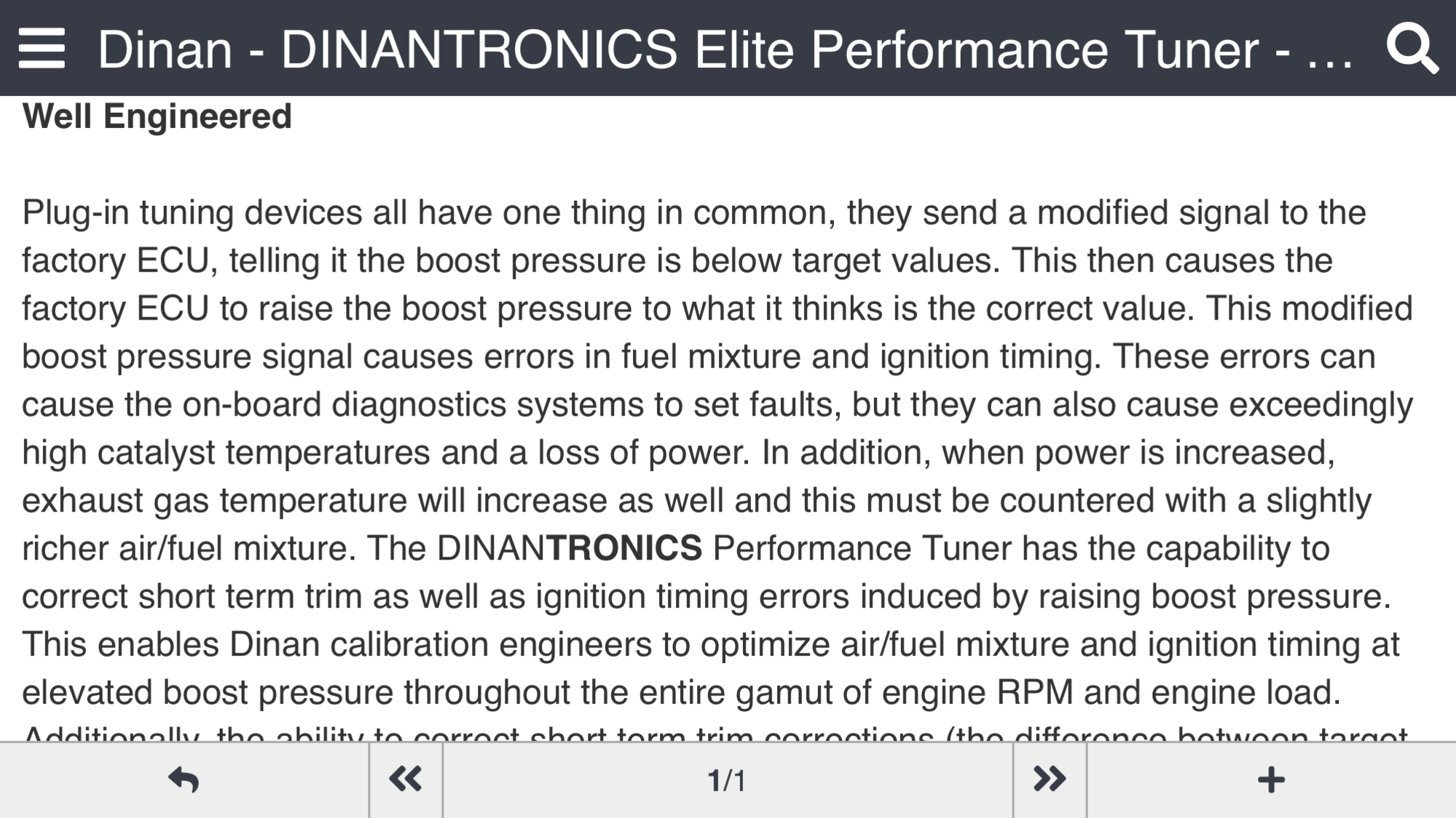

Originally Posted by cyberorth
they can see different values like boost pressure reaching amounts beyond what factory ecu allows.
Not true. See statement below. They modified the signa.

Old Aug 14, 2019 | 08:49 AM
///Bruce's Avatar
Joined: Aug 2012
Posts: 1,218
Likes: 315
From: Pearland, Tx
2020 AMG GTC Coupe & 2018 Macan Turbo
Yeah. Maybe true on Steve's product. Maybe. But I thought this thread was discussing items like Racechip, Kleeman and similar products. I stand by my earlier statements. IF your car throws a serious fault or something breaks and it's taken into the shop, there's a good chance a savvy young tech is going to see parameters out of range. It will be pretty obvious you had a P&P box in there. This in turn MIGHT cause the dealership to deny fixing any issue under the factory warranty.
And...once it's noted in the database at Dealership #1, it will be in all other dealerships too (this is subjective) and no other dealership will touch it either.

Old Aug 14, 2019 | 10:48 AM
AlexZTuned's Avatar
Joined: Dec 2012
Posts: 1,537
Likes: 372
From: Austin, TX
2017 Porsche 911 C4
You're not going to run into any major significant issues with just a stage 1 tune. So unless you throw a rod through the block, blow a turbo, or have some catastrophic failure, MB is not going to be digging through your ECU trying to find values outside their parameters. I've had literally 0 issues since installing my Dinan tune and don't feel like the engine is ever stressed.
Also, the whole point of a piggyback is that it intercepts the sensor signals to trick the stock ECU into thinking it's running normal boost. As far as the ECU knows, everything is still within stock parameters. However, once you flash the ECU then you are literally changing the ECU parameters and it will be clear as day that you had a tune.
