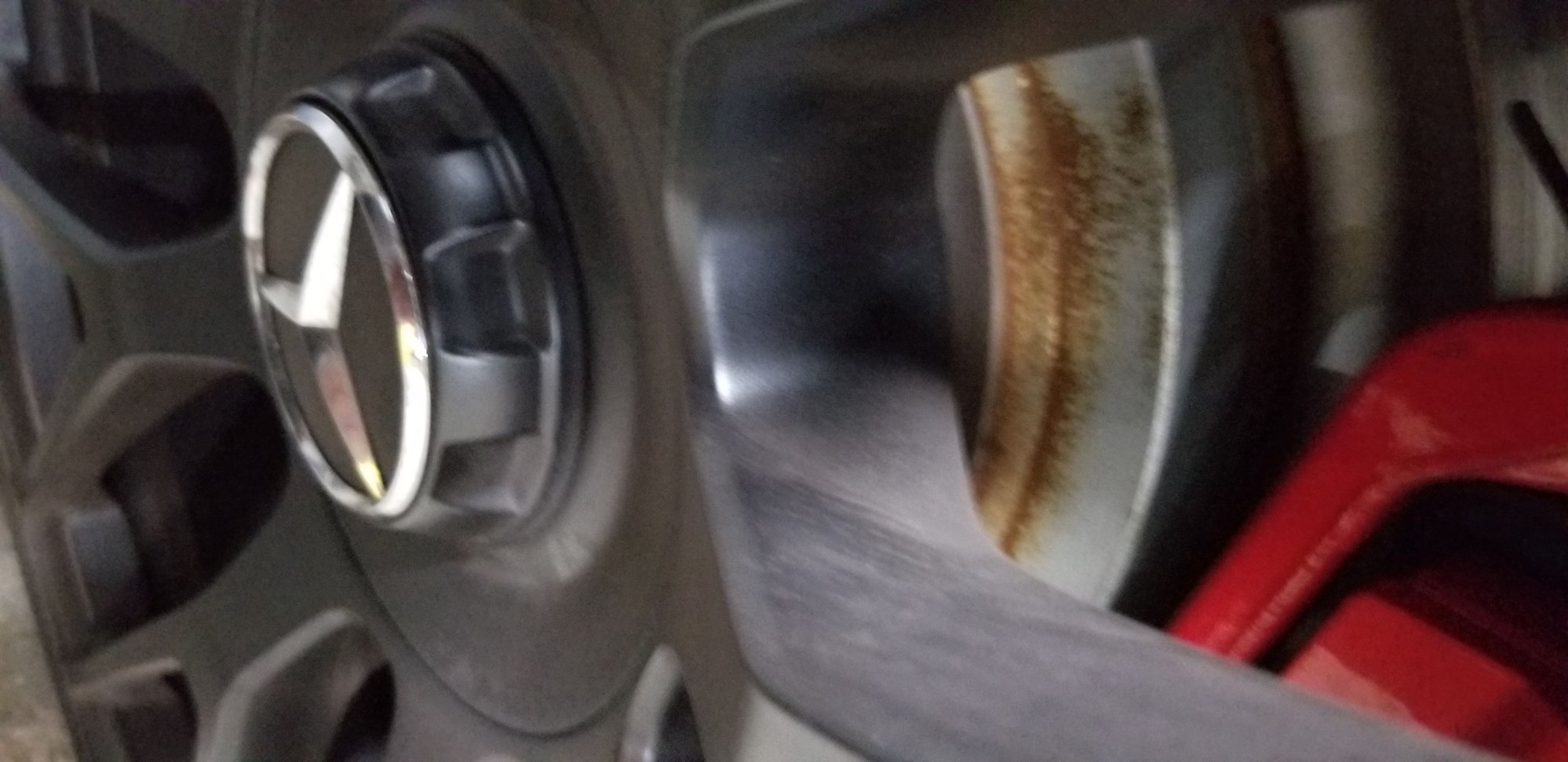

I'm get rust on rear disc. Have 3,300 miles on c63s
Advise what to do?
Advise what to do?
Where? On the surface of the rotor? If you're getting rust there, go for a drive and stomp on the brakes a few times. Friction will remove the surface rust. These rotors will rust immediately after a car wash or after being parked out in the rain. Completely normal.
Is the rust normal or how can I remove it. Rear.2019 C63S coupe . Thanks
So it's not on the face of the rotor itself. From that photo and angle, it looks like it is on the hat.
There's a sealant made by Wurth called SBS Brake Treatment. Supposedly works wonders on this type of benign surface rust and is safe/fine for the surface of the rotor if some gets on there.
https://www.wurthusa.com/Chemical-Pr...II/p/189311069
Good luck.
