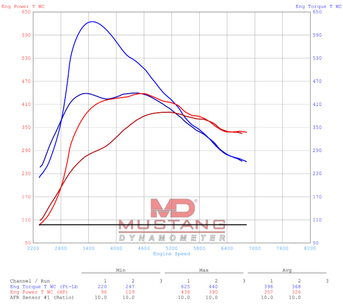

My C63S has stage2 tune and cat-less.
Recently I felt my car was not pulling as hard at high end speed, so look my car to a dyno run yesterday to see if any clues and got below result.
The max HP is only 440HP and the power delivery seems decline too early and too quickly.
Days ago, I also did quarter mile and got me 12.3 sec and 60-130 miles as 10.4 sec. Pretty slow..
It does not seem to right to me. Anyone know what may cause this or is this normal for this car?
I will bring my car in for 20K mile service very soon, and can ask dealer to take a look if any place needs their attention?

Yeah definitely very slow... Even a C43 would be faster haha. You should be at least in the mid 11's with stage 2 tune, I believe...at least that's where I'm at...

Who is your tuner? I think I know who it is. LOL.
What was your trap speed in 1/4?
Check what your spark plugs look like, but It's most likely the tune.

My car was dropping off in power just like this and found out that it had some soft codes and the car was in limp mode. It was due to my exhaust valve wires being unplugged. Yours could be something else though, would be worth getting it scanned to see what it is. My codes didn't throw a CEL.

This does look indicative of limp mode, although it's unusual to see such a high torque spike like that if you're in limp mode. I do 60-130 MPH in 9 seconds flat with just the Dinan tuner and no other mods - in Texas heat too.
You need to scan for codes and see if anything is out of whack - I'd contact your tuner, not the dealership.

Trap Speed 118~119 mph... Also super low considering its stage 2 car.

Main thing is to do a datalog and evaluate boost, timing, and AFR, to see if any of those point to the loss of power.

Yeah i'd scan for codes, take it to any auto parts store to scan for free. Most likely it's a tune issue. Do you have hessitation at WOT mid range?
The numbers your car posted are what I expect for a bone stock car..

How/where do I get the data-log? What device is required? Do you think dealer can do it for me?

you can get obd logger on amazon and buy torque for android to log. both cost about 25$.

I just ran 11.8s @118.5mph last week stock. In very hot FL weather.
Getting some slips to compare as I'm about to be stage 2.
Have the dealer check your solenoids, see if one is melted into the intercooler tubing.
