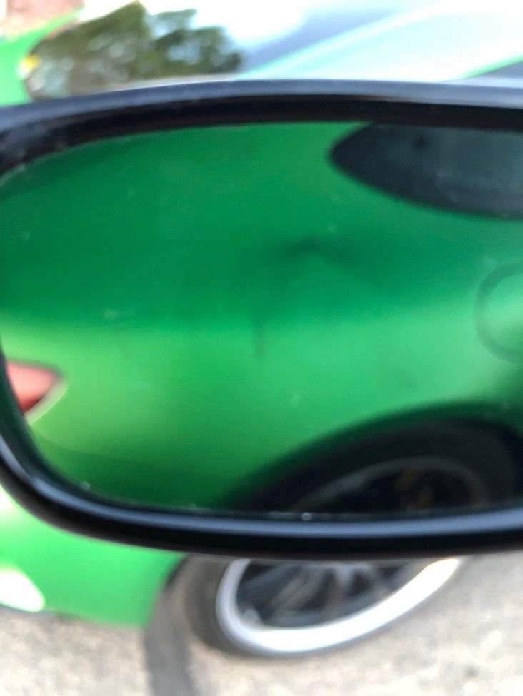

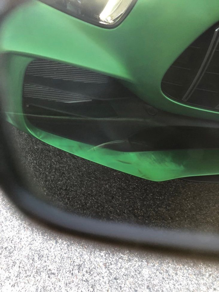

It's perfectly normal. Older post of mine on the GTR forum:
Today I was out and about and noticed some weird spots on my car. Thought it was just shadows from the building. I stopped and ordered a pizza on the way home and waited for it. While doing so, I was looking at my car and noticed spots everywhere. I freaked out. I thought maybe being in the sun the last couple days caused this on some defective film. I immediately drove over to the PPF place - conveniently 5-minutes from the restaurant. But alas they were closed. As I looked at the car in the shade - it looked even worse. Now here's the crazy part. For some reason I took my sunglasses off and they were gone. Put them back on, and spots back.
They look like squeegee pressure trails or something. I got the pizza and headed home. I have half a dozen pair of sunglasses. I was wearing Maui JIms' that are polarized. All of my Ray Ban's that aren't polarized it looks normal. If any of you guys have a pair of polarized sunglasses check yours and report back. I do have Suntek matte PPF on my car. Maybe it has something to do with only magno paint? Perhaps it's the brand of PPF? I'm going to go there first thing in the morning and show them. Although, they'll probably say that's weird and they've never seen that before. Which means, do I have them redo it? The pics are with my iphone behind the Maui Jim's as you can see. Just crazy! Note: It looks worse in person then these pics. However, you at least get the idea.

I freaked out as well. Eventually I did see other cars with matte paint with film and it was the exact same thing. Unavoidable. Just make sure when you are cruising you stay way from people with sunglasses on - lol. Once I found this out. I was fine and never thought about it again.

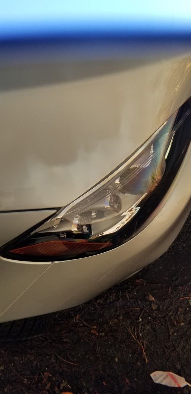

I spoke with the owner of the authorized XPEL installer today. He informed me he was unaware of this situation even though it's on the XPEL site under FAQ. Yesterday when I brought my car there and his assistant took photos thru polarized lenses to show what I was talking about. The owner advises let it fully dry within a month time and see what happens. But what I'v read nothing will change in a months time. I mentioned that I might want to remove it. But before doing something rash like having it removed "tomorrow" I will wait the month and see how I feel at that point.
The job he did seems excellent and it's good to know this is nothing to worry about as others have had the same situation. My 2019 C63S coupe is Iridium Silver . If I do decide to have it removed ( complete front end and rocker panels that extends to rear wheel wells who and how that will be worked out with payment.
I hope someone ready to get PPF is aware of this situation with polarized sunglasses.
Attached photos.

Really interesting. Does it look like it might be from where they push down on it when applying, or from stretching perhaps?

Not sure, but without polarized sunglasses it looks perfect and unnoticiable. The XPEL web site under PPF , FAQ (last question) deals with polarized sunglasses and states that you will see blemishes. Appears that is normal. I'm going to give it 3-4 weeks and not make a rash decision now by having it removed.

Honestly if this is normal and you see it on lots of other cars with expel, I would leave it and just live with it. I don't think most people use polarized sunglasses anyway.

When this happened to me I checked a little deeper. It seems to be a phenomena only associated with matte paint/film. Whereas gloss hides this effect. Being that there are not a lot of matte cars on the road, and mostly likely whatever percentages that do have PPF. I suspect hardly anyone would see or notice it on a car you were passing by on the road wearing polarized glasses. It also seems to be only prevalent on the flat areas as well instead of the sides. It did seem to subside a bit in my mind with age. But I never really payed attention to it after the fact. Mostly because I don't wear polarized glasses that often.

I missed that good catch. Must have to do with the lighter color then. Because those streaks/spots look exactly like mine on my matte paint. Actually mine were worse.

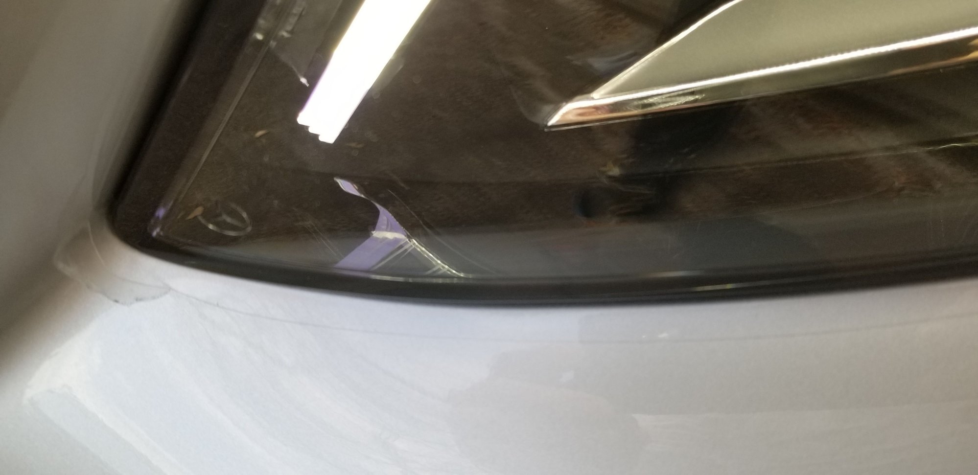

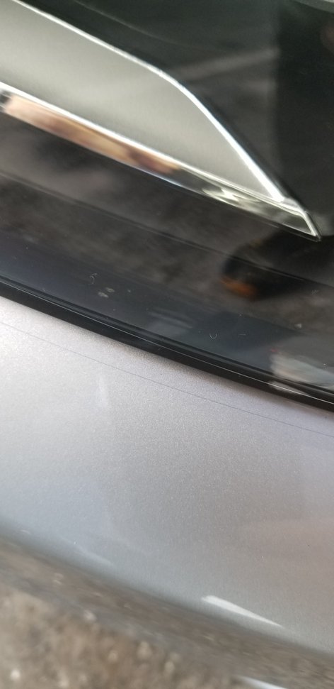

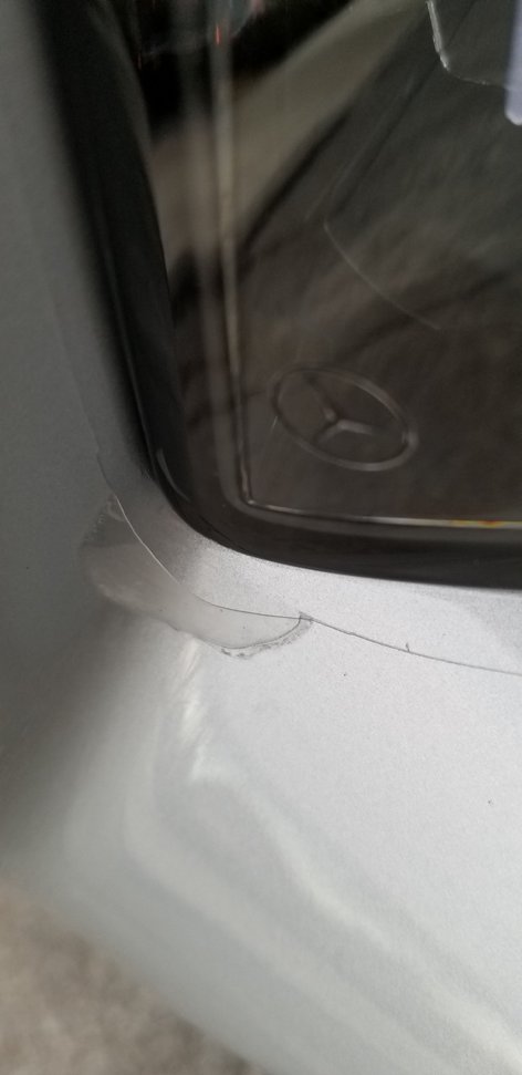

I had XPEL wrap entire front end done about 3 week ago on 2019 C63S Iridium Silver. I notice the wrap has separated / bubbled slightly from the lower corner right under the Driver side headlight. ( see photos) I also noticed that the wrap was not tucked under or inside the bottom of the headlights but cut about 1/4 to 1/2 inch short of the bottom of headlights.See photos.
. Has anyone else has this issue where the installer did not tuck the XPEL wrap under the headlights thus the cut/line is visuble?
. Also has anyone has the issue where the small section under headlight has bubbled?
. I called installed may have to re-do front fender or make a small cut in wrap. Will bring in monday.
. Any advise would be appreciated

That looks like the film was stretched too much or not enough adhesive used. Also, as far as the film not going to edges, I'm guessing your installer used the standard XPEL templates. They stop short of the edges. At an additional cost you can request an upgrade to wrap the edges where possible, which is what I did. That way the film goes all the way to the edges and around, which eliminates any lines and reduces the risk of the film starting to peel from the edges. The cheap installation places just use the templates. You'll pay more for a custom wrap with wrapped edges, but the result is worth it.
