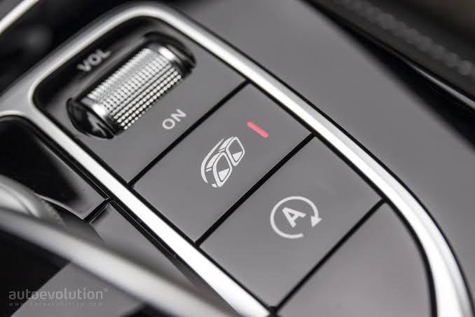

You've got the AMG Performance Exhaust, don't you? With the exhaust button on the console, yes?
If you do, then there's an issue here. Pressing the exhaust button on your console will open the two rear muffler valves regardless of which mode it's in. I always drive in Comfort mode with the valves open.
Does the exhaust button on your console illuminate red when you press it (like in the picture below)?

Yes I have both performance exhaust and drivers package
The button illuminate when I change modes, but in comfort it dos not illuminate when I press it
