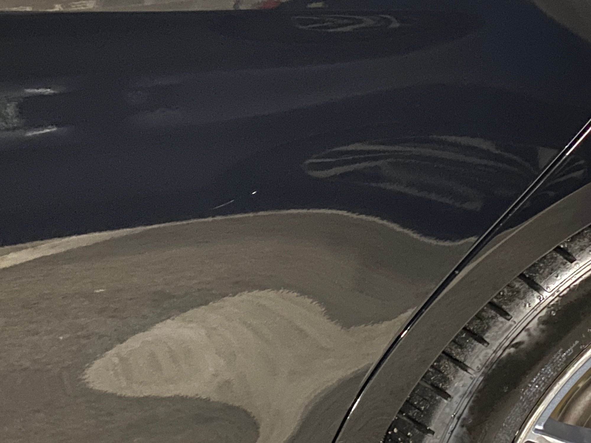

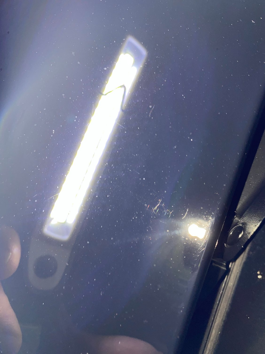

Terrible Service From Dealership
Feldmann Imports in Bloomington, MN.
Here is an update of my experience paying to have work done. I had a horrible experience. This is the text communication with the service manager. I wanted to make sure the idler pulleys were included in the job order.
There is still a noise on startup coming from in there- I'm guessing it is one of the idler pulleys. Here is a copy of the statement. As it is here, the idler pulleys were not included in the service.
Side note, the other issue was with the alignment. Sears Imports in Minnetonka, MN stated I had a problem with the rear alignment. That some mystery part was needed to complete the rear alignment. In actuality they misaligned the toe adjustment on the front left side and was trying to scam me. The alignment job Sears Imports completed was off, the situation wasn't as Sears Imports claimed.
Getting back to the service I received from Feldmann Imports in Bloomington, MN. The service manager stated the idler pulleys were included. Not only did they screw me on the repair they scratched my car. I had just detailed the car prior to the belts squeaking.

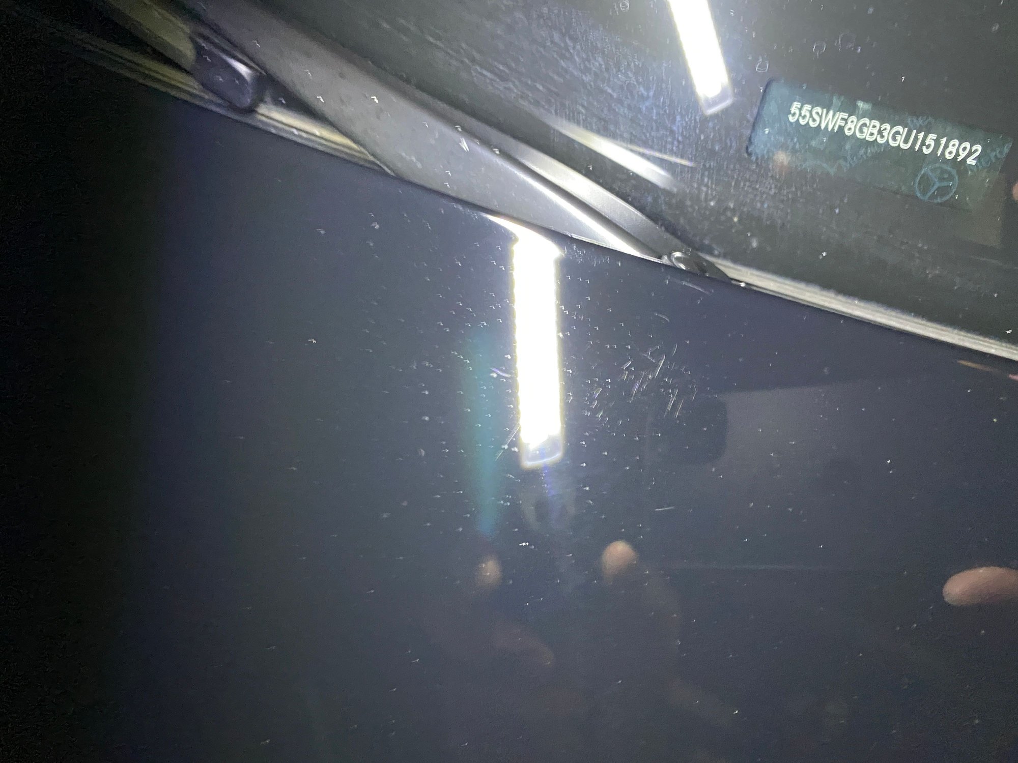

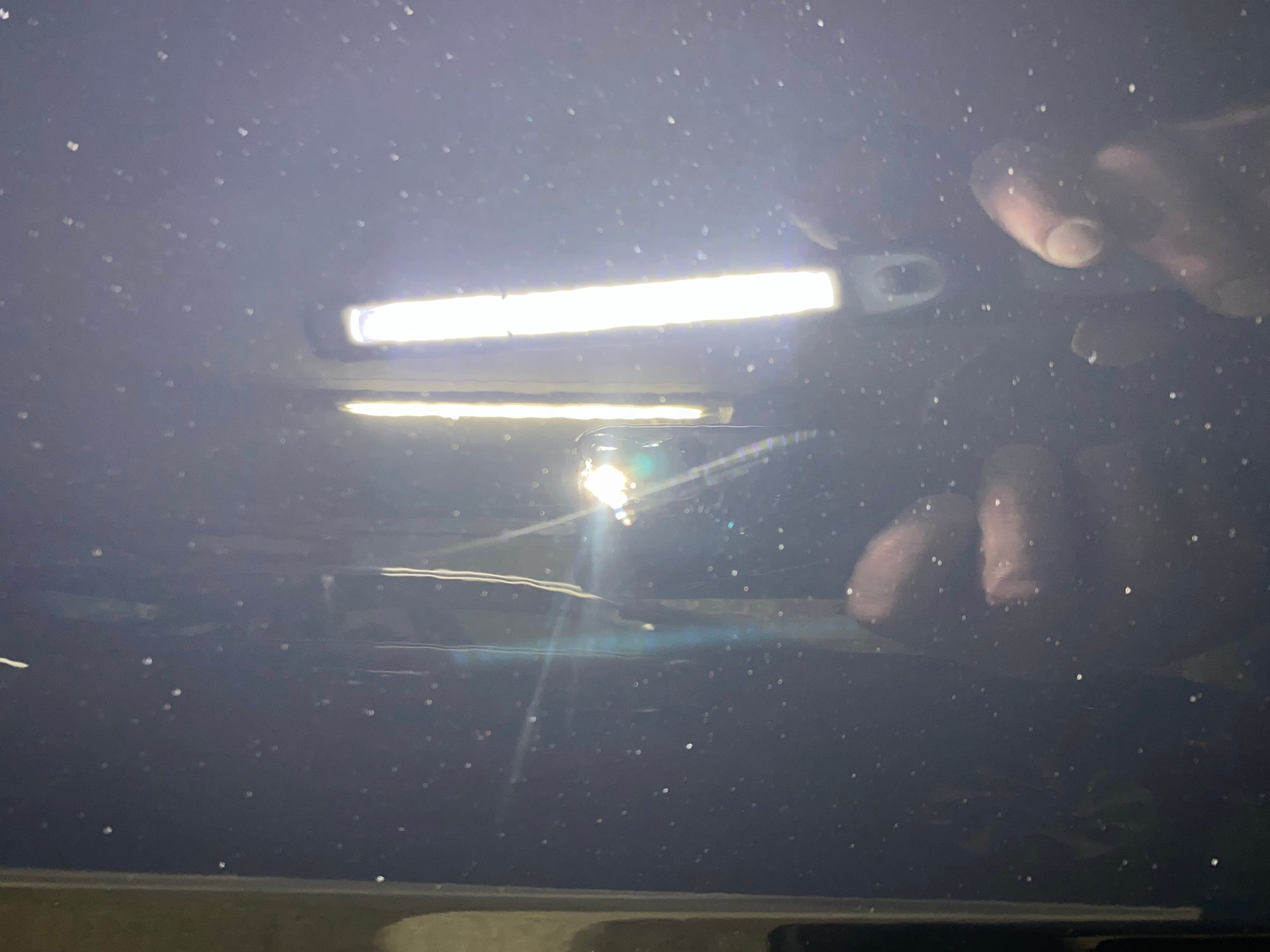

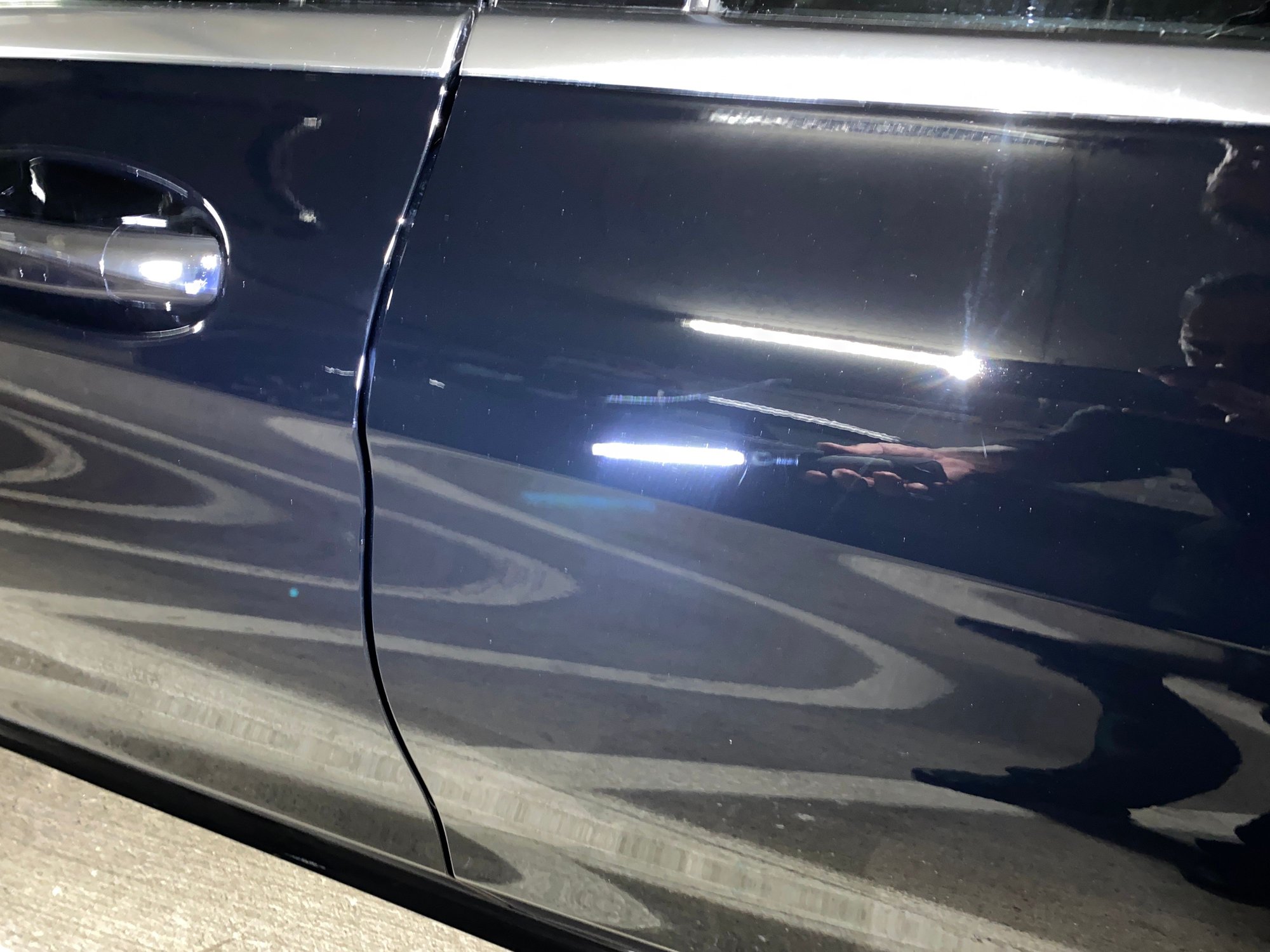

These scratches were not here before the service.
There is a mark and scratch on my passenger door.
Look at the mark Feldmann's made.
They scratched my car.
This damage would not have happened if I had bought the parts and did the work myself. I'm going to buy the idler pulleys and change those out myself. I'm the only person who cares if my car is repaired correctly- I will do a much better job.
Trust level is at the zero mark with any dealership.
What can Mercedes do about their dealerships giving terrible service and/or ripping people off.

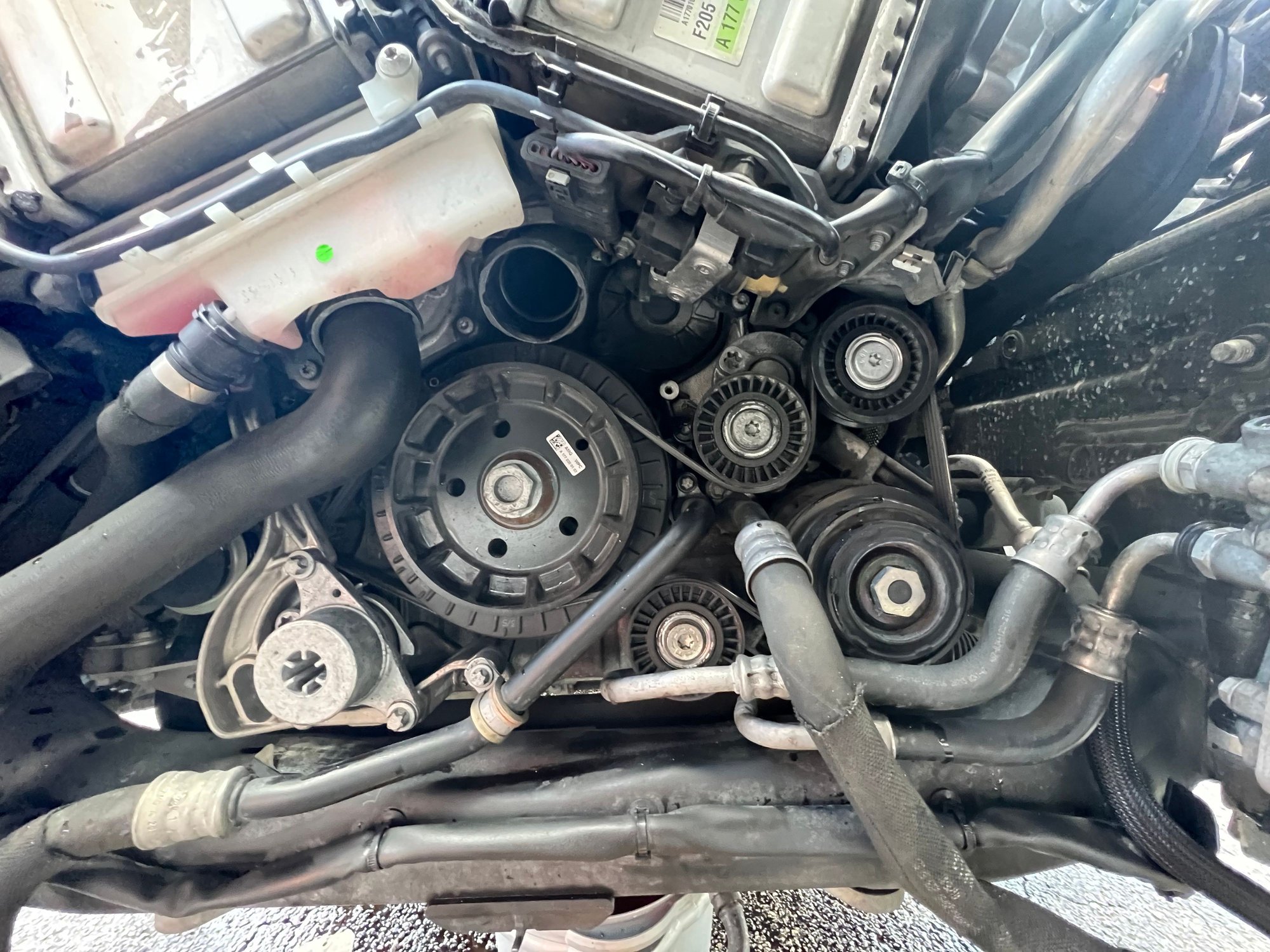

BELT CHANGE
From above, I did get around to buying the idler pulleys and changing them. I reviewed instructions from ALL DATA. ALL DATA is not very comprehensive and it would have been nice to have a few details.

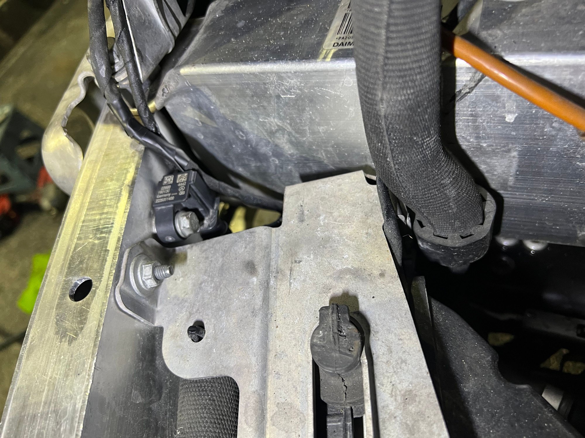

Now it was time to change the belts. As I mentioned ALL DATA does not have comprehensive instructions. Pulling out the cooling fan is difficult. All the rubber around the radiator housing needs to come out. To change the belts and pull the intercooler lines the radiator needs to get lifted up. The a/c is connected, the a/c line needs to be disconnected. Then also there is a sensor attached to the radiator. The line to the sensor is attached to the frame in the front, there is enough wire to disconnect another sensor on that line to have enough slack to lift the radiator.
Unbolt the sensor there and there is enough slack to pull up the radiator. Even knowing these details I highly doubt that i could do this job in 4 hours. Previously when I swapped out the idler pulleys i just pushed the radiator forward enough to get my hand in there.
I pulled the radiator up and had it sitting on the frame. I forgot to snap picture. I refilled the a/c and it is blowing cold air. And be careful not to loose any oil from the intercooler, keep the hoses up and against something.
Not a fun job. I didn’t check if I have any codes. If so, I’ll just clear the codes. From the previous comments, tensioners are spring loaded. Nothing electrical is connected to the belt tensioners. Xentry is not needed- LOL f’ing troll
