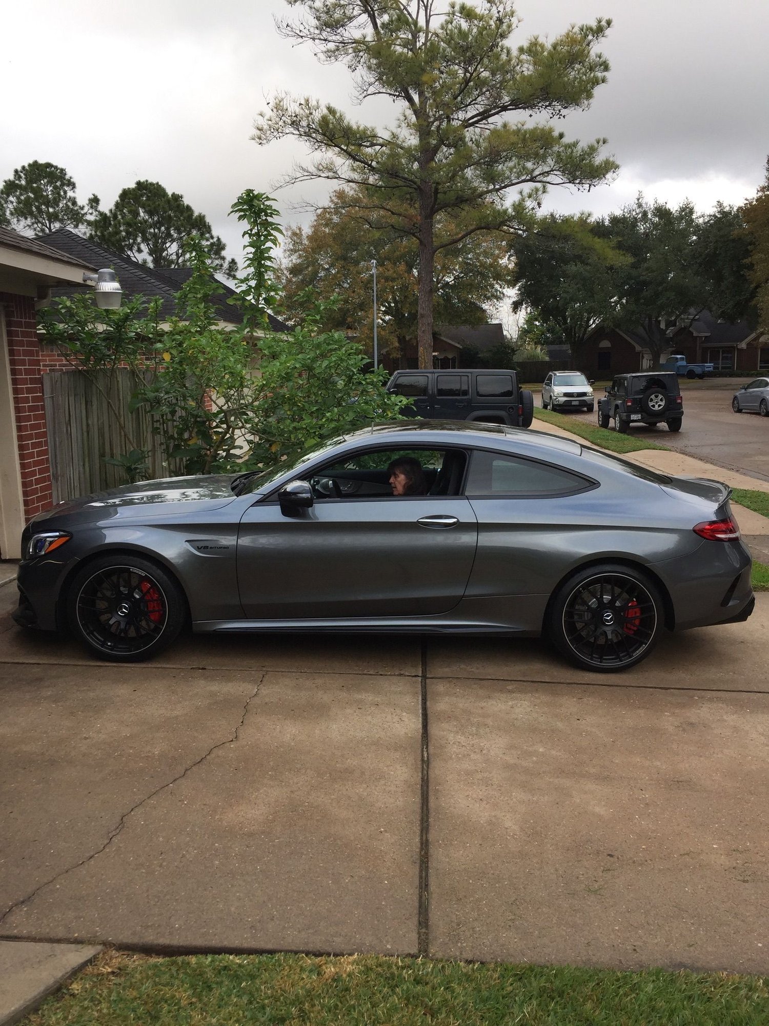

Someone asked for a pic of the side showing black lettering. If you can zoom in with a Mac, you can see fairly well.

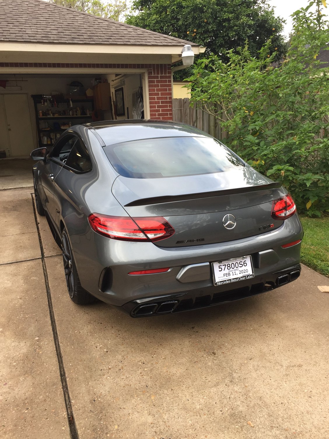

Alright just wanted to FU on this thread....
I have a 2019 C63s Coupe (night package)
Removed and replaced all the chrome lettering with gloss black lettering using a heat gun and fishing line.
Was actually pretty easy.
That star on the trunk lid though....
On my car the star is on a little plate that tilts up to reveal the camera when the car is in reverse.
I just want to be clear...there is no backing plate or screws, right??
Tried for a bit with the gun and fishing line and couldn't get that thing to budge one bit.
Because its mounted on a little movable piece its hard to tell if the fishing line is actually going underneath the edge of the star.
Anyone on this thread have any advice on getting the star off my car??

I did and caught grief because of the way I did it. I tried all the above too. Tried to use a small sharp sided screwdriver to budge it. Wound up using a box cutter and ever so carefully dug under the widest part of the star. It budged. A slight twist and little by little it gave. It broke. I then easily removed the rest. Cleaned it up. Pressed in/on the new one. NOTE: only works with the double sided tape it came with.
I do not recommend this for most people! One slip and you’ve trashed your car.
Mid you look closely you’ll see some damage at 12and 10.
