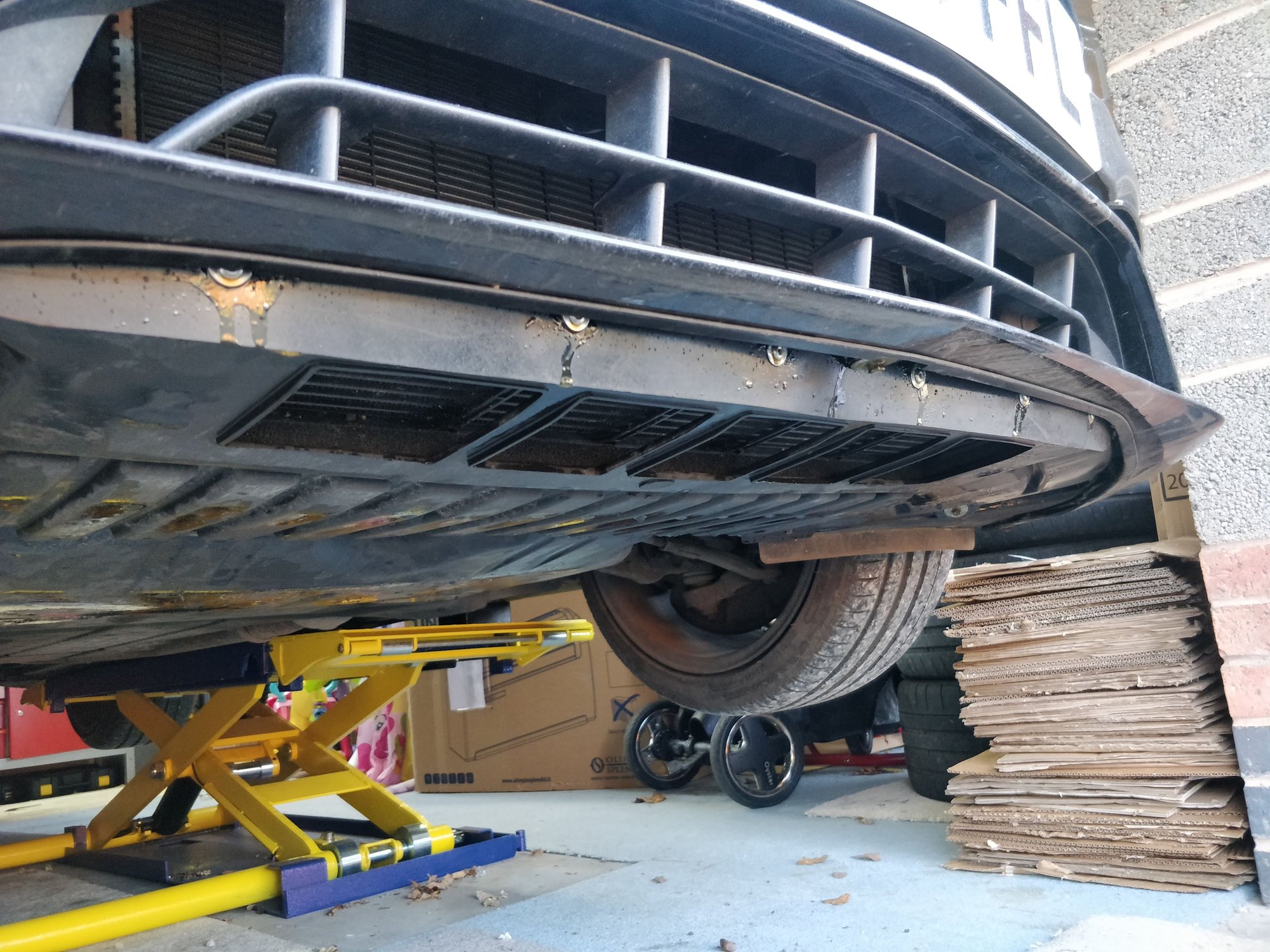

She has a little beater (Mazda 2) for the school run and general running about, only uses the merc for longer trips and going out with the kids to church, parties etc. Got it booked in for a service next week, so will get it fixed at the same time.

Finally got it replaced, it's a 2.4mm x 40mm strip hanging off the undertray, held on with tri-fold rivets. I bought a 3mm x 40mm (1m length) off eBay and cut the shape.
Added some washers and spayed with rust inhibitor.
