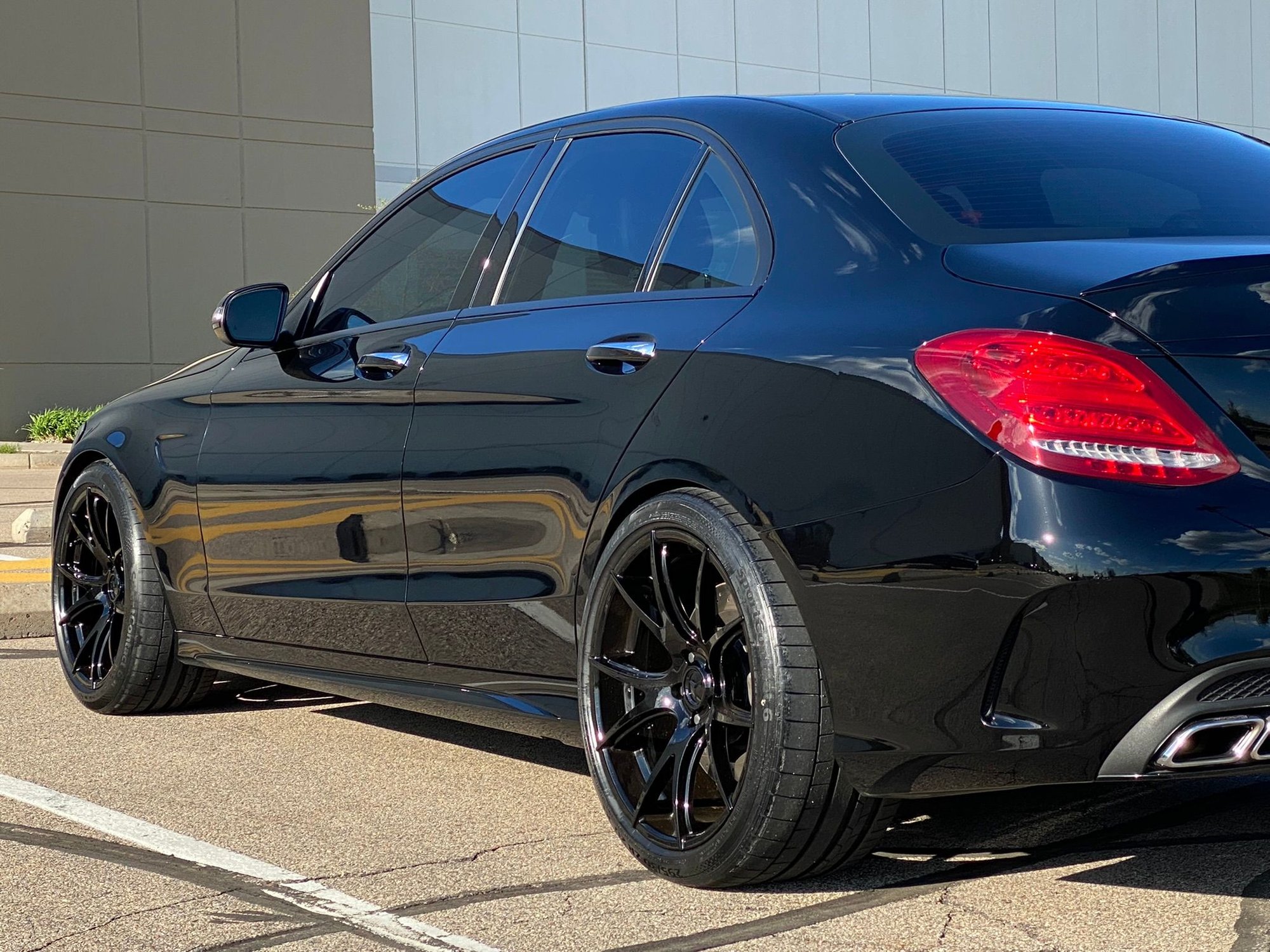

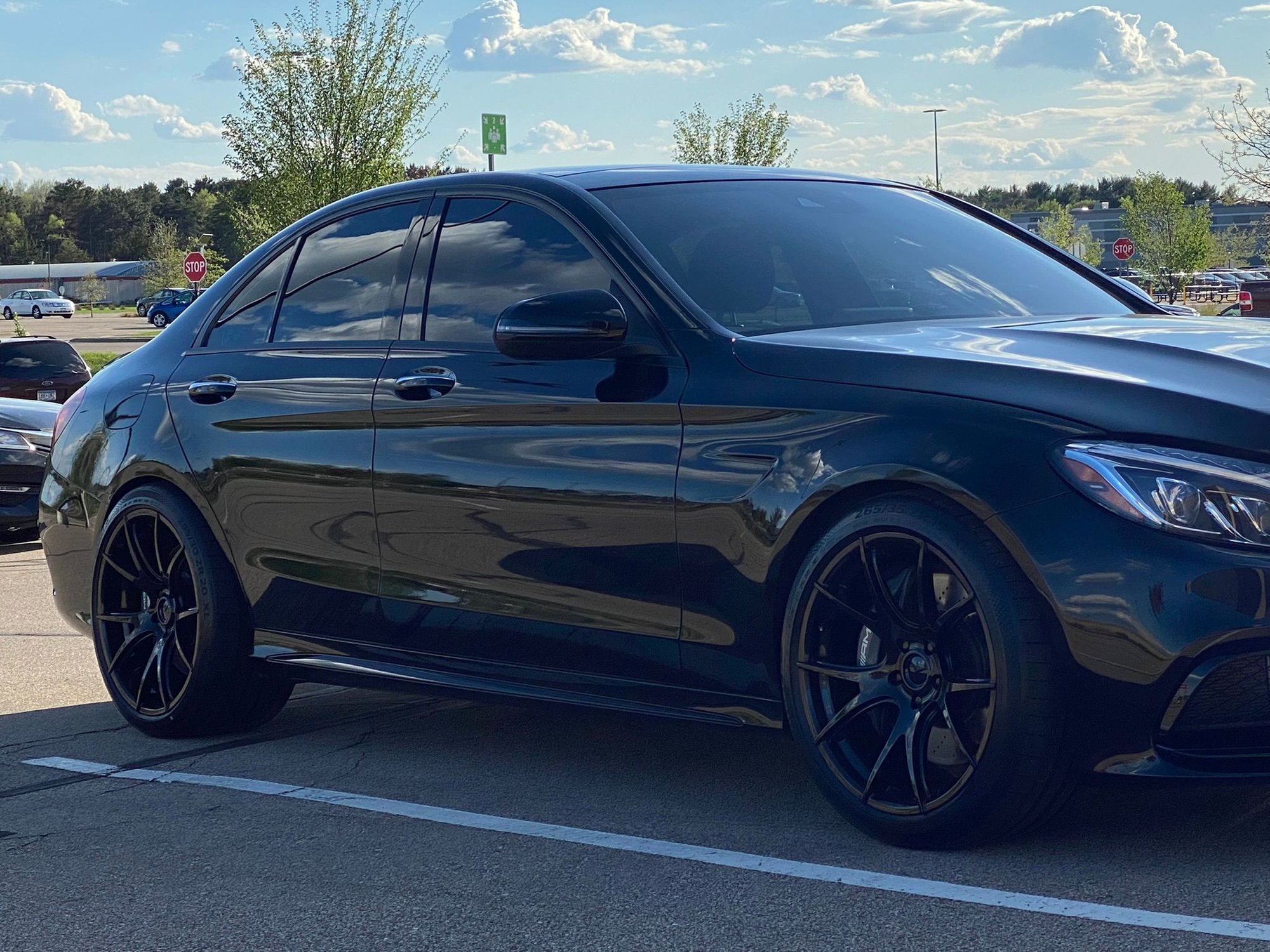

With stock wheels on C63 AMG W205 Sedan you can use 255/40ZR18 front and 275/40ZR18 rear.
If you want to use aftermarket wheels you have many options.
Front wheels:

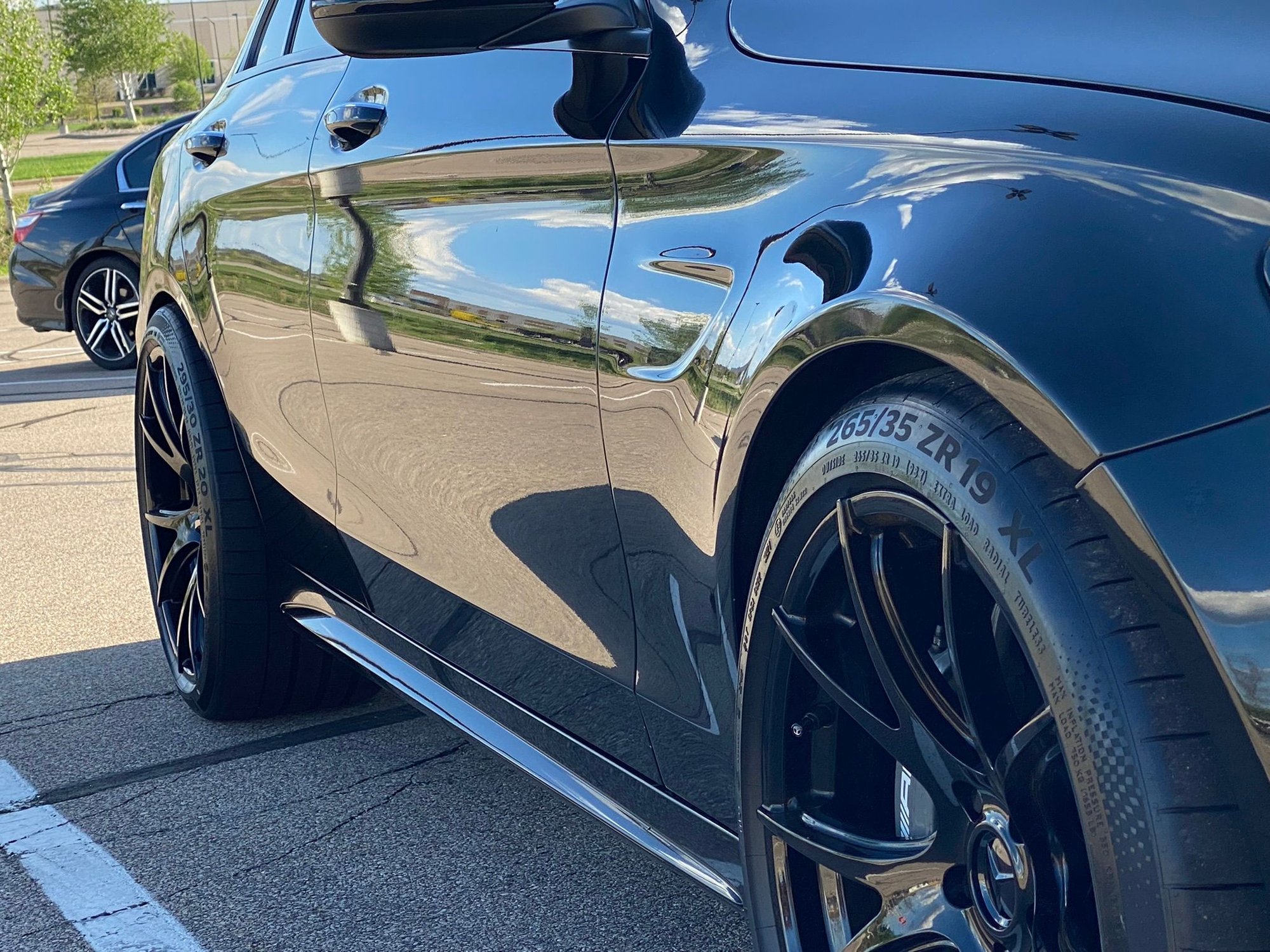

9.5 inch at ET+30 with 265
Runs fine with no modification.
I have 19x9.5 ET+30 & 265/35ZR19.
265/35ZR19 & 265/40ZR18 are the same diameter.
*people have said 10 inch at ET+25 works but there’s some wheel poke. For 275’s on the front.

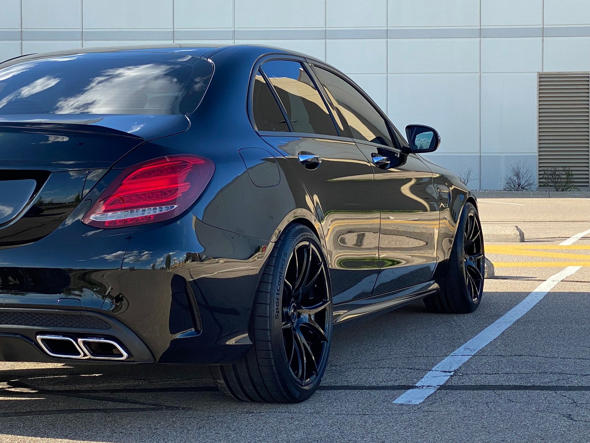

Rear wheels:
People have stated they run 305 on 10.5 inch wide wheels. I didn’t want to put 305 on 10.5 inch wheel. Rear wheels, 11 inch wide requires some modification, wider than 11 inch wheels requires significant modification.
I have 20x11 ET+55 with 12mm spacer. Final ET+43
Which required slight modification to the rear fenders. I was thinking of trying 8mm spacers to pull the wheels in slightly, 10mm spacers would definitely work.
Thus, I can say 18x11 ET+45 should be fine with either 295/35ZR18 or 305/35ZR18. It is recommended the rear wheels be larger diameter for better handling. That is what was recommended to me.
18 inch wheels there’s only 1 option.
Nitto NT01 265/40R18 & 305/35R18
Moving up to 19 inch front wheel there’s plenty of tires to choose from. Choices disappear trying to fit 20 inch up front so that’s why I went with 19/20 setup like the coupe.
The handling is great, far superior to stock. The verdict is still out on cutting a slit inside the rear wheel wells to add an extra inch or more. It requires a couple of relief cuts on the outside. Some welding and a little fill work to make it perfect. I talked to the custom shop in Orlando about doing it. The work is a little expensive compared to the value of the car. He gave the project a shoulder shrug because I pulled the fender enough that it doesn’t rub. It works so there’s not much need to change it more. He suggested I just take a saw to it and weld it up myself, because I seem to have a good idea of what needs to be done.

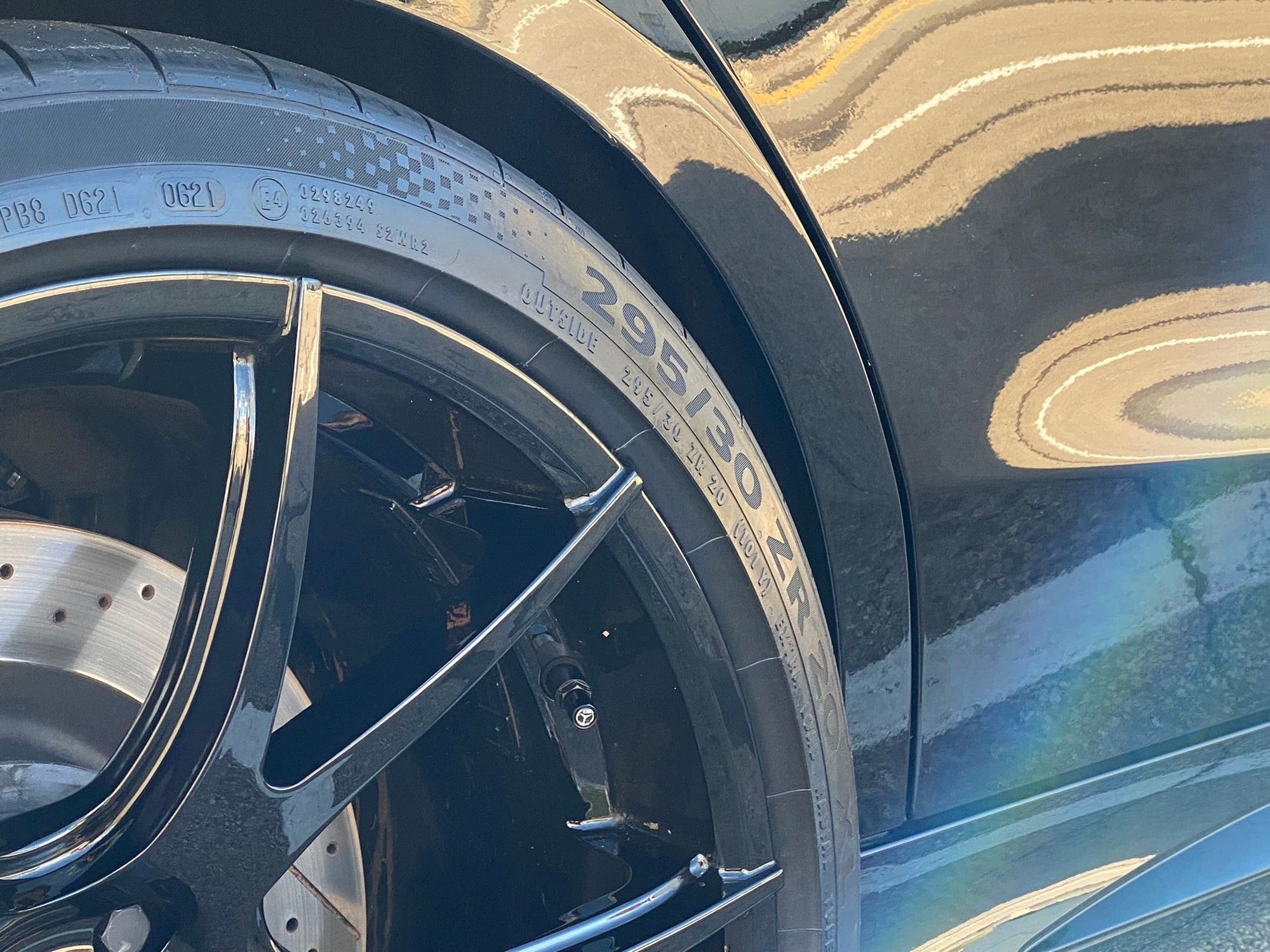

I was told most aftermarket wheels are not going to fit the big front brake caliper- Even with 19s. Some people choose 19/18 combination to run meatier tires in the back.
As I stated 20x11 ET+45 is perfect fitment on the rear with 295/30ZR20 if you are willing to (roll and pull) reshape the rear fender.
265/35ZR19 & 305/30ZR19 the front wheel has a larger rolling diameter. For proper physics the rear wheel is going to have a larger diameter, 19x12 with 325/30ZR19. Otherwise 19/20 staggered setup, 295/30ZR20 has the best matching diameter, 305/30ZR20 would likely make the car slightly slower due to increased rolling diameter. I might try a 305s anyway.
