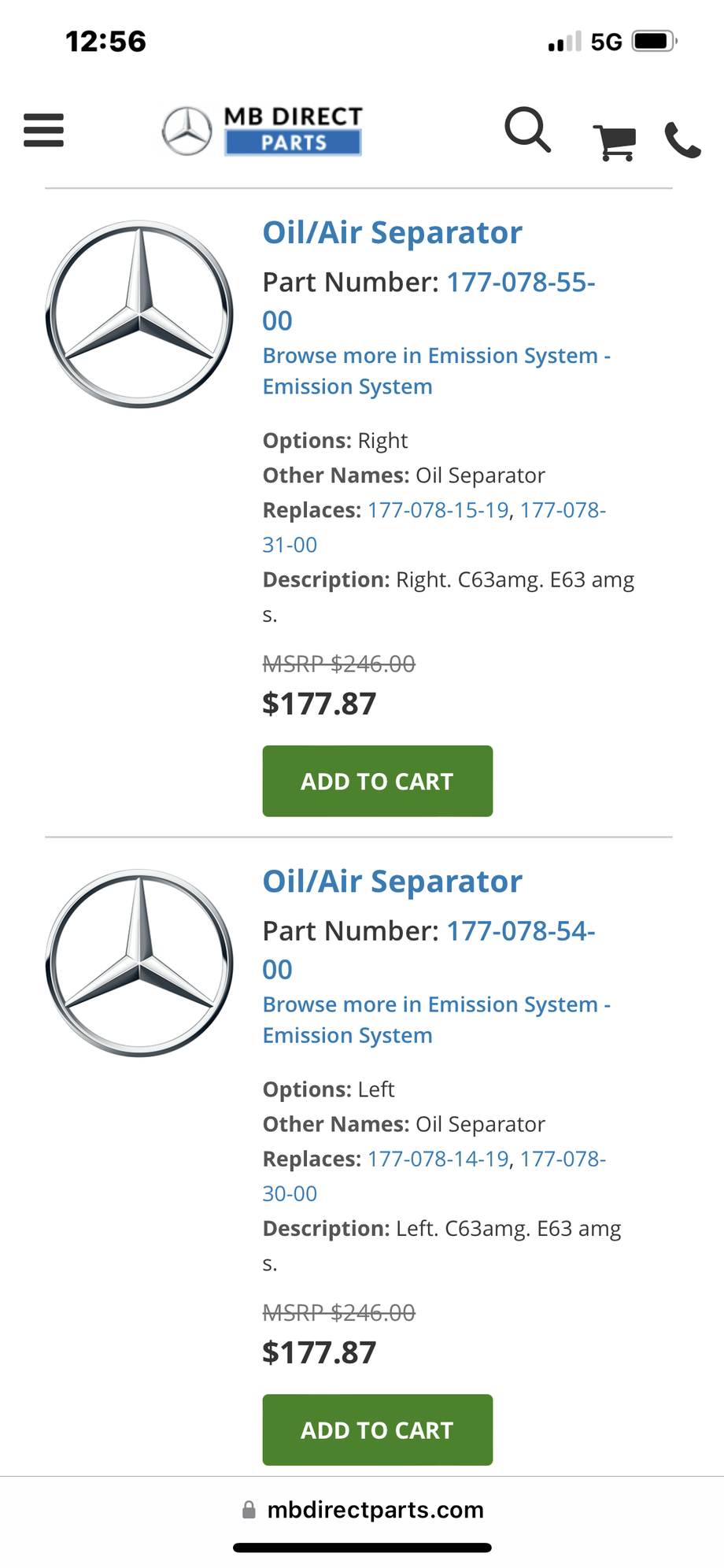

That is what I heard as well. Cause I think someone tried installing them and those cans were always empty almost.
looks like there’s two of them. One for the right and one for the left.
