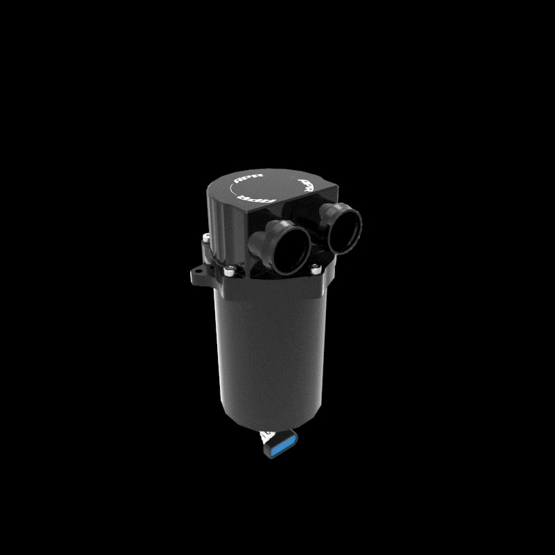

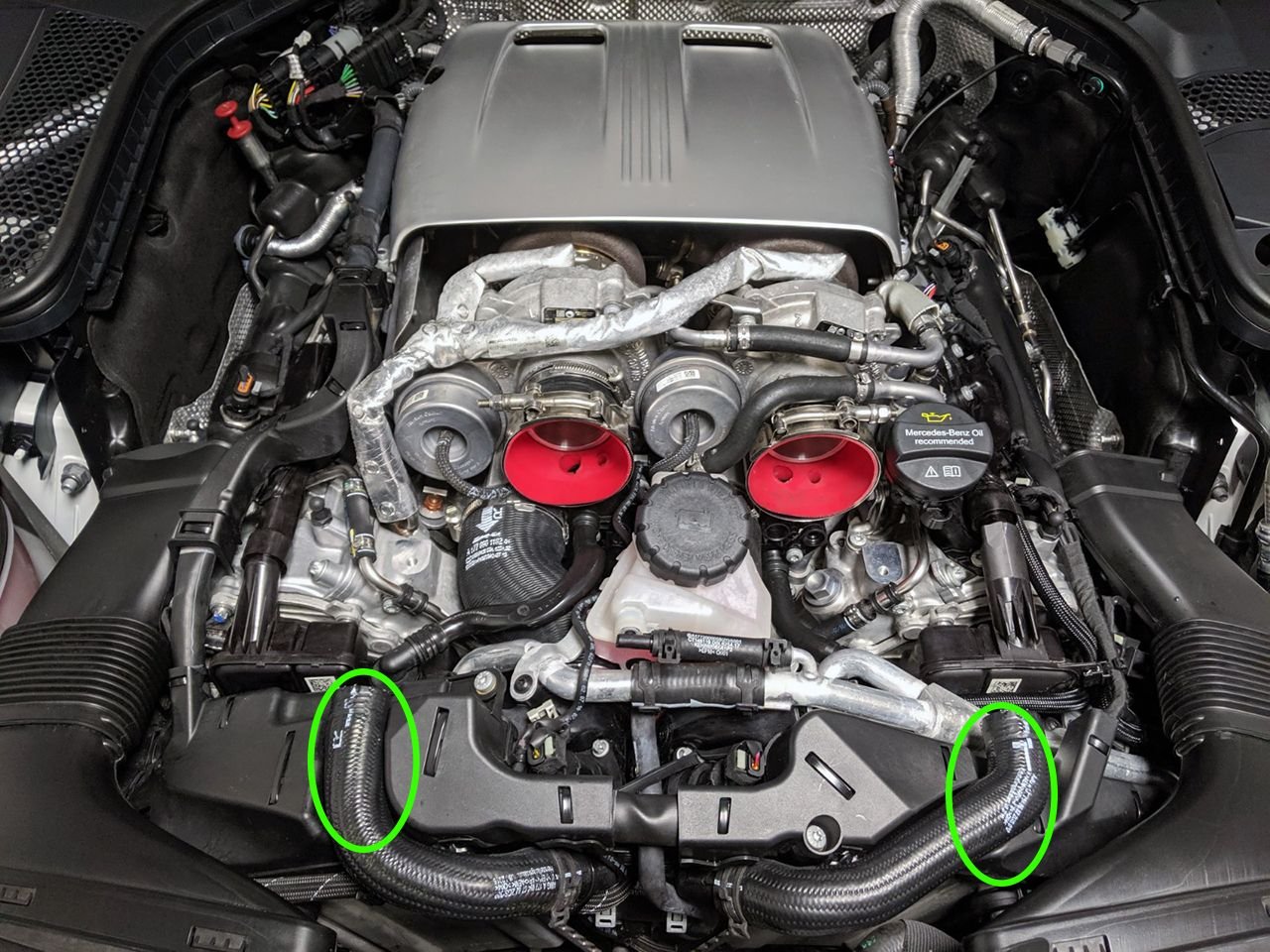

Attached a couple shots of where the PCV outlets/inlets are so we can brainstorm a little more. Maybe we can plug the input on the coupler and find fittings/adapters for the 90 elbows on the PCV outputs? Go VTA BOV to free up the nipples and remove hoses on the forward part of the intakes and use the channels in the plastic covers that were made for those hoses to route hoses to the catch cans? Would like to see something like the APR catch can as part of a kit even though they are $250 a piece. They have a very good filter design and compact. Fitting them would still be a challenge. Looking forward to discuss this further and see some progress.

I am interested in this as well, btw is the pictures shown in green circles are they crank case vents or are they valve cover vents? Because they look close to the valve cover instead of crank.
