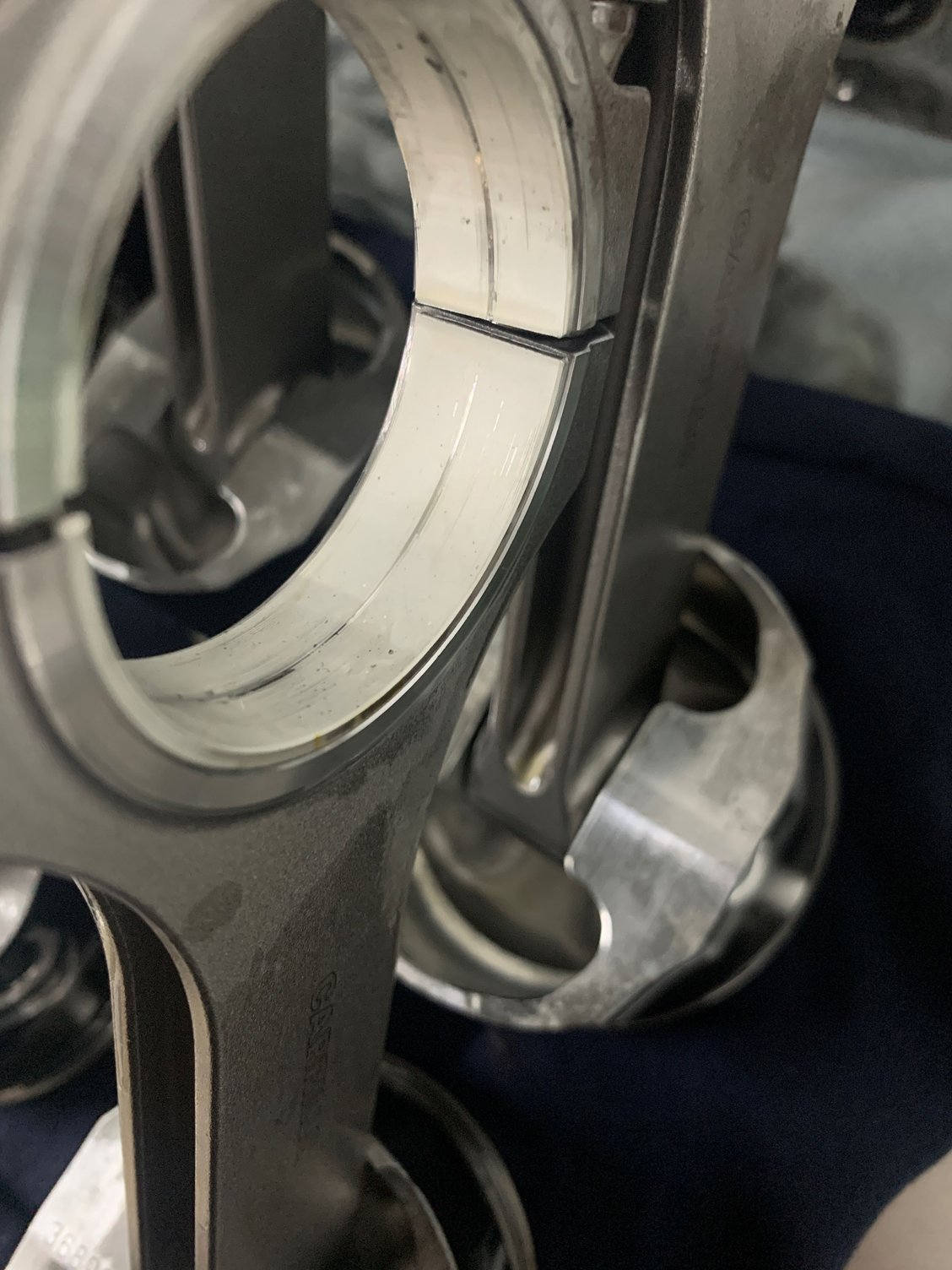

Quick update after removing sump & oil pump.
To add to the growing list of issues with this Yabeela long block:
1. Most bolt threads required to be helicoiled due to being stripped
2. No oil pressure when cranked with no plugs
3. Oil spraying out of cylinder 5 spark plug hole
4. All 4 oil squirters missing not fitted to the block
Well hope that’s the last issue but no holding my breath.
Let’s hope piston rings, bearings and head gaskets are fine.
Would be interested to know who physically built this engine.

Update: Yabeela block stripped for inspection.
If your considering buying any performance parts from Yabeela Parts please look elsewhere.
This is what the inside of a NEW UNSTARTED Yabeela Parts Forged Long Block looks like out of the box?
Quality of workmanship is unacceptable.
Still inspecting the bottom end but have found the below issues to add to the growing list:
6. All bores filled with oil
7. 2x rod bearings scored
8. Timing chain tensioner bolt thread
From here, the block will need to be sent to a machine shop to get see if the timing chain tensioner bolt thread machined as it can’t be helicoiled.
Then check the pistons and rings to see why oil is filling the cylinders.
At this point there is so much wrong with this Yabeela engine so the heads will be sent off to be inspected to ensure valves are sealing and to check oil galleries etc.

[QUOTE=RDO247;8040682]Edit:
Quick update after removing heads, tearing down and inspecting forged block.
4. Debris found throughout the engine
5. All 4 oil squirters missing not fitted to the block
