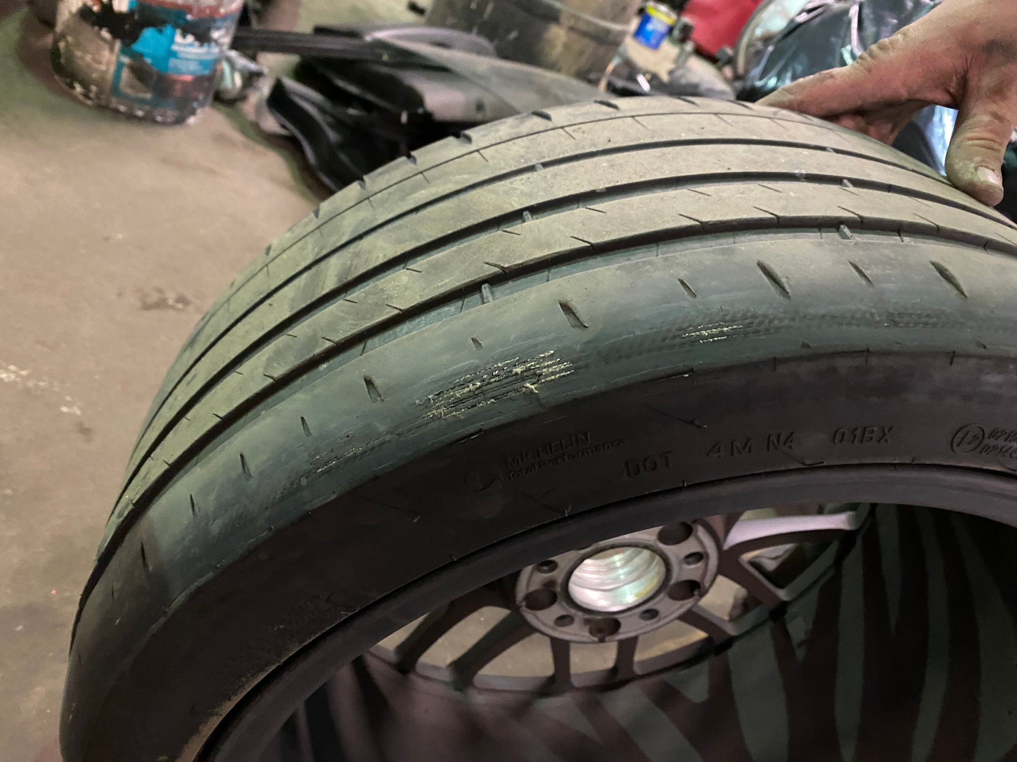

Photos below are my original tyres pre-lowered after 8 months.
Tyres now last me well over 2 years.

Originally Posted by Klinh
That is more of a toe in/out issue.
That’s correct, however, this damage accrued within 8 months of the car being purchased, standard height and factory alignment.
Took me 3 sets of tyres before I decided to fit the K-Mac Camber kit and by properly correcting camber, caster & Toe tyres now last over 2 years.
