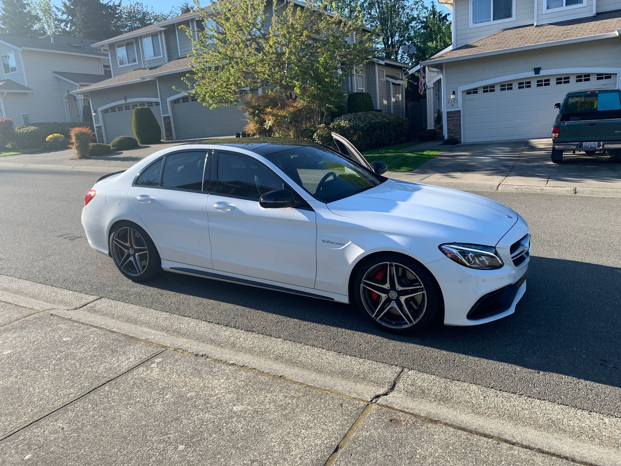

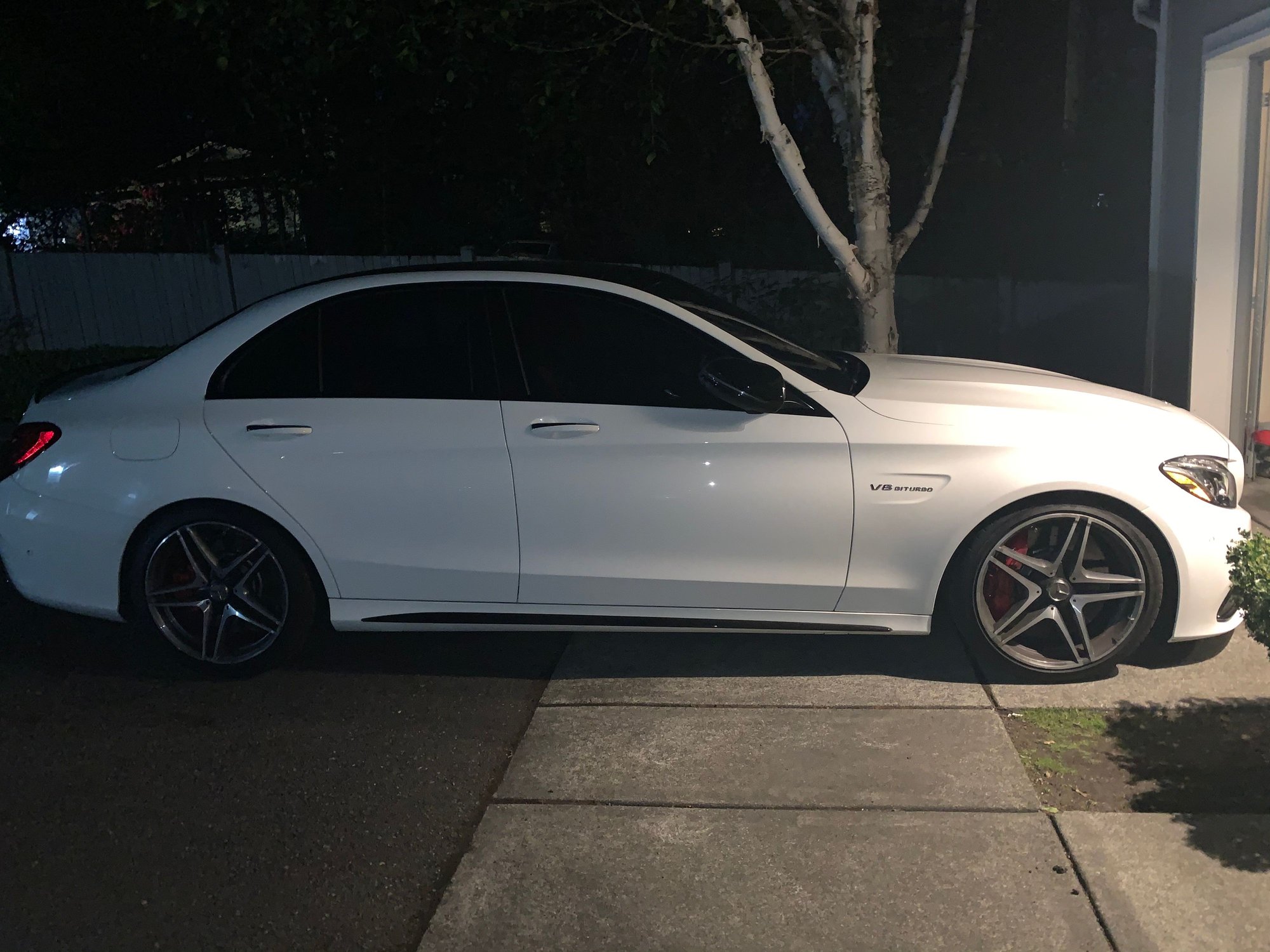

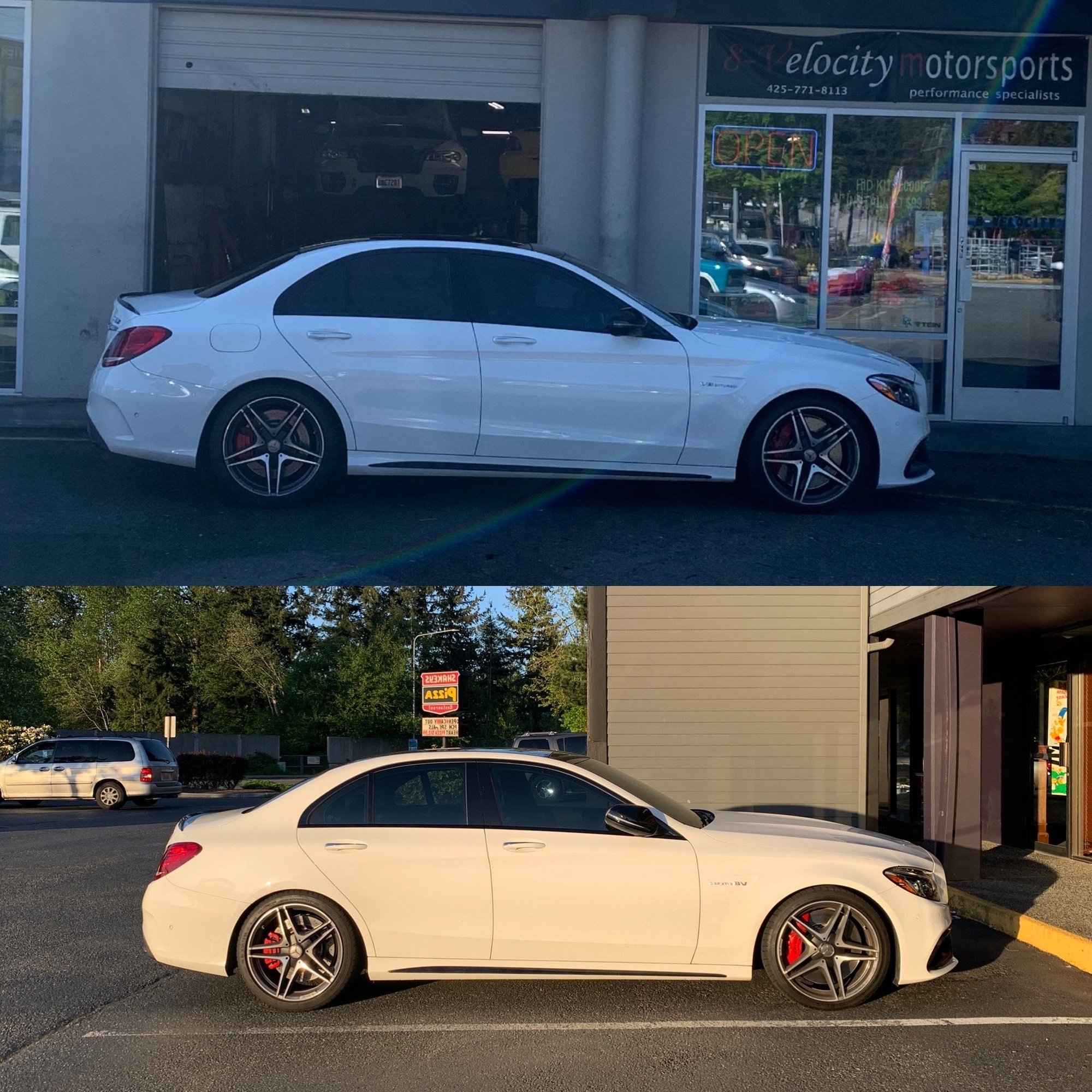

C63S Amg

Old May 9, 2020 | 01:10 AM
Klinh's Avatar
Joined: Mar 2008
Posts: 3,632
Likes: 150
C63s Cabriolet, BMW M4, Civic
That’s a dropped. That look about right for Eibach pro kit
