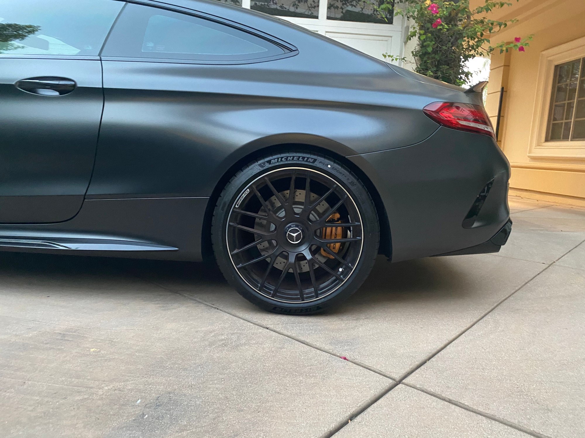

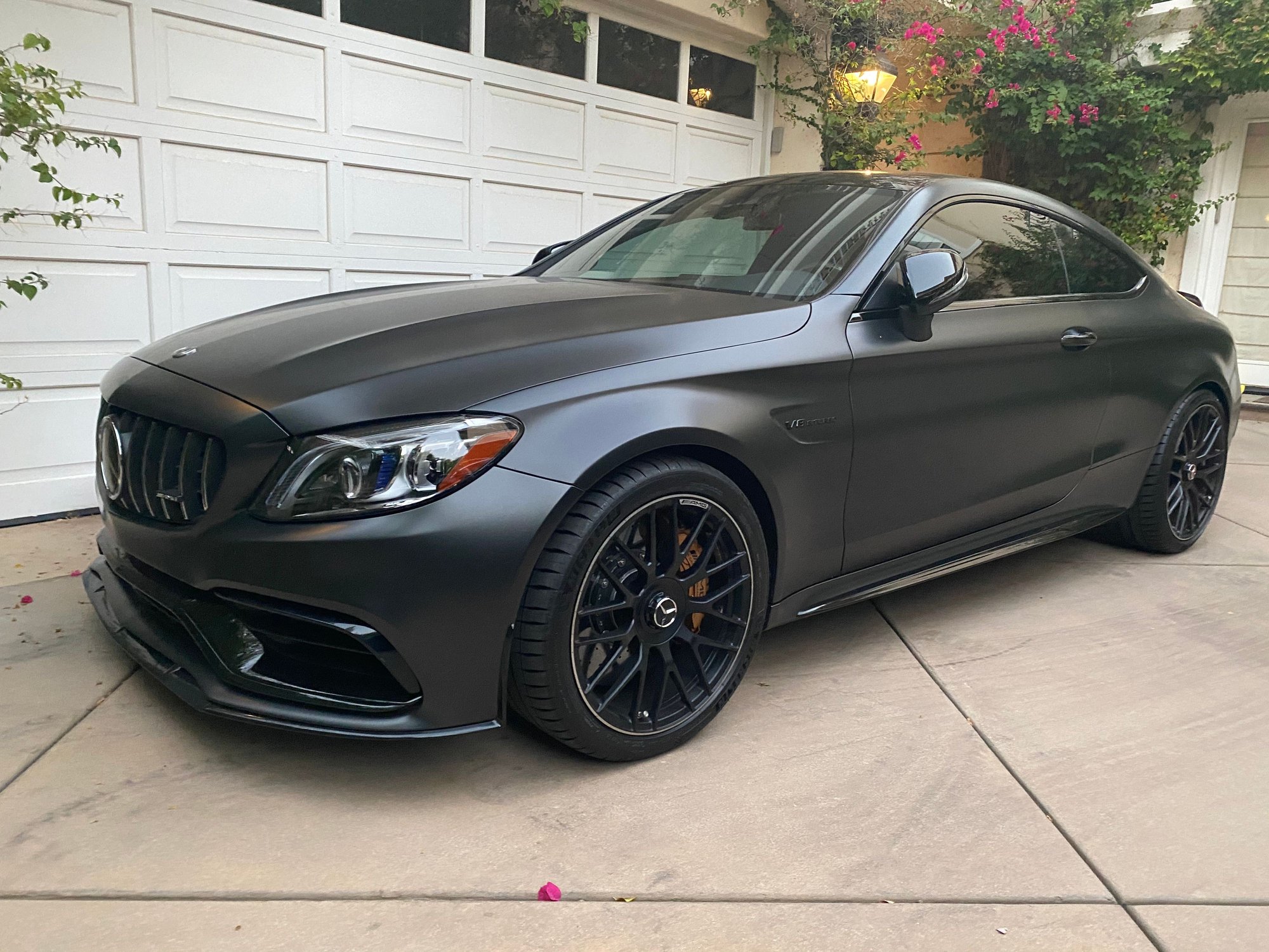

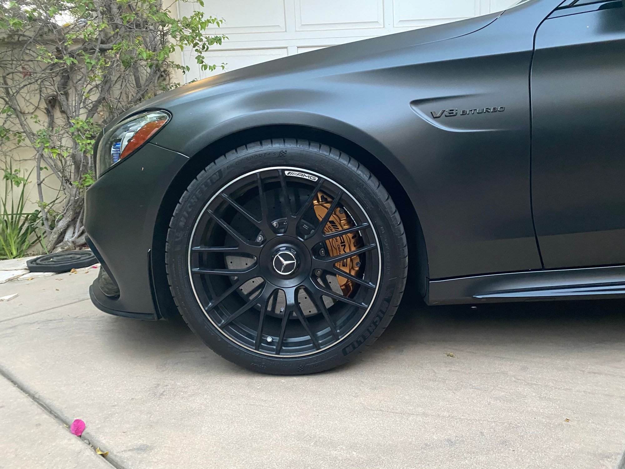

Wanted to share so this is on record if anyone is ever searching in the future.
For PS4S' I went with 265/35/19 & 295/30/20 on my 2019 c63s coupe on stock height with oem wheels and 12mm spacers all around.
I've seen some better looking configurations on here, but I will tell you that going with this configuration will change the way your car drives, just like many have said on this forum. I came from the stock PSS' with about 12000 hard miles on them so this is like as day & night as it gets. Yesterday I felt the first full smooth pull from standstill. My car has stock power, so it didn't NEED PS4S', but holy **** does it drive nice.
Apologies for the less than ideal pictures. Limited space in the driveway.
