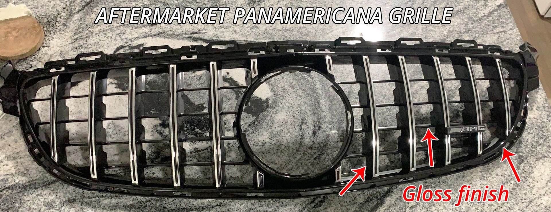

Exclamation DIFFERENCES BETWEEN CKS PANAMERICANA VS OEM MERCEDES PANAMERICANA GRILLE
CKS grille: The inside areas are finished in GLOSS BLACK (the silver bars naturally stand out more due to this and gives the car a more "classy" look)
OEM grille: The inside areas are finished in MATTE BLACK (the silver bars can sometimes look more darker at certain angles and a bit more "shadow chrome" due to this illusion)
CKS is almost identical to OEM in looks.
One very minor issue I have noticed is the old prefacelift distronic star emblem does not fit 100% flush in the aftermarket grille and there is a bit of play when you press the star. I've tested two C63S distronic stars and both will not sit flush. It's not noticeable but it still annoys the sh*t out of me.
These differences were never mentioned anywhere here or on the CKS website so I'm truly hoping others will make their decision based on my experience.
The good thing is It's almost impossible to tell the CKS and OEM grilles apart really. And both of them produce an individual look.
Classy look = Iif you have the black night package and you're keeping the old bottom air dams from the prefacelift, feel free to get the CKS aftermarket Panamericana grille. It actually matches the night package perfectly.
Sport look = If you don't have the night package or you're planning on installing the facelift air inlets as well with your night package, get the OEM panamericana grille as the facelift air inlets are the same finish as the OEM black areas of the grille (if you're really fussy).
CKS did a superb job with their aftermarket Panamericana grille. It's an inexpensive way to transform the look of your car, but after my experience I personally recommend you go through the trouble and buy the OEM grille + distronic star + AMG emblem from CKS.

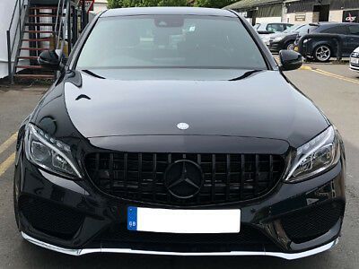

Im looking to get a an all black facelift grill for my 2018 C63 without distronic or camera
any recommendations?
I want something.like this from cks
