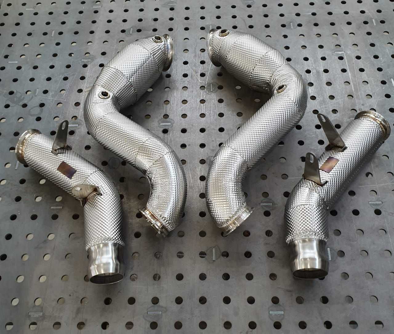

Which version of the HJS 200 cell dps did you end up going with? 121mm or 130mm? Redstar says you shouldn't get a CEL with the 130mm version of the HJS cats.
Originally Posted by BrianShaw23
Good to know, I was considering using the bigger o2 sensor restrictor from Fabspeed, the one with a small built in cat but I'll try the smaller one Red Star is sending me. I was surprised too and I think you're right, MB is making their cars more and more sensitive and strict. I did some research and I found out that the way the dps are built and the position of where the o2 sensor attachments are placed on the dps makes a difference whether or not you get a CEL with HJS 200 cats or not. Fabspeed and Renntech both apparently redesigned some of their dps to fix this issue. So it could be that for the Red Star dps.
Here are my Red Star HJS 200 cell dps with heat shielding:

I still think the 400 cell GESI won't cause a cell. Its heavily loaded with precious metals and have a no cell Guarantee and is EPA certified

Yes but I'm asking about the 130mm HJS 200 cell cats. They are listed on Redstars CEL free guide but I wanted to see which HJS 200 cell cats Brian had.
