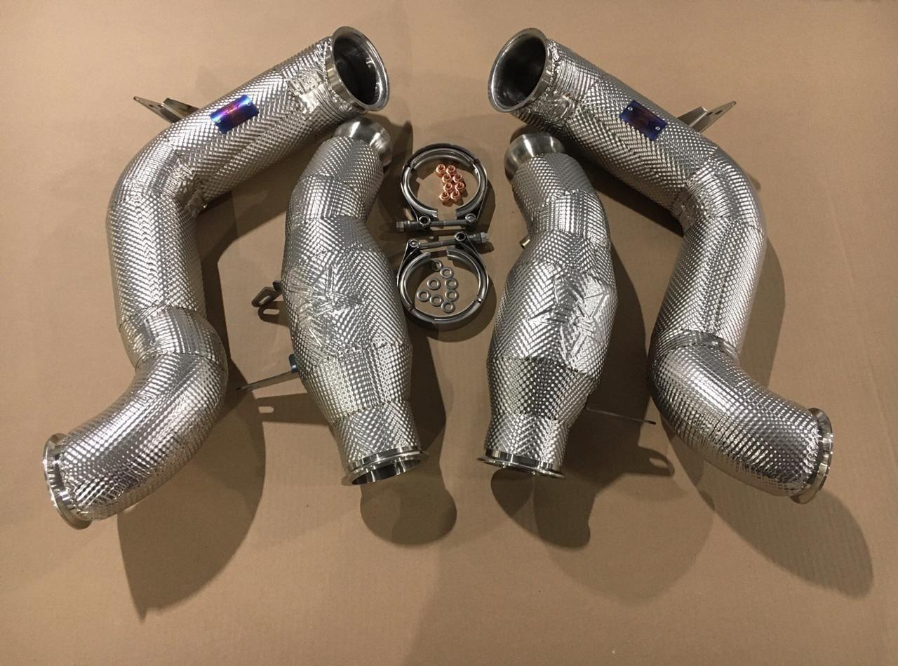

According to BrianShaw23, his Red Star downpipe with 200 cell HJS cat throws CEL, so he had to use Biddaddy spacers to eliminate CEL.
Below is pic of my Red Star downpipe with GESI cats installed at lower section.
I originally ordered the downpipe paired with Red Star's universal O2 spacers thinking that I will get CEL without using spacer.
However, due to limited space down there, my shop couldn't install the O2 spacer + O2 sensors.
They ended up just installing O2 sensors without using spacer and see if CEL comes up.
So far, no CEL after 2 weeks of daily driving and 600 miles.
