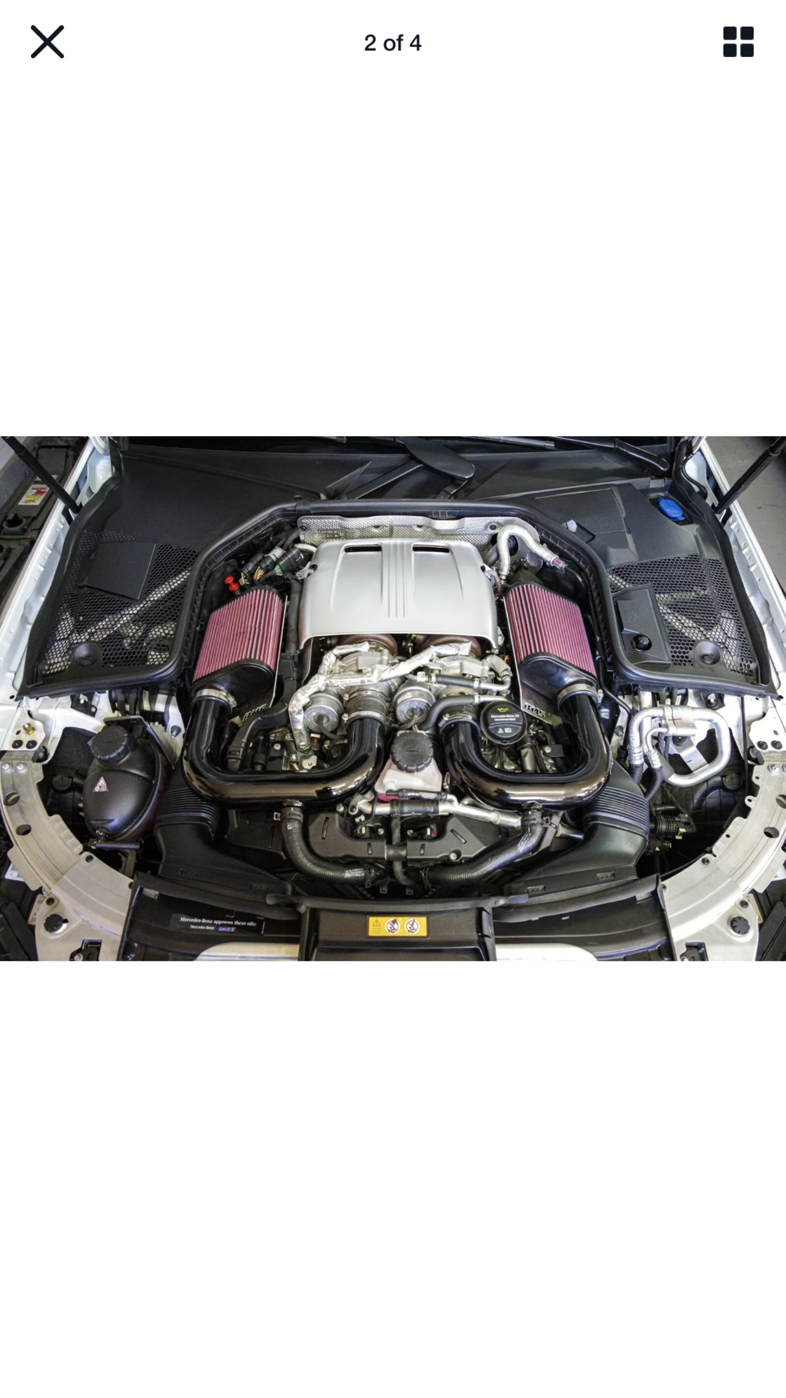

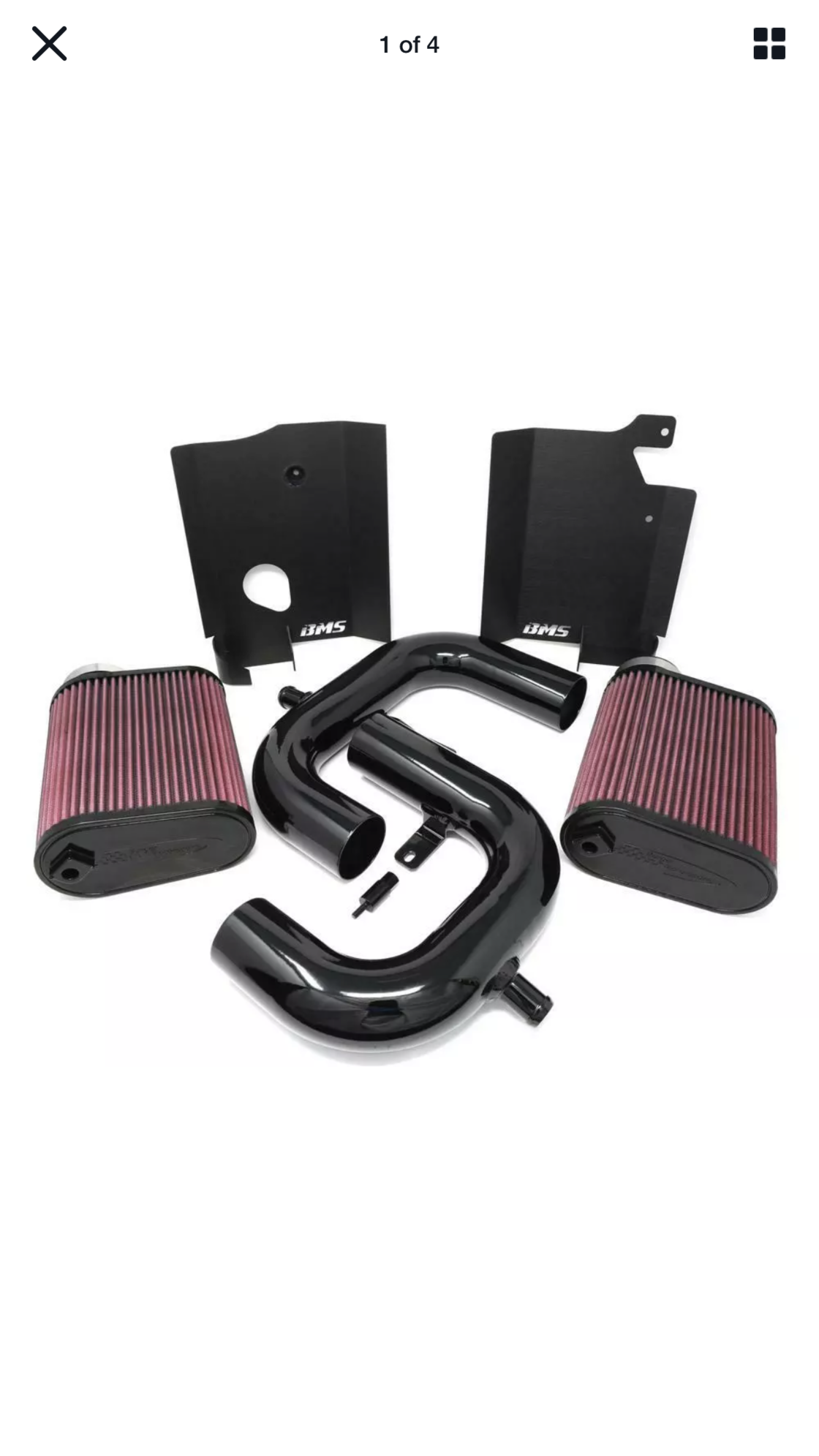

BMS intakes
Firstly, sorry if there is a post for these. I’ve search and couldn’t find one for these In particular. With that said, does anyone have first hand knowledge of how these perform? I like the price over the 2-4K lol but unsure of quality.

We've sold over 150 sets with lots of positive feedback. Sound and look great, nice top end power gains, good price. Can't go wrong.
