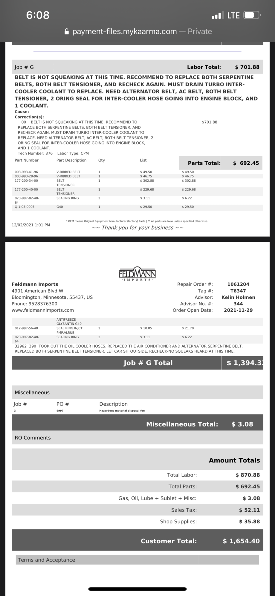

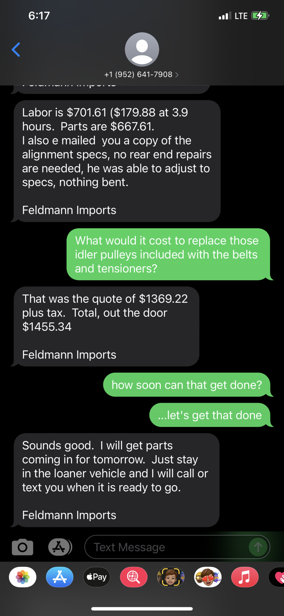

C63 M177 has 2 belts, 2 tensioners, and 3 idler pulleys. I attempted to get my car repaired at a dealership.
Service Manager at Feldmann Imports in Bloomington, MN quoted me a price to complete the job. I took a screenshot of the text message.
Mercedes dealerships have proven to be untrustworthy.
To my surprise they didn't replace the idler pulleys. There is a sound coming from in there, those idler pulleys should have been replaced. These people at Feldmann Imports are incompetent.
(4 wheel alignment was completed as well.)
The other dealership, Sears Imports in Minnetonka, MN tried to convince me that I needed to replace the rear suspension. That is why I had the alignment done at the other dealership- I wanted to verify the claim. It was a lie.
Mercedes dealerships are not to be trusted.
Then here I am, it looks like I'll have to pay another $700 in labor for the same repair. Unless I just do it myself- Which is what I should have done in the first place.
Not only that but Feldmann Imports scratched my car. These dealerships are careless, they don't give a damn about people's cars or anything- They are there to steal from people and that's it.
