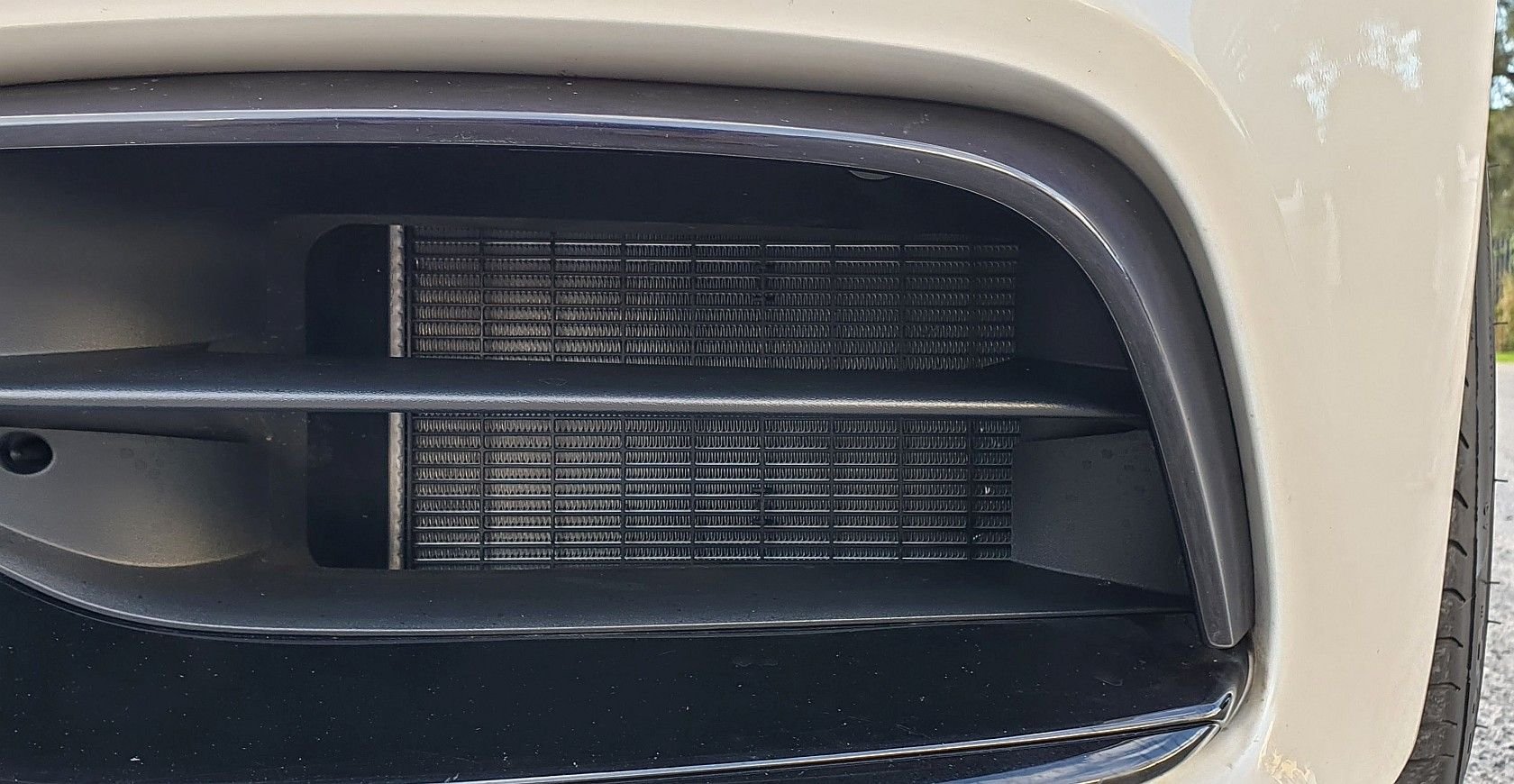

No issues with cooling during hard driving, etc. until my weak little factory coolers decided to both start leaking last week. Just a tick over 3 years of ownership (out of warranty), I wasn't happy. Luckily my AMG mechanic found out when they were doing my facelift conversion.
I've now installed the facelift protection grids as a precaution. There's quite a few threads on here about debris hitting the coolers and causing them to break. And after having a sticky beak, it's actually very common with the C63, AMG GT, E63 and anything with open coolers
I'm really starting to feel that Mercedes-AMG cars are brittle and riddled with issues. I love my car but you will need a small fortune to maintain these things, that's for sure

Originally Posted by FLC63s
I dont think you can blame MB-AMG for inter-cooler issues, , I mean if a rock gets thrown at your windshield it breaks too... :-)
Sorry that's not the same thing.
Aftermarket coolers are promising, true. Personally I wouldn't get one all that logo writing on it. Looks sh*t. But if it does the job, it's cheap and you're happy then why not.
Hey Jimmy...
I have no dog in this fight, I was responding to the OP, and trying to get a grasp on what he was asking..
My G63, C63s and C43 have the same covers for the inter-coolers, and have yet to have a problem with any of them.
I posted a pick of a 3rd party cooler, in the event someones car was running hotter then normal, but the OP, did not give any details on when, what , why the car was running hot.. .. or if he even owns one, and was just posting it as a question, because he heard it on the internet... ??
Thanks for posting up the info on the cooler.
Do you mind me asking, does your Facelift have the cooler protection grilles? I've seen some facelifts without them and just wasn't sure if they all came with them from the factory now?
My c63s is a PFL :-(....
The c43 is a 2020, and has a similar mesh, but my GF is driving it,so cant go take a pic this sec... and of course the G has the same covers as the PFL.
A better pic , with my new splitter on..

I’d never track my C63S without upgraded heat exchangers or something to keep IAT’s in check (like water/meth). Especially here in Texas.
Even stock, the under hood temps can get so hot it melts plastic - ask me how I know...
Heat management is critical if you’re thinking about longevity. Make sure to cool the car down (do some “cool down laps”) before parking so it’s not hot in the garage baking itself and all the electrical components under the hood to death... I’ve also gotten into the habit of popping the hood after a spirited drive to help evacuate the heat in the engine bay.
