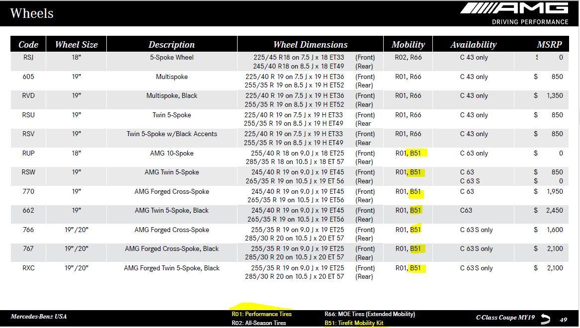

Typical salesman with no clue of what they are talking about. C63 comes with Performance Tires (R01) and the Tirefit Mobility Kit (B51) which consists of a compressor and a can of tire sealant. Should be in your trunk velcroed to the liner. Mine is on the right side. C43 comes with MOE Tires (runflats) (R66). It's all in the DOG.
