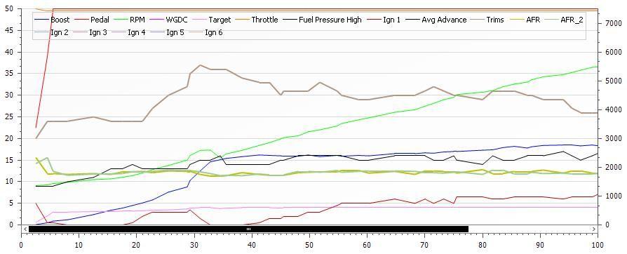

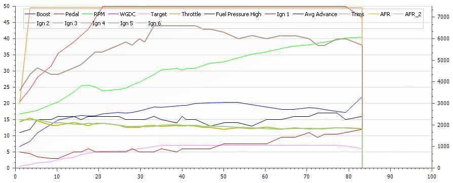

Here is a Base Log on pump 98, no additives. Note the lower boost and less timing.
Within the Logs Ign 1 the reddish line is timing.
