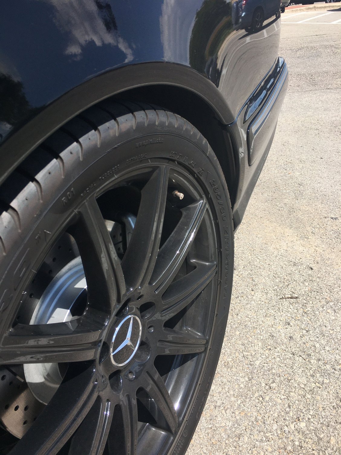

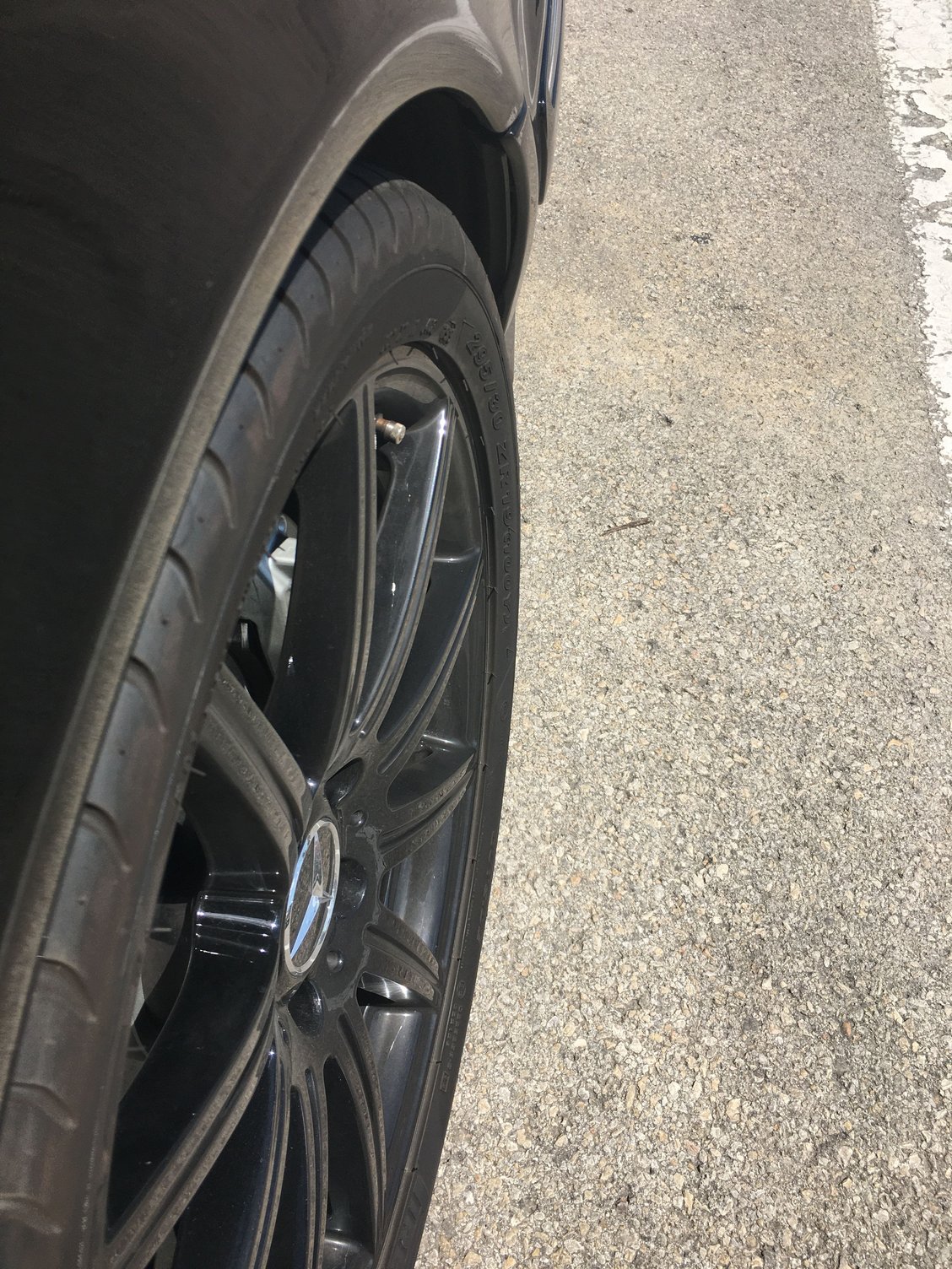

I am running 295s on my 9.5 E63 wheel. I also have the 295 Pzero audi spec. they were almost an inch and a half wider then my 285, pzero. The pzero 285s seem to be a narrow 285.
They do bulge a little, but hook up.
Do you have any pics installed? Curious to see how much bulge there is. I have a set of new 295/30 super sports that I’m debating installing on the 63
I believe those should be more narrow than the p zero

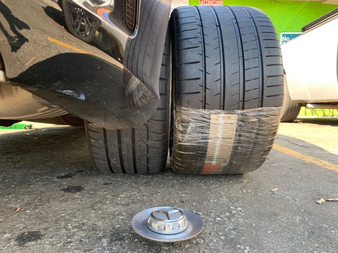

Just got 295 30 19 PSS installed on the rear. Look at the size difference between the Dunlop 265 vs the PSS 295. No rubbing so far but I’m at stock height.
Looks awsome dude! 295 ps4s it is once i 🔥 my pirelli's off. Ohh are you running any spacers ?

Peterk81's Avatar
Joined: Aug 2016
Posts: 71
Likes: 20
From: Los Angeles, CA
16 c63s and 17 C43 AMG, 13 E63 P30
No spacers. The 295s line up with the fender nicely. The bulge is quite pronounced but nothing wrong with that.
Great, how is the traction with those? Bet the car hooks up in 2nd now ;]
