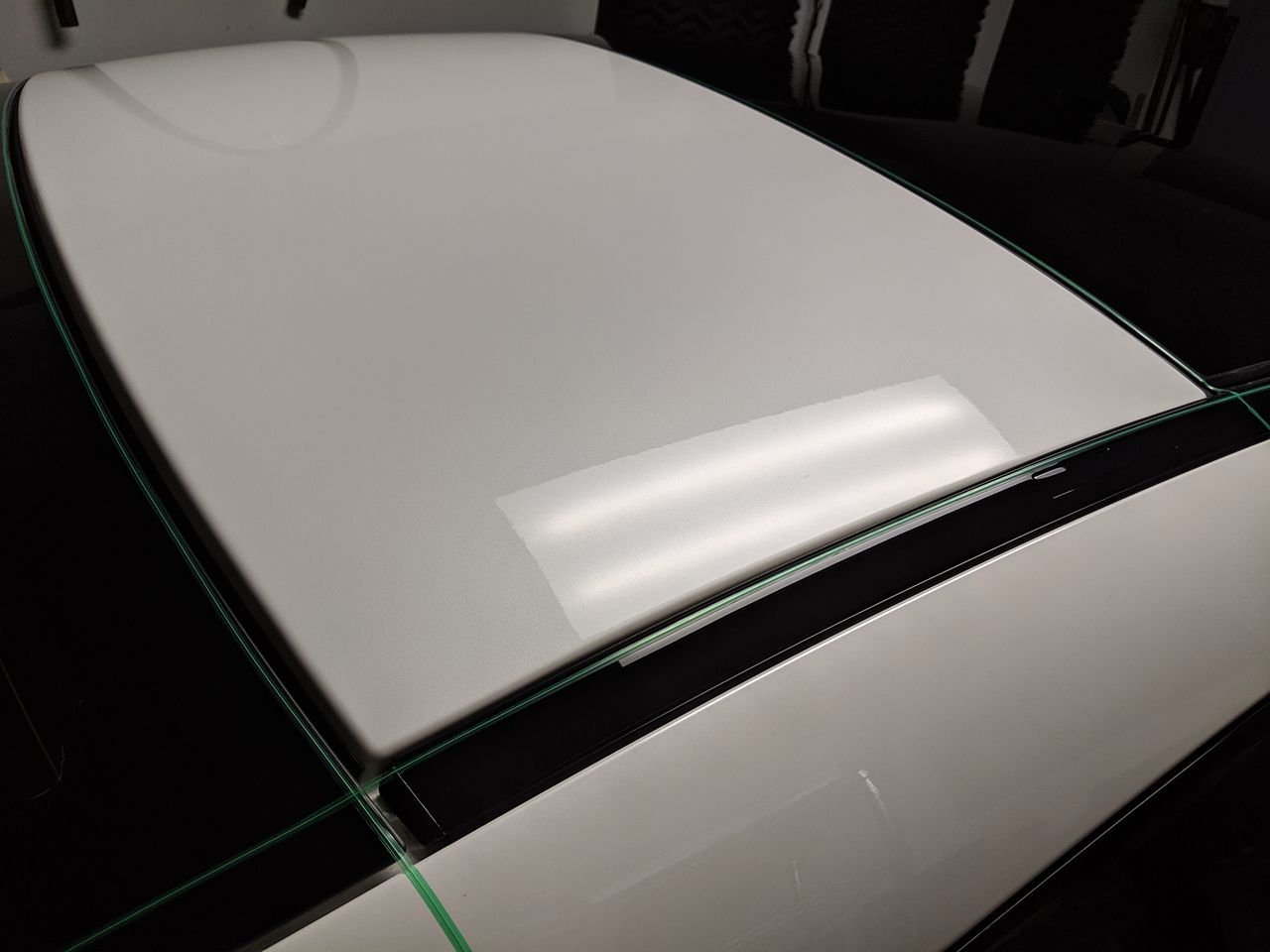

Would like to know this also since I just had some vinyl arrive to wrap the roof. Doesn't look like there is anything under the little roof rack hatch doors that are holding them so must be clips. Will be using knifeless tape to cut. Any tips from anyone that has actually removed them? Thanks.

Yes - Start 4 or so inches from the back and lift straight up. Found that doing it with my hands instead of a tool was the best way. I wrapped my roof without completely removing them so ended up having to unsnap both sides twice because I didnt want to break any clips up front. First time around was to thoroughly clean the rubber and under the rails so I didnt get a bunch of debris on the film and then again to tuck under the stripping after using knifeless tape to cut.
