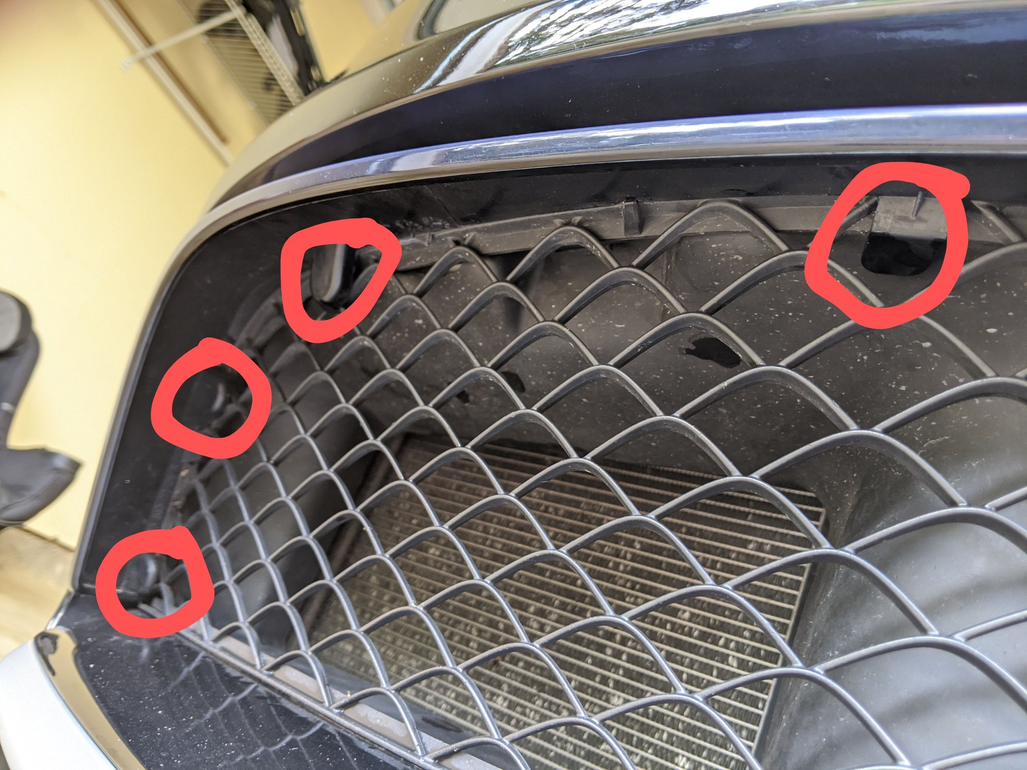

Got the pieces in the mail today. Came with no instructions.
I emailed Mode and they recommend professional installation.
Looks like you need to drop the bumper. The trim pieces are held on by some type of fastener behind the vent grille.

The bumper MUST be removed. Those stock pieces have 4 screws in each piece that you only access after removing the bumper, then removing a big plastic piece with a bunch of clips in it. Once that is removed, you will have access to the screws. It was a pain, but well worth getting rid of the purple plastic pieces. I did the whole euro-spec carbon front end from RW.
