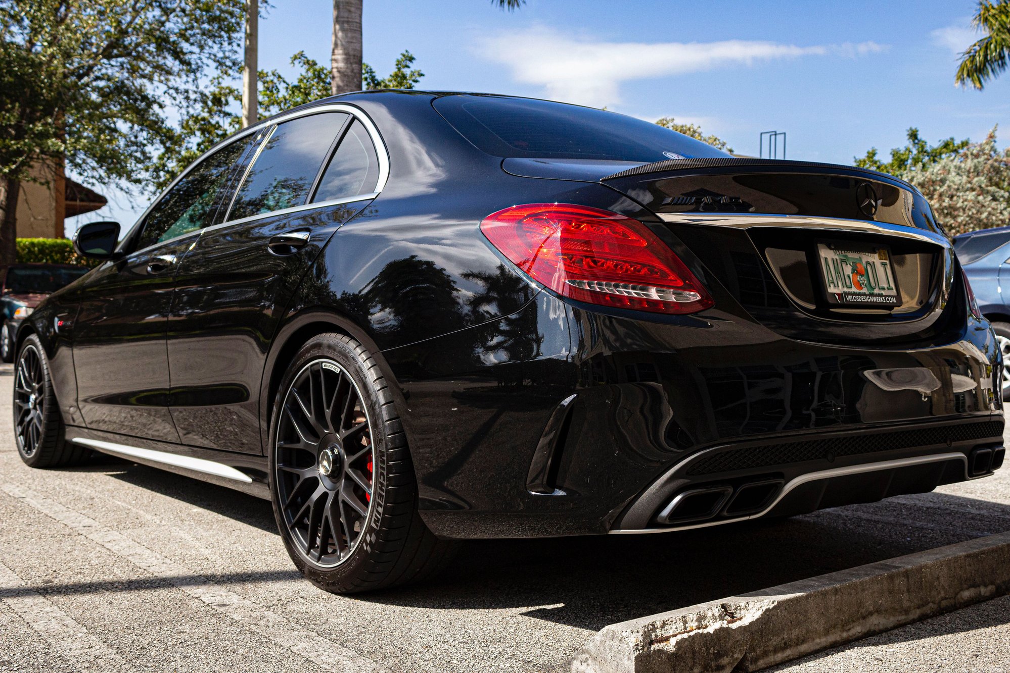

Guys,
So far I'm on track to do the following to the Sedan this year.
1.) Clear bra & Ceramic coating (completed earlier this year)
2.) Black-out badging (completed earlier this year)
3.) Akrapovic exhaust (ordered & being installed in mid-October)
4.) Eventuri air intake (ordered & being installed in early October)
Need some advice on upgrading tires from the stock Pilot Super Sports.
I'm debating between the PS4S and Cup 2 tires. What size tires should I go with in the front and rear? I would like to with 265/35/19's in the front - but I'm not sure what that means for the rear tire... Also do I need new wheels when moving to a much wider tire...
(PS - I know the exhaust & air intake is excessive/expensive - just wasn't ready to jump to the tune, turbos, down-pipes or lowering kit yet. Still kind of nervous about those topics and how they impact the warranty, etc.)
At this point - just trying to understand the tire situation better. Thanks.

The pilot sport 4S tires are superior for daily driving. If this will be a weekend car I would go with the cup2, assuming price difference doesn't matter. Sorry I cannot help you on the specific sizes.
For more power, based on your comments I suugest youcheck out the BMS JB4. It is a piggyback computer, not an ECU tune (which is an advantage in my eyes), only $900, and offers the same power and more flexibility and functionality than an ECU tune.
Since it is not an ECU Flash, a JB4 will not leave a flash record in your ECU code that can be detected by Mercedes, so it is 100% safe to remove and then take car in to dealerships warranty claims, if needed. Also down the road if you decide to do an ECU Flash, JB4 can work in conjunction with it.
Happy modding!
PS - Car looks incredible!

Firstly, nice car I love that color combo!
For OEM wheels on a sedan you can do 255/35/19 and 275/35/19 or 265/35/19 and 285/30/19. You could use the bigger sizes however the tires will look bulky and I wouldn’t recommend it based on the OEM wheel widths. I run a PS4S 255/35/19 and 275/35/19 on my car and it rides amazing. Cup 2 tires don’t handle as well in wet conditions so if this is your daily make sure you take it easy if you go with these and it’s wet out.

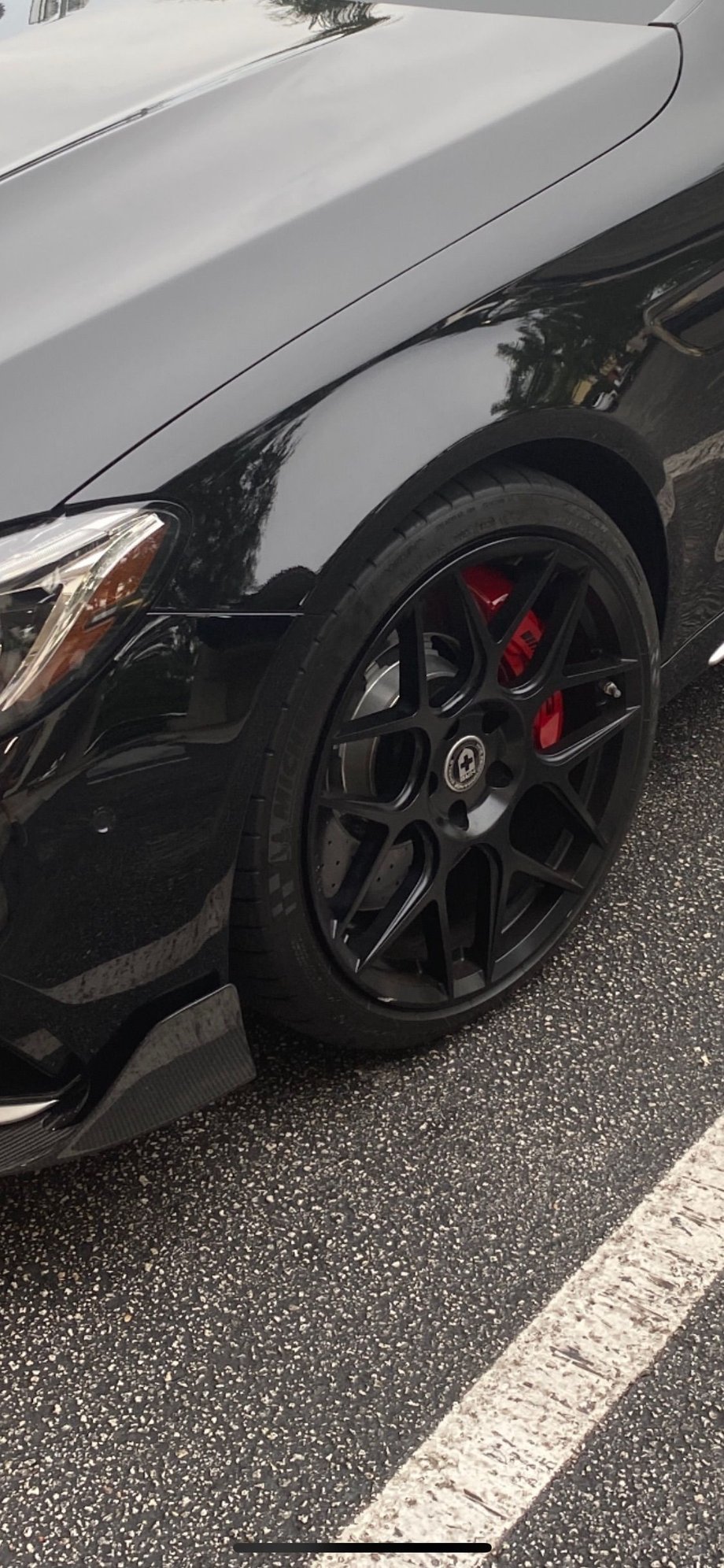

I have HRE’s as well.
