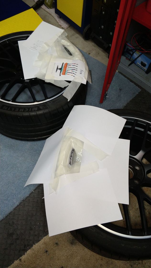

Got my wheels back from refurb, but the silver AMG logo is now black. Has anyone successfully reworked theirs back to silver? Any tips! No I won't go back!

Mask off the AMG logo with bluetape and buy some sand paper i would start with 100 grit and then maybe finish off with a 300 or so. At the end polish and protect with something like this https://www.autozone.com/wash-cleane...B&gclsrc=aw.ds

Thanks, rubbed it down as you say, then masked off and used a clear coat. Wasn't a big job tbh

Awsome! Take some close up pics 👍👍

Nice and dry now. Probably could do with flattening.

Perfect. I actually like how your were black before it looked nice too but then you'd need to match all your wheels

They came out perfect 👌could not tell the difference
