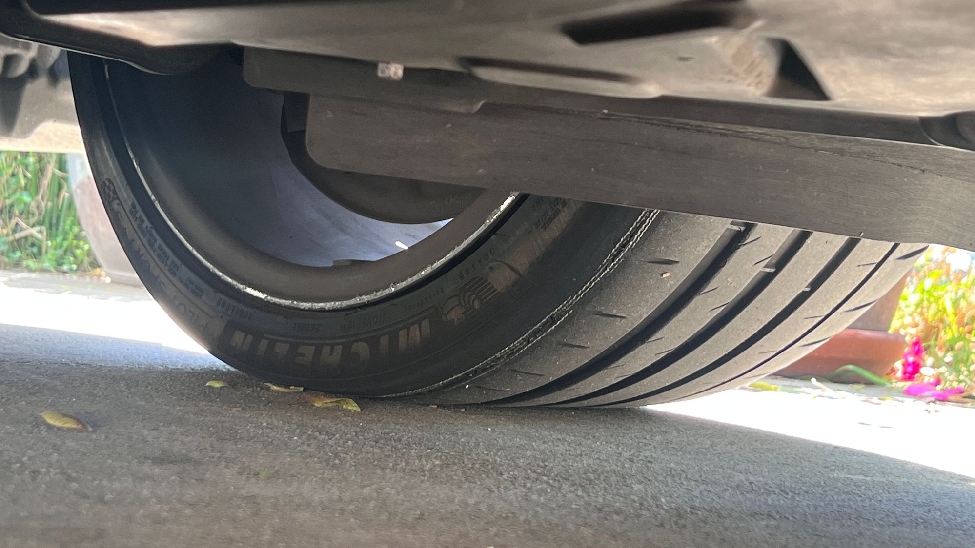

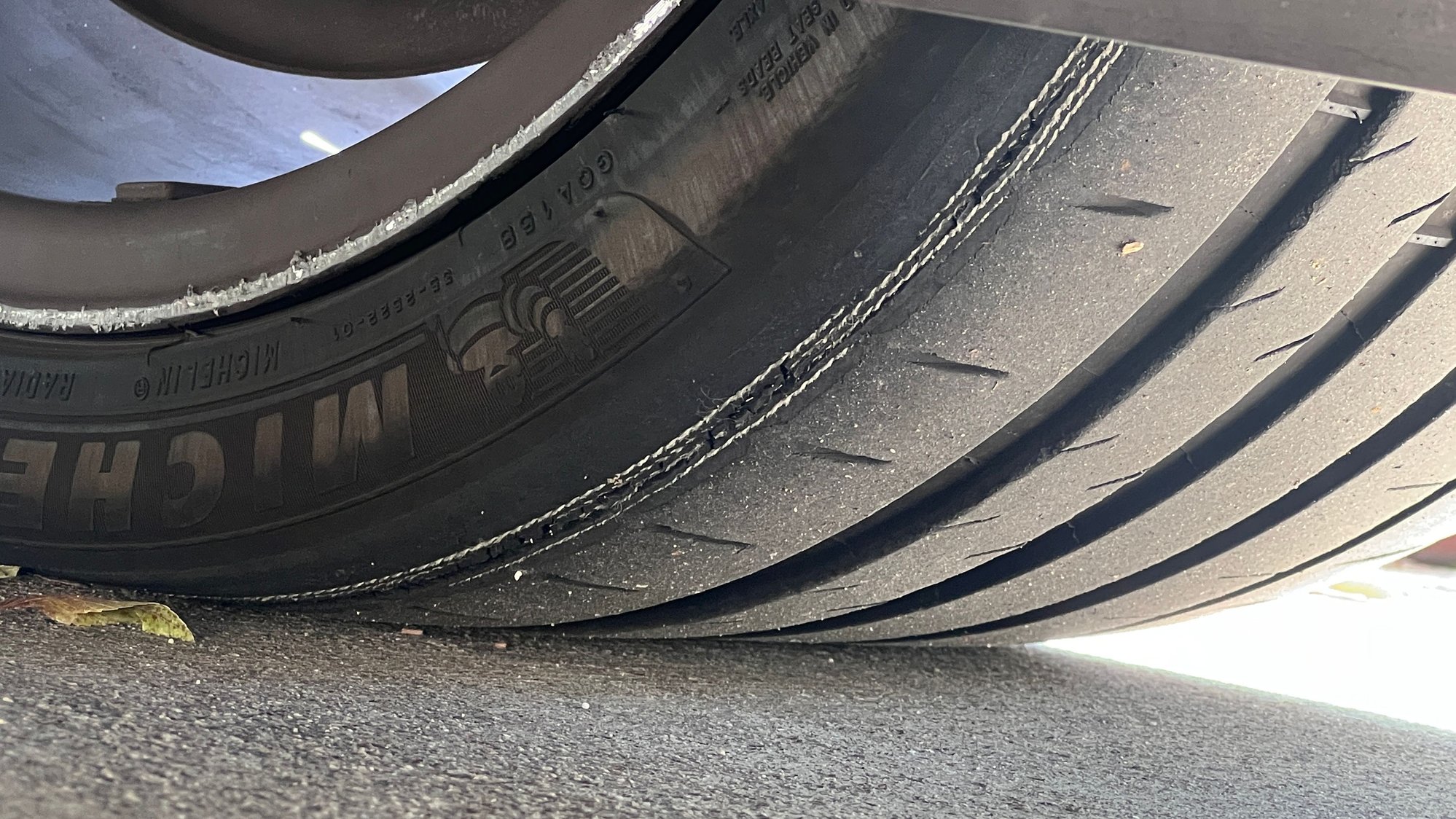

Im getting nasty wear on the inside of my front tires... just purchased Kmac Front camber & caster kit (Kit #503316-K). Sucks stock setup can't be adjusted more to help with this problem.
Great customer service btw if anyone decides to call them directly.
I'm on stock ride height btw.
inside rim damage is from my local carwash... never going back there again. the tire width is too wide for that carwash. Lesson learned!

C63s Coupe
Here are my numbers, before (top) stock suspension and after being lowered on HR springs with 15 mm front and 12 mm rear spacers from supreme power (bottom).
