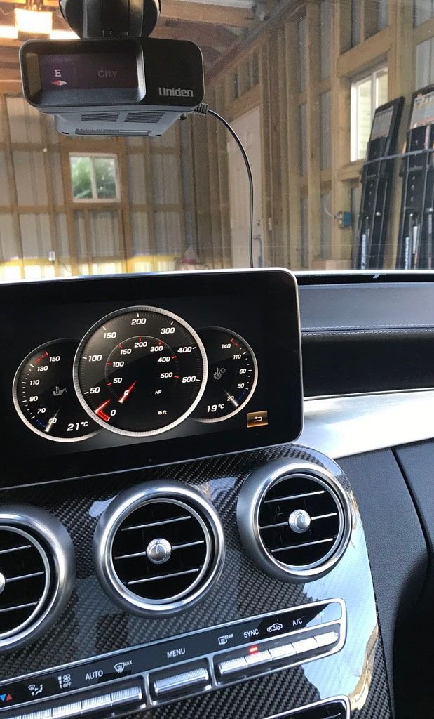

Here's a routing solution that is very easy to do and nearly as hidden as from the mirror mount:
Use a long straight cord with the lighter type plug. Plug it into the rear console power socket.
Push the cord, going forward, into the lower console gap, passenger side where the night light shines out.
Cord travels forward, all the way hidden in the gap until it emerges hidden behind the right side of the info screen. I used a small plastic adhesive wire clip on the rear of the info screen to hold the cord in place.
From there plug it into your radar unit held by suction to the windshield.
The only part of the cord that shows is a couple inches between where it emerges from behind the info screen going the radar unit.
So easy to do. You need a flat cord connection that some brands provide with the radar unit, or it can be purchased on eBay. I used the flat cord that was provided with my old V1 to connect with my Uniden R7 detector.

I think I understand what you mean, but do you have a quick pic to illustrate? Thank you!

Two Pics. 1) From front showing minimal cord exposure. 2) From side showing routing (Yellow line showing where cord runs hidden pushed under console edge and red oval showing area where cord is exposed - note plastic routing clip I used behind the screen and notice where the cord runs to plug into rear of console power outlet.) So easy. I seldom have anyone in my back seat where a foot could bump connection.

Thanks! Does your car have the interior lighting where the yellow line is? My 2020 has the internal glow lights so I can't put the cord through your yellow portion (without plugging the gap where the light comes out from that side). I have other solutions though either way so thanks for the tips!

Not sure how much if any light is blocked by the cord. I never ride as a passenger to experience it.
