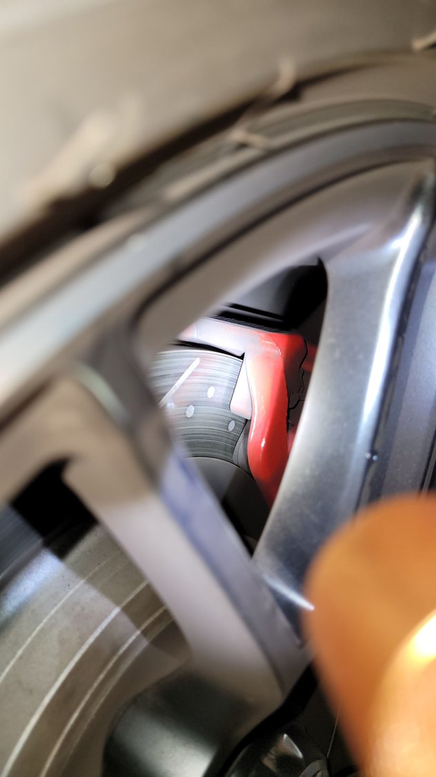

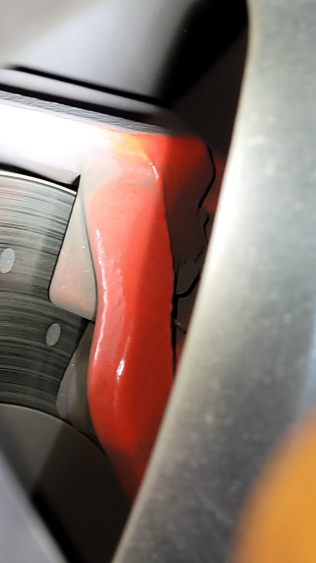

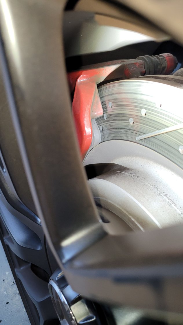

Since we are talking about brakes in this thread, was wondering if you guys can tell me if I need new pads, and also teach me how to check them.
