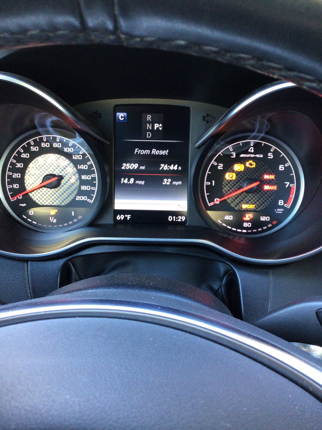

It’s interesting that Mercedes official consumption numbers under Premium Gasoline is 21 combined city/highway MPG 18 city 27 highway but most of us here get much lower figures. I don’t mind to pay to play but Mercedes claim is clearly wrong and a bit deceiving.
It depends how you drive it.
I drive like a bit of a hooligan, always in sport+ mode and I just checked my computer to see what my average is and it said that over the last 2900 miles driven I averaged 14.8 mpg... which is actually worse than I thought but not really surprising.

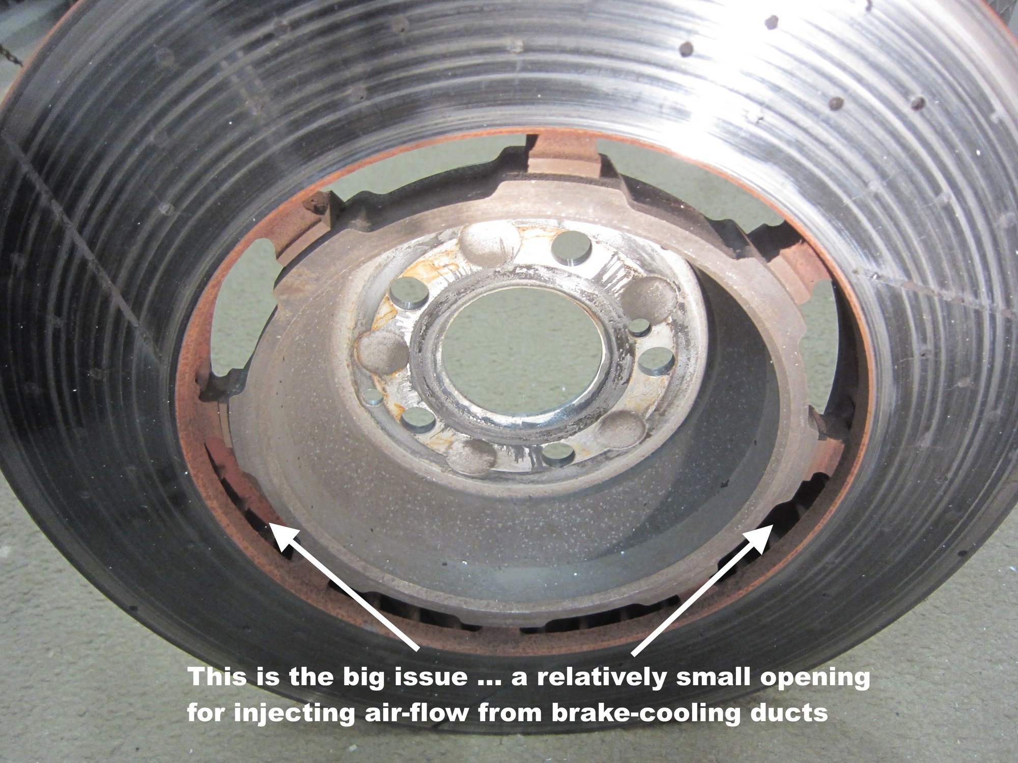

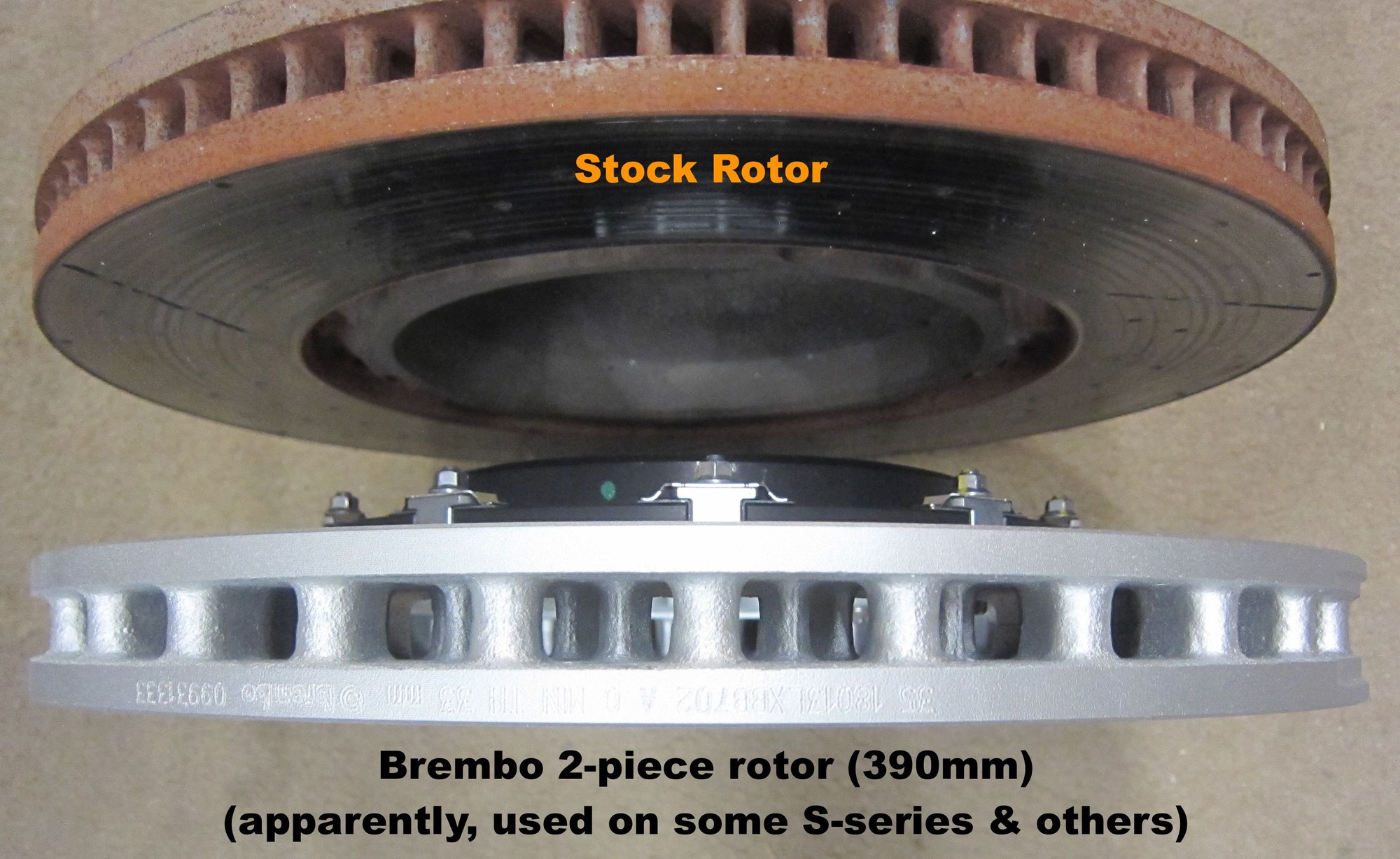

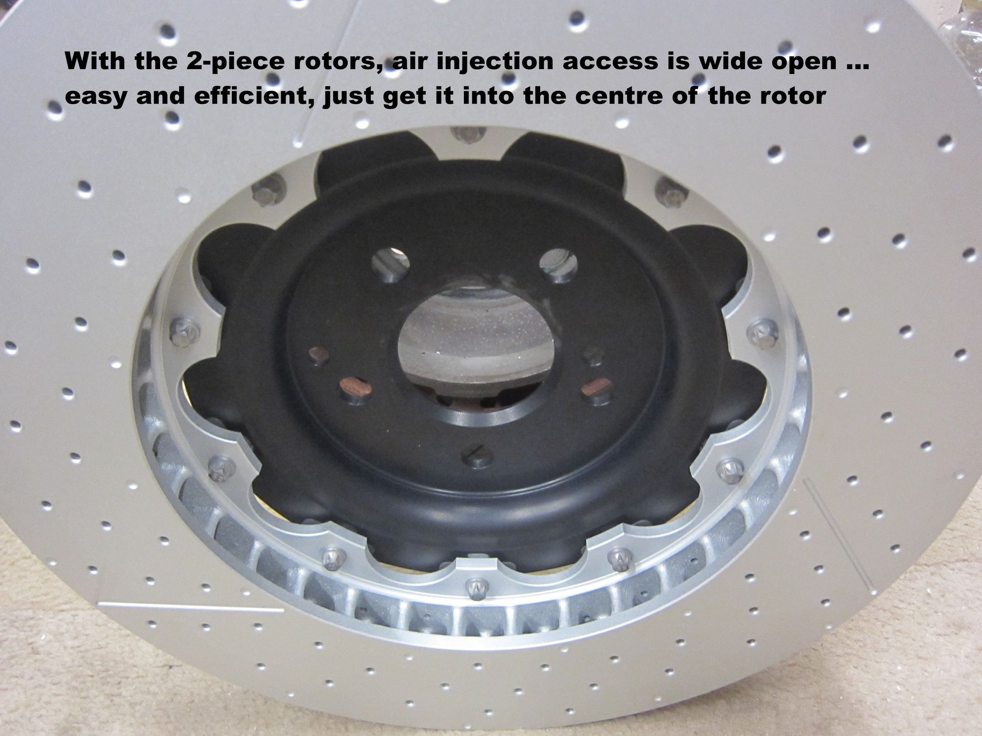

2-piece front rotors (C63 S and others): https://www.fcpeuro.com/products/mer...mbo-2304211212
I change my brake fluid once per year and use a Motive brake bleeder to help with the process. I believe Castrol SRF has the best specs but, at times, it can be difficult to get and I've used Motul 660 and not had any issues (and our local-area track is brutal on brakes!).
I also added some brake-cooling ducts and have moved to EBC RP-X pads on the fronts and EBC Blue Stuff pads on the rears.
FYI, here's why the 2-piece rotors run cooler, especially with brake-cooling ducts (up to 200 deg C cooler with ducts, compred to stock rotors with ducts):
Stock rotor-face bridges are smaller but look like they'll restrict more air flow
