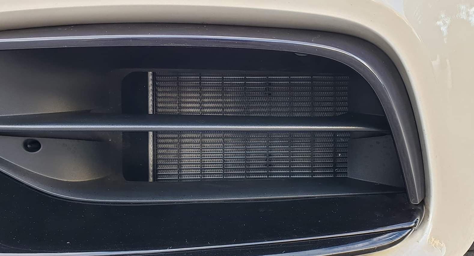

Hmm I am not too sure then. Here is a picture of mine, and there are the black meshes that Jimmy_63 was referring to. I'd try to speaking with your SA and see if they can add this to you for free.
Yes I will take a look at that. Either way, once these are bought just wondering if anyone knows to install it?

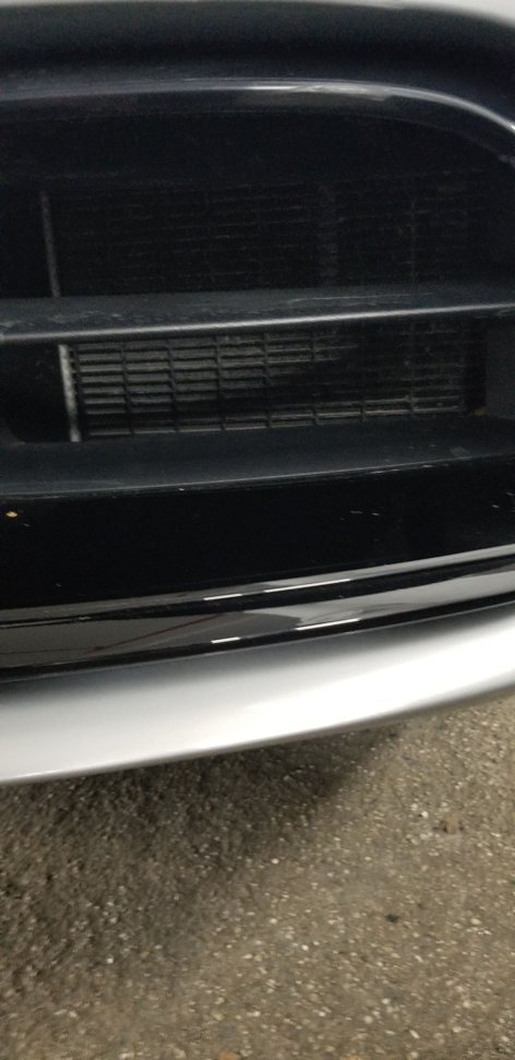

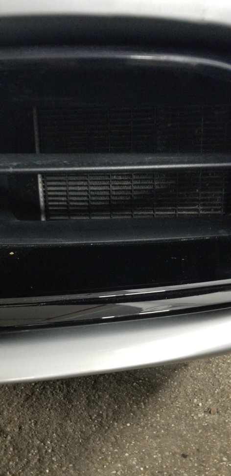

Are these the needed both sided Protective mess on my 2019 C63s coupe? Just took photos?
