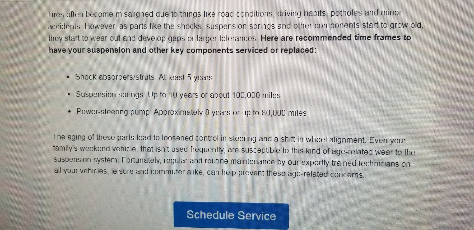

Feb 1, 2021 | 05:46 PM
I get email Specials from one of the local MB Dealership, my C63s coupe is a 2019 with just over 12,000 miles so this email will not apply to me, but this one I received today may help you as it address recommended time frames for suspension and other key components that need to be serviced or replaced. See /attachment/photo.

Feb 2, 2021 | 04:16 PM
Quote: I get email Specials from one of the local MB Dealership, ...
This smacks of "fear-based"/FUD marketing strategies, which I find offensive.
WRT alignment ... relative to your driving habits, is your tire wear uneven and/or excessive?
WRT shocks ... do the simple "push car body down -- is the rebound dampened" test (compare to new car in showroom, if you're in doubt) and the "is the ride still firm/controlled or is it getting 'floaty'" monitoring.
WRT power steering pump ... WTF, not even present in cars with electric-motor steering.
