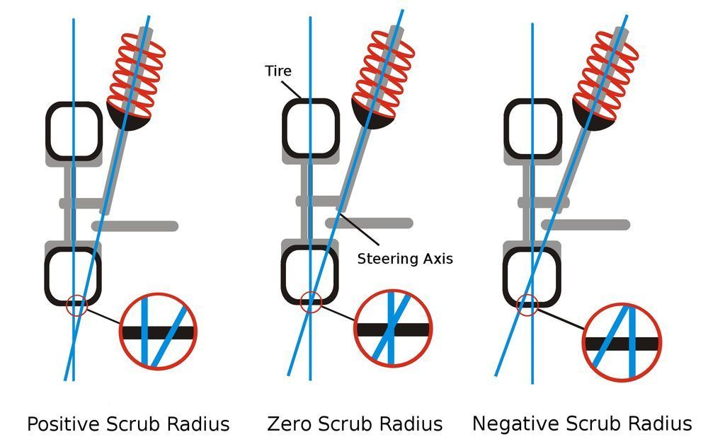

Scrub is a different animal, but it factors in. Generally not a good idea to put spacers or cheap aftermarket wheels on a car because it increases the scrub radius beyond what the suspension geometry was designed for.
