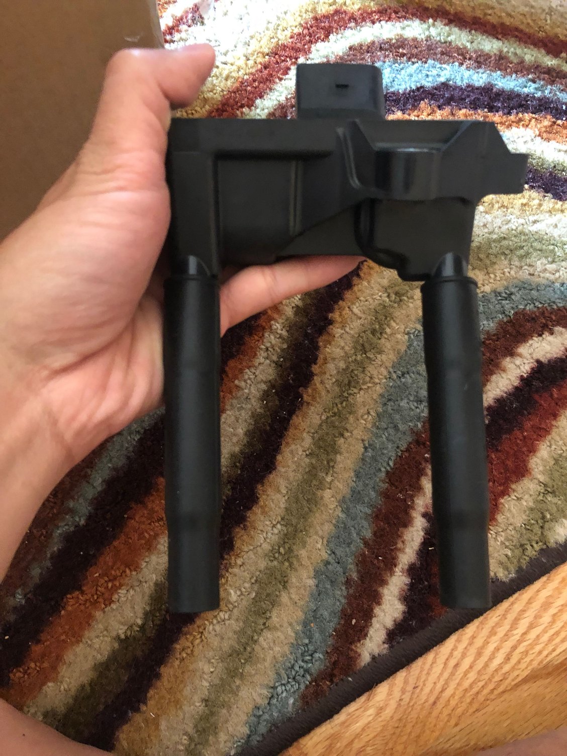

Excuse my dumb questions. I decided to replace these hks sparks with new ignition coils. I would need only 4 of these ignition coils and not 8 coils, correct? For spark plugs index is that something I need to let the mechanic know?

correct you only need 4 coils.
yes a decent mechanic should be able to index the new plugs with “ spark plug indexing washers” these are copper washers of different thicknesses to make sure the plug has the correct orientation when torqued to 23NM
