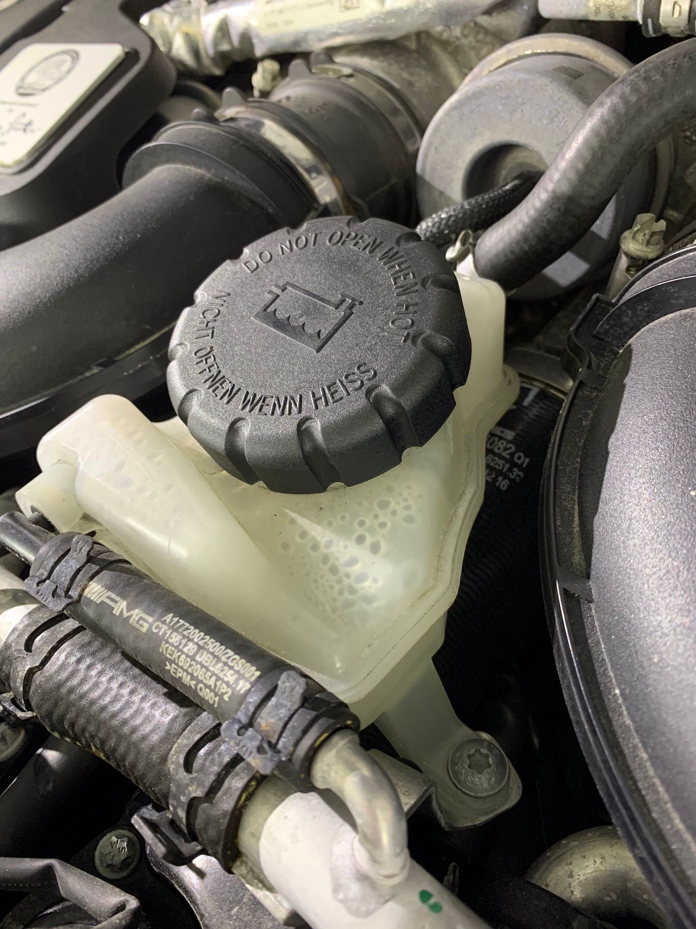

I just took possession of a c63s and am wondering about the level of the turbo coolant.
This seems low to me, I added (about 100ml to reach the level of the jar), as soon as the engine is running, what I have just added "disappears" and it is again "empty"
I know he has a second jar (which I don't see) which must be full, I imagine because there is no warning on the dashboard.
My question is: is your jar full or empty?
Thanks for your answers

yes, of course i've fill up while engine was cold, but what should be the normal level in that reservoir ? any picture ?
Old May 13, 2021 | 10:59 AM
FLC63s's Avatar
Joined: Jun 2019
Posts: 1,453
Likes: 399
From: Flat Earth
AMG C63s Sedan , AMG C43 , AMG G63 , GLK 250
Should be about to the line, but I would check the MAIN first, since if this one keeps going low, then .....
Here is a pic of mine :

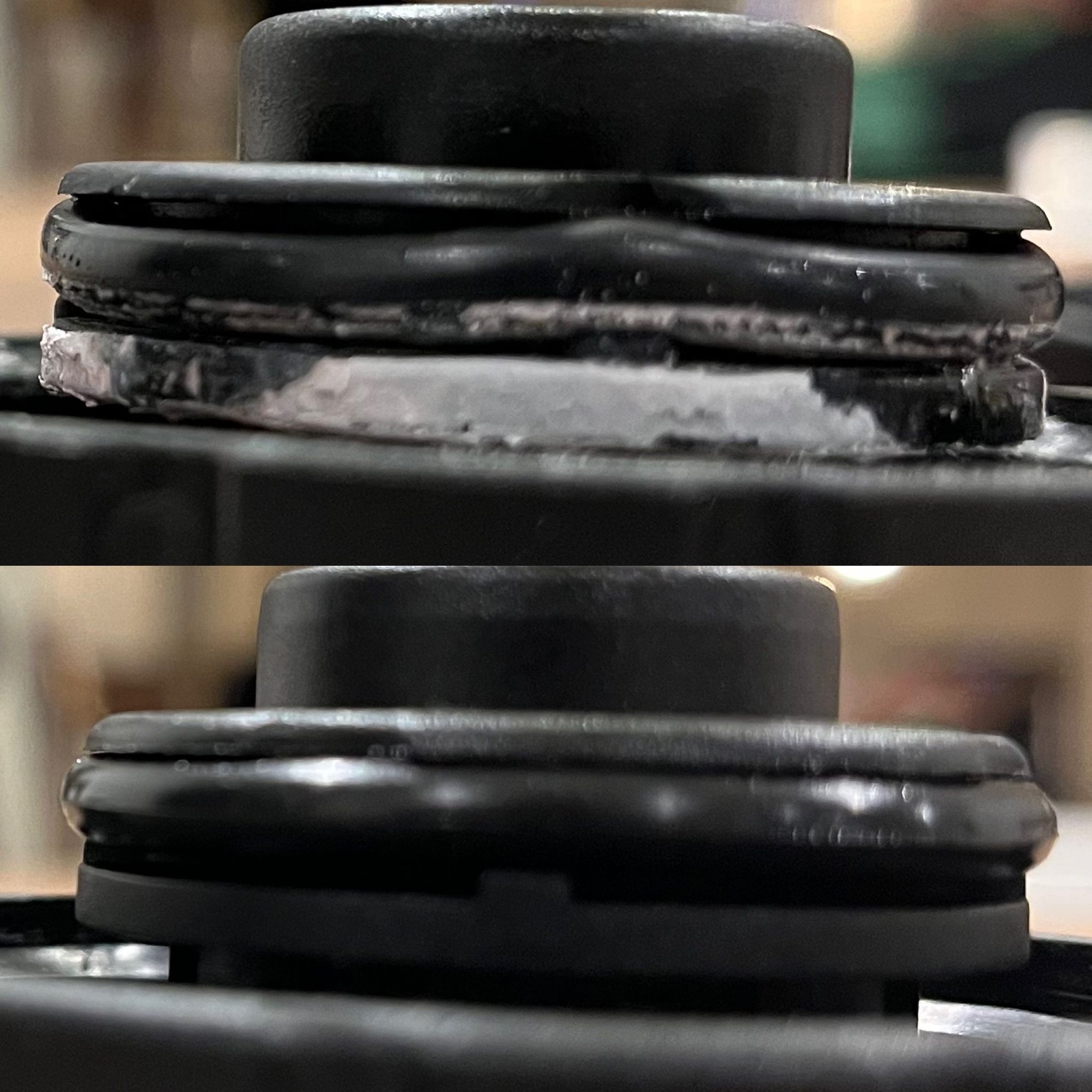

Just replaced my expansion tank cap.
Coolant was leaking around the tank, leaving it stained, and I could smell coolant after more heated runs.
let’s see how the new mahle part holds up (FCP)
