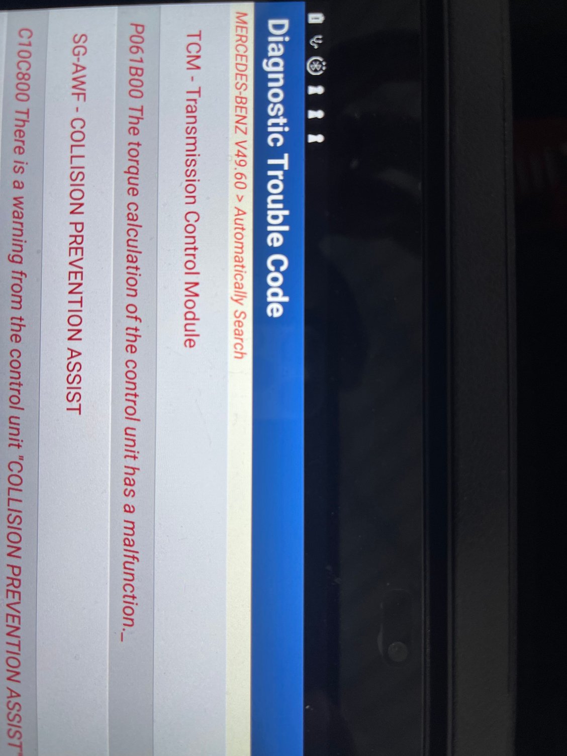

Hi all i have a w205 c63s my current modes are
BMS intake
Fi downpipes
Water methanol 70-30
E50
2 step colder NGK
Weistic pov
Spool HPFP
Turbosystems stage 2
currently my ECU and TCU is tuned by EC i am facing a problem with is throttle closer and showing TCU error which is code P061B00 “the torque calculation of the control unit has malfunction” the car does not go to limp mode but its not putting all it power my current dragy 100-200 is 6.2 which my car with this set-up should go in figure around 4 seconds any idea how to solve this problem and is it ECU or TCU tune problem or mechanical problem. Please provide your feedback

Do you have access to xentry to monitor the torque reporting to the trans ?
I had a tune once where the torque reporting to the TCU from the ECU was off and it was causing the transmission to do some weird **** , I only figured it out with xentry and then my tuner changed the coding and it was good after that.
What are you data logging with ?

i am loging with HP tuner

Had these codes with my car and kirklandhans tuned the torque calculations maps until they did not come up.
