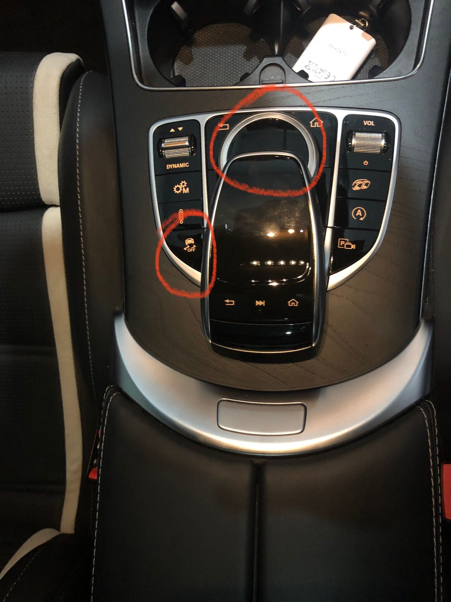

Found the Dealer Menu! C63S 2019+
Step 1. Press the start button.
Step 2. On the MBUX System select Car Settings (Second last from the right).
Step 3. Hold the 2 buttons shown in the photo.
There is also the Workshop Menu available through the Trip Computer section. Which I can explain if anyone wants to know.
Does anyone know of any other hidden menus?

Whatever you do, don't hit system reset in that menu.... no, this is not reverse psychology, seriously don't do it. It is a hard reset, it erases all the sensor calibration data, your car essentially "forgets" most of the things, doesn't know it has blind spot sensors, radar sensors, doesn't know it has cameras .... anyways it is a mess so don't do it. Most ADAS will cease to function. Ambient lighting and even your speakers won't work. If your car has ILS, that function is gone as well.

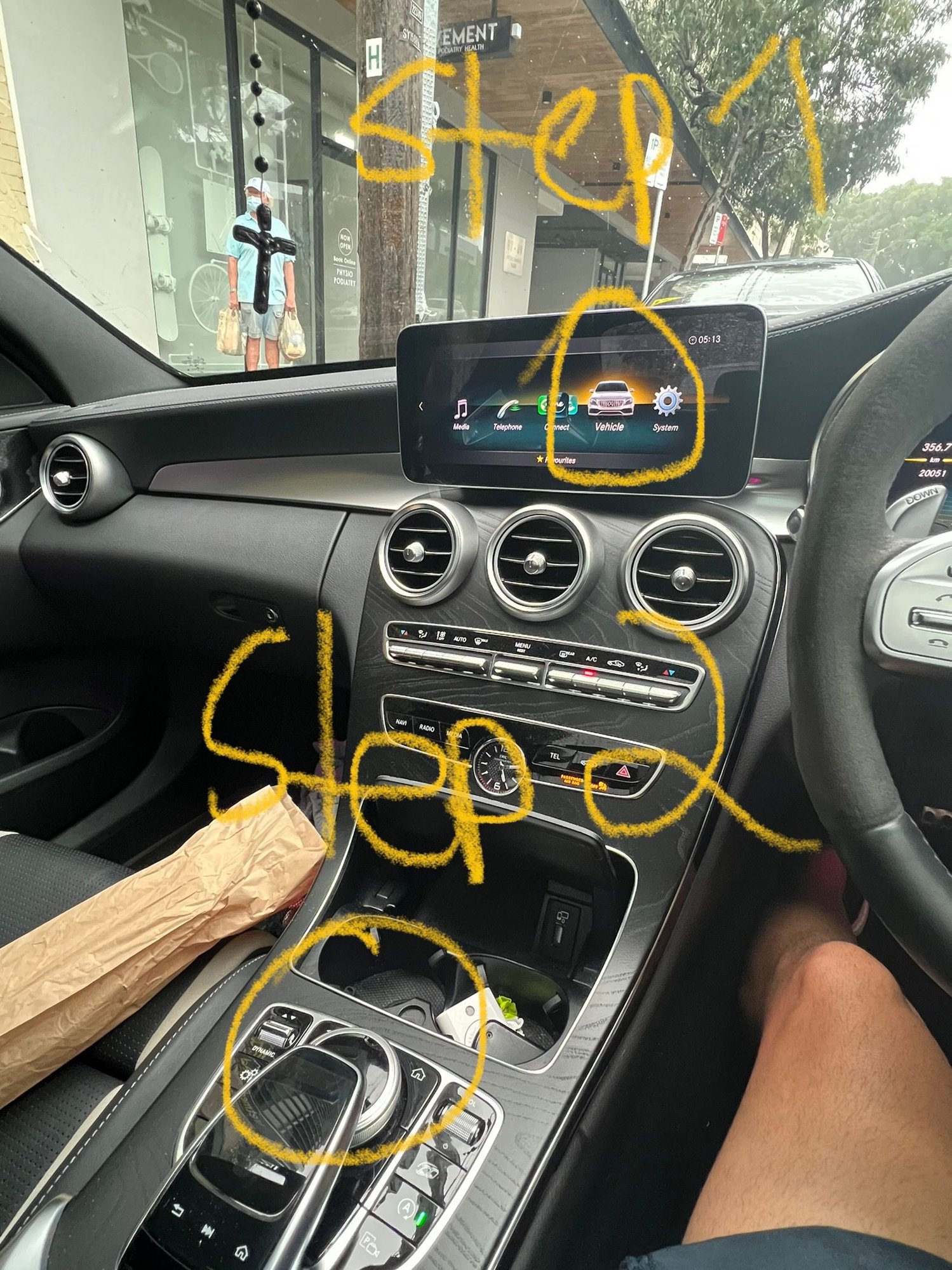

Step 1 put it on thi setting.
Step 2 Press and Hold this button until it comes up.
Easy.
There must be another hidden menu to adjust things. Like a proper one like in the Audi. I've discovered this one by accident but the other menu through the trip I looked up.
