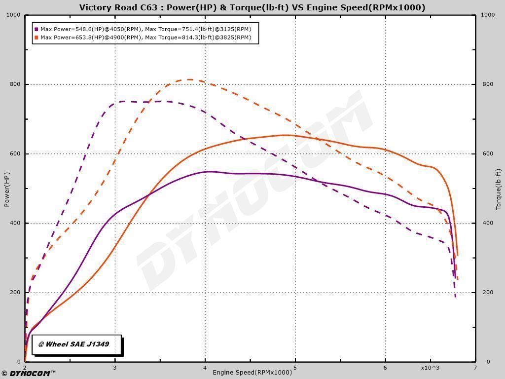

Our Stage 1 features a billet compressor wheel and here are the results from our run
Before Turbos:
  • 548.6 WHP
  • 751.4 WTQ
Supporting mods: VRP Downpipes, AFE Filters, VRP heat exchangers, VRP methanol injection, and VRP tune.
VRP900 Turbos:
  • 653.8 WHP
  • 814.3 WTQ
SPECS:
Compressor Wheel Side:
  • Exducer – 73mm
  • Inducer – 47mm

Not a negative criticism….the dyno graph displayed shows exactly my point on the factory housing turbo upgrades. A huge “punchy” torque spike which makes the car a handful in certain acceleration situations, not fun when unexpected, as well as they still run out of breath up top.
The larger housing turbos will still be climbing in power delivery at redline, and not have that huge torque punch / spike low in RPM range of which can cause lots of wheel spin or you having to climb all over the steering wheel to keep it focused and not step out on you.

I would have expected a bigger turbo to have an even bigger and more sudden torque wave due to the extra time taken to spool up flatters the bottom end response......then it comes in hard. Fast response is why they fit smaller blowers in the first place and on the street that what I would prefer....high torque at low revs. On the dyno chart above even with stock housing torque has been sacrificed sub 3250 revs....exactly where a street car needs it.....I would not want to lose more at the bottom to gain unusable power at the top by going bigger on the turbo......Race car? (as in drag drip not race circuit where you still need the low punch!).....of course that a different set of requirements!

That is tuned that way for a reason. You will bend rods and blow your engine if you allow max torque sub 3000 rpms.there is huge stress on the pistons making 900ftbs at 2400 rpms
here is a car that you would love on the street but guess what? That thing blew up lol but man the low end must of felt nice.
