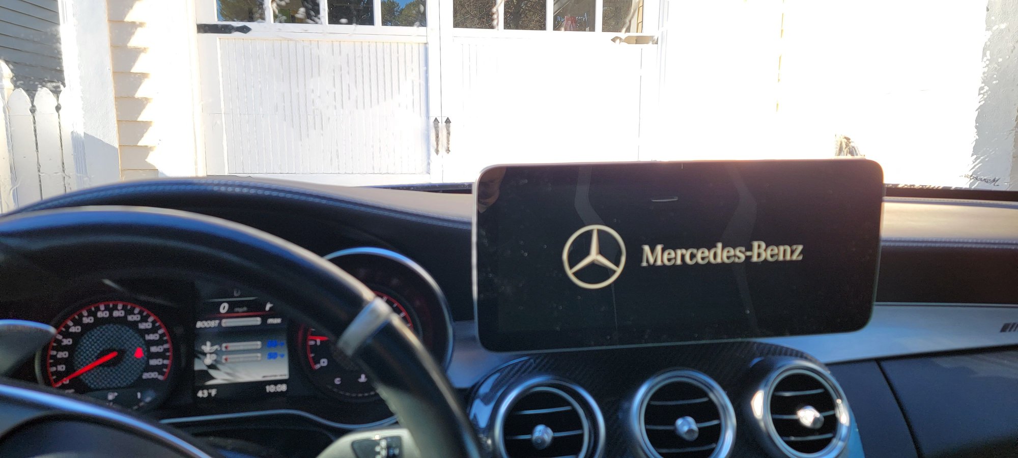

I just changed out the whole screen to a 12.5 touch screen thats andriod based but does Apple carplay also. Love it. Can now have waze up and running whilst driving. Also can watch movies too.
I was gojng to do this but I'm not so sure I don't like have andriod as their clunky and two systems will be confusing to use, I do like the screen size and the ability to use waze.

Originally Posted by japamg
I had one of those, did not work for me. Something was off…
I would update oem or fully upgrade
Most cannot be just "updated for carplay , if they came without, and more so on the PFL"
That sucks that yours was "off" or had a gremlin , I know over 20 people that have the Road Top, and it works flawless, not sure why everything thinks you have to plug your phones in with cable <- because you dont !
Now, these units are mass produced,and of course QA issues arise , but the support I got from Road Top when I asked for the firmware updates was always same day, and they send me what I needed.
(updated my devices to current iOS, and saw that waze was lagging a few seconds longer to load, so I asked and they had an update)
Very simple to install update and onward we go.
