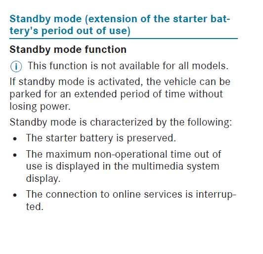

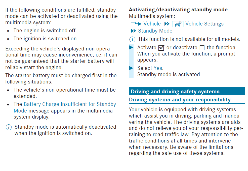

As discussed on previous threads, these cars don't completely shut down when parked. They stay online and keep certain telematics functions up so that you can remote start/lock/unlock from the app, check the status of the car on the app, and get alerts such as when the battery is low. This obviously drains the battery over time. Just like if you let your cellphone sit it will eventually run out of battery just from keeping the connection to the network. The critical battery warning is very conservative. It still has plenty of juice at that point to start the engine, but it will slowly start shutting down other unnecessary consumers like keyless go etc. to preserve enough battery charge to start the engine. AGM batteries also take longer to charge, so if the charge is low it may take a very long drive to get it charged again or hooking it up to a trickle charger will do the trick.
However, if your car sits parked for a very long time, you should take advantage of the standby mode to power everything down. It will also tell you how long you can leave the car parked before the battery runs out.
