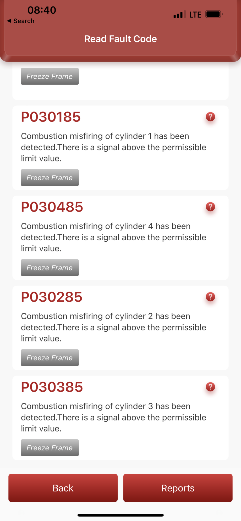

Hi all, first off I'd like to say yes I've searched, and this forum has provided lots of useful info in the past, but can't find the answer to my specific problem this time, and secondly I WILL PROMISE to update you all when I finally find the faults that is bugging the life out of me so that it helps anyone else with the same issue in future...
Now My Problem, please help if you can:- The car is a stock 2017 C63 AMG with roughly 20k miles. I recently noticed that cylinders 1, 2, 3, 4 from bank 1 misfires.
I started by replacing the all spark plugs for all 8 cylinders, ignition coils and eventually Fuel injector (nozzle), i took off the air cleaners, disconnected the o2 sensors, it still complained misfires from the same bank 1....
When I drove it, to my surprise it drives well till I push it above 5000rpm, I got back the shaking got worse and put an icarsoft MBII scanner on it, and it showed the following codes:-
'Random Misfire'
'Misfire Cylinder 1 Detected'
'Misfire Cylinder 2 Detected'
'Misfire Cylinder 4 Detected'
'Misfire Cylinder 3 Detected'
Please note, all of these misfires are on bank 1 only (the right hand bank).
Since the fault only occured on the right hand bank, I decided to swap everything (in stages) i.e. Fuel injectors, coil packs, etc from right to left , to see if the fault moves, but the fault is STILL on the right hand bank.
Below is a list of things I have tried so far, and I am at a complete loss, so if you can come up with any help, it would be greatly appreciated:-
1) New spark plugs
2) Fuel Injectors swapped from between bank 1 and bank 2
3) Coil packs swapped from between bank 1 and bank 2
4) Ran car with Mass Air Meters and 02 sensor disconnected, made no difference
I am out of ideas at this point.
Thanks in advance for your help.

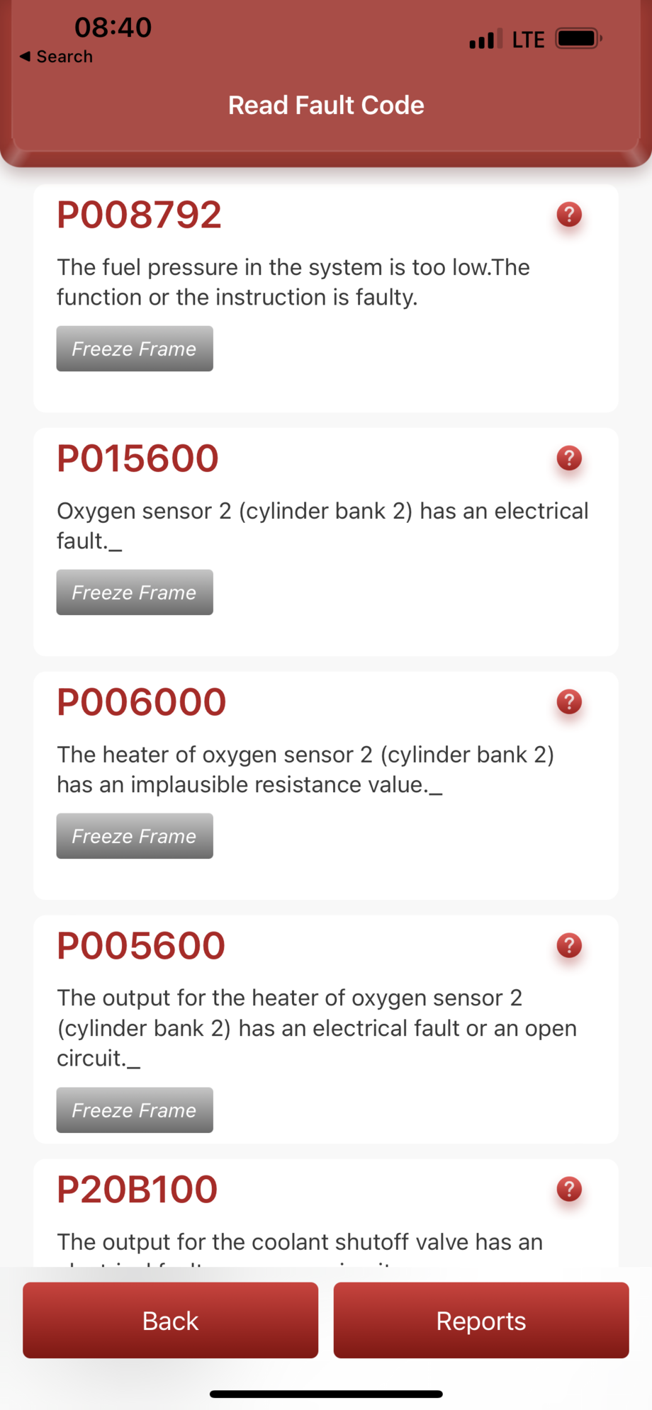

Hi, sorry it’s been a while I updated this thread. After trying so many things I’m left with this error codes
At the top I have a “P008792” error code and I don’t know what exactly I’m to do. I don’t want to throw parts at it. Is anyone familiar with this code?

You need XENTRY, or someone who has it. Display of a code does not give sufficient information.
XENTRY allows you to see all current values of sensors and actuators, temperatures, pressures, etc. While idling and while driving. It's the dealer level diagnostic system.
Take it to a dealer or indy who can do a quick test and who will dig into the fuel and engine ECUs in XENTRY. It will cost you an hour or two of Dx time.

It's odd that you are having bank 1 misfires but the oxygen sensors with the codes are on bank 2. I still think it's possible that you're having a fuel delivery issue with bank 1 given the fuel pressure code, and some other issue going on with the O2 sensor.
I would agree with the above and take it to a dealer or independent shop that can do a deeper dive into the systems to diagnose the issue.
