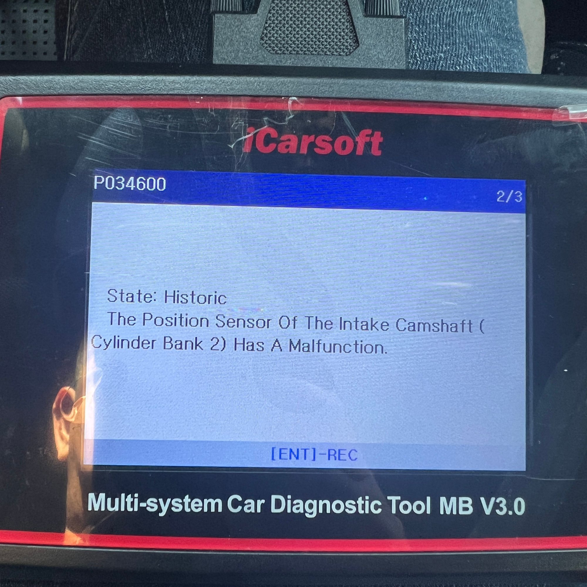

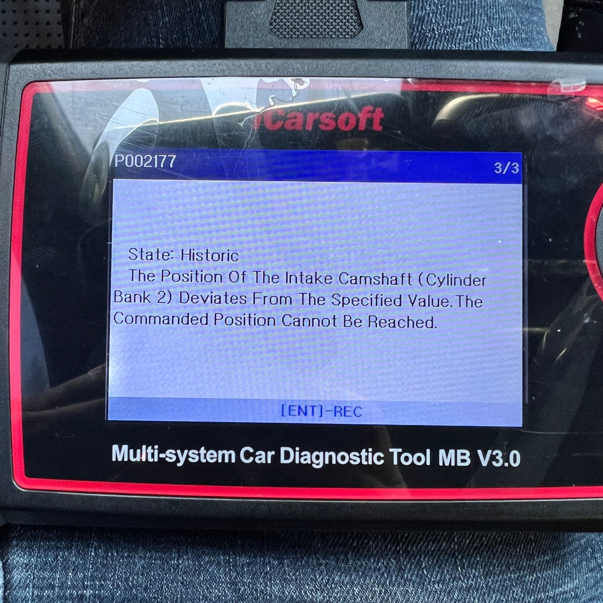

Check engine light on..
Scanned and these 2 codes came up:
P034600 - position sensor (intake cam bank 2)
P002177 - position of camshaft deviates from value blah blah..
anyone else had these 2 beauties pop up?
I’ll be ordering a new sensor today.
read a couple issues that other engines had but not getting any symptoms like they had that required replacing of intake came actuator sprocket.
hopefully it’s just the sensor

Originally Posted by n0mad17
Did you ever figure this out?
just saw this.
looks like it’s the camshaft sprocket. Same issues that the m156 has

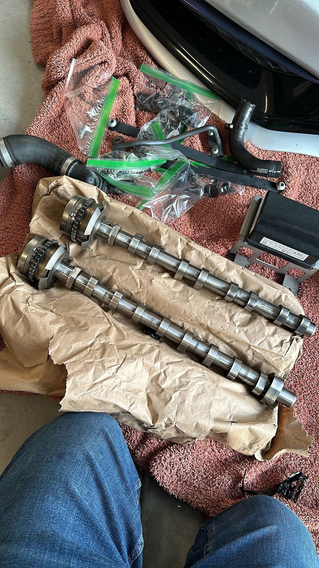

Alright after months of not doing anything im doing something now.. lol
As always i'll need some help along the way if theres any mercedes techs that can chime in on some removal tips or send me some sweet wis pdf sheets thatll be helpful.
I scanned the car today and I was checking the camshaft values to see which cam sprocket was having the issue. after a couple min. of seeing the values at 3,000rpm-3500rpm turning of and on the actuators it turned out that the LEFT INTAKE sprocket is the culprit here. It's stuck at 35 degrees.
Needless to say I need ro get this thing fixed since i've missed over a year of some sweet track time.

I had the donor parts for over 8 months already so looks like ill just be taking the cam sprocket out of one since both exhaust and intake share the same part number*
