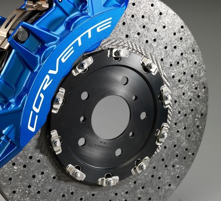

IME, the Brembo rotors and other products they make have been consistently high quality and well engineered. Below is a pic of the *really* nice for its day Brembo caliper and rotor for the ZR1 Corvette. It was revolutionary in its day as the performance of it all was very well balanced on the track compared to offerings available on other platforms with their stock brake offerings. Really amazing the difference in performance at the time. Not cheap.
