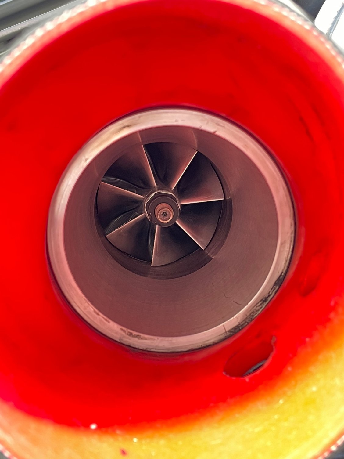

Do my stock turbos look normal after 41k miles?
Right
Left
anyone know why theres notches on the center piece? Just wondering if its something to be concerned about.

*****Well, there's no vanes or blades missing so that's a plus! The housing does not seem scored from excessive shaft end play, or a worn journal bearing. You can always measure shaft endplay and other typical field checks with a dial indicator if you like. Here is a pic of a non-stock turbo, newly built and not installed yet, for our cars.. (C63s). The notches may be for a special proprietary tool to be able to remove the shaft end bolt for disassembling the turbo for rebuilding, or a stake to prevent the bolt from loosening at 40k rpm when those vanes are spitting out 17psi or more of boost, etc.. Really bad things happen when a turbo shaft lets loose or those vanes touch the housing at a very very high rpm, far above the engine RPM.

I agree, the look fine visually. The little notches from the nuts may be from metal removed during the high speed balancing process. It you look at aftermarket turbos or modded factory stock frame turbos, you’ll often see part of the nut ground off for balancing.

They look spotless man, the housing isnt scorned at all either.
You a bit concerned about them?

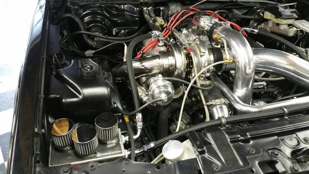

*****I have catch cans on other platforms. They work well for certain applications and can keep things like the intercooler and other associated hardware from getting oil mist all over the inside which can somewhat reduce their efficiency - but again, different car and different engineering with ONE monster turbo running stupid high boost in basically a race car... The catch can has to be emptied every few hours of running, especially at the track. Normal city driving is fine... Pic below. Vented multiple catch cans, etc.. Stage II GN, about 800hp, methanol injected.
That being said, my C63s has low miles, stock turbos, and the inside of the housing areas look spotless. Perhaps higher mileage cars or ones with turbos weeping a bit of oil past the seals might benefit, but our cars seem like a pretty clean setup.

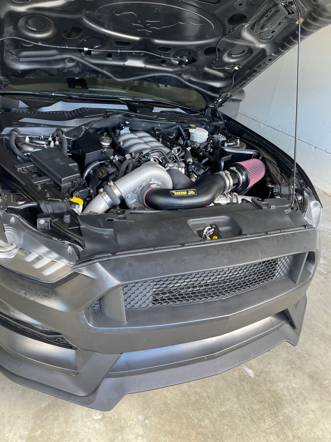

oil comes from the crankcase when it is pressurized under boost. On other platforms one side is usually low pressure and the other side is high pressure requiring a catch can. What’s ****ty is it’s all epa and emissions related trying to recirculate gasses. Adding boost to an engine usually pressurizes both sides and causes oil back pressure and seepage which can cause misfires when fed to turbos or through intakes. There’s usually a one way egr valve to prevent this but adding boost changes things. I’m not positive how the M177 behaves as it comes with twin turbos from the box. I did boost a 5.0 coyote engine and it required catch cans. I had to empty them every 1-2k miles and they would have a few tablespoons of oil. On this engine I don’t have misfires and do not notice a significant amount of oil in the intakes 🤷‍♂️. Probably a good insurance policy but not necessary.
pics of coyote engine, 800+whp. Catch cans on both right and left sides of the engine one recirculated back into the intake. NA required only one on the passenger side.
