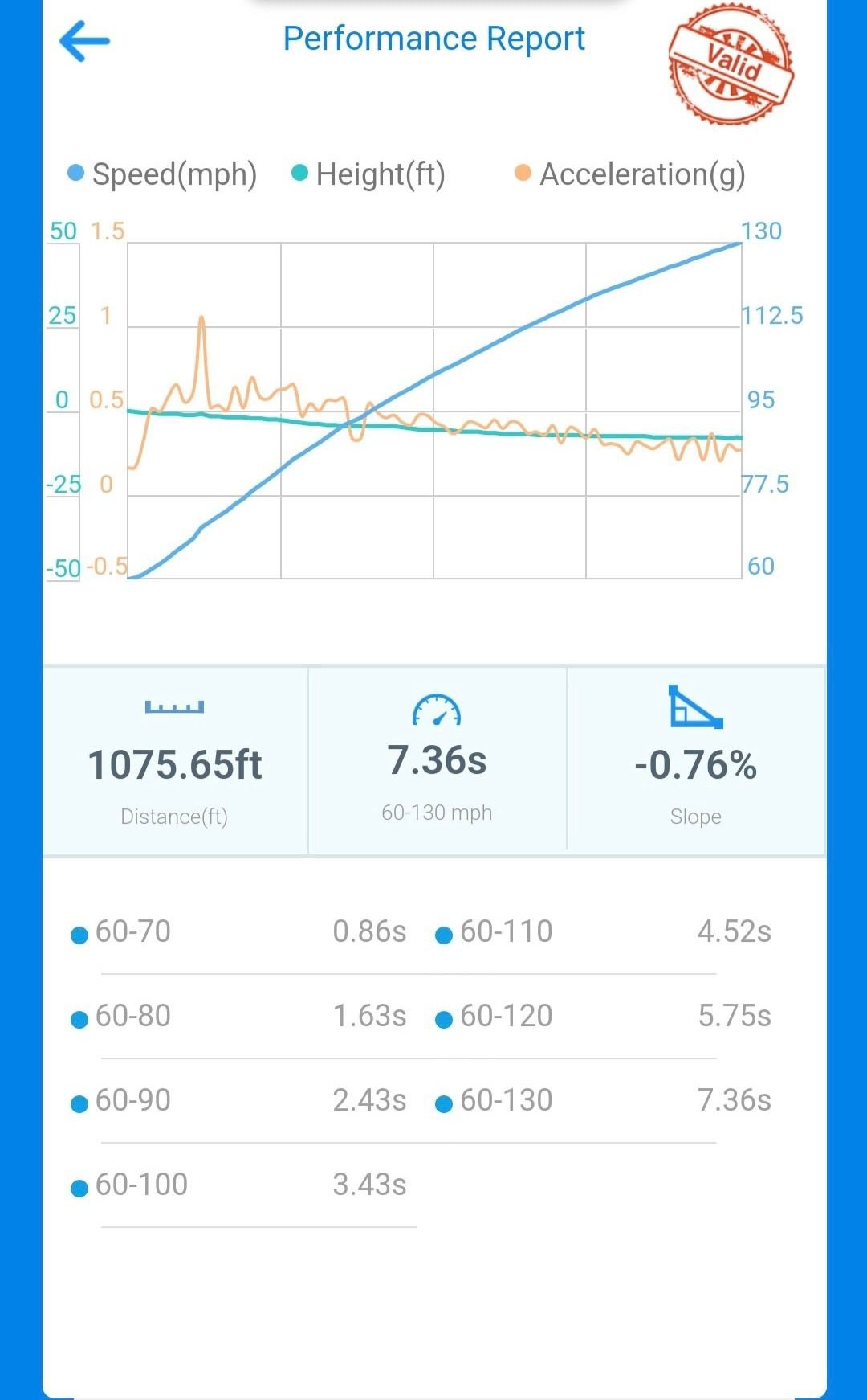

C63 amg edition 1
60-130 times
I’m stage 2 stock turbo with upgraded intakes, catless downpipes, tuned on 101 octane race fuel.
60-130 7.3 to 7.5 on average. Thought I’d be faster given I’ve beaten dodge demons and m5/m8 from a roll. Maybe it’s the area / DA? What are your guys experiences

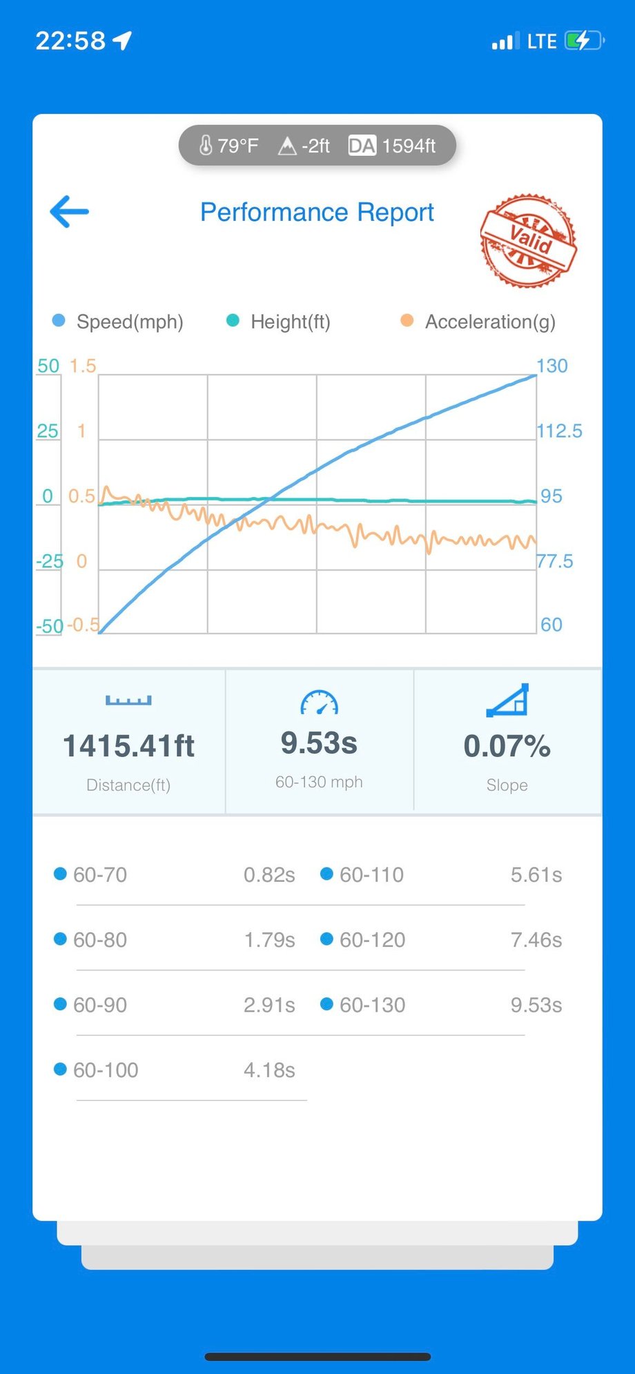

stock turbos, stage 2, catless downpipes, zac intakes
lately I’ve been running 8.8-9.5’s, something is wrong with my car, I’ll figure it out when I come back from outta town

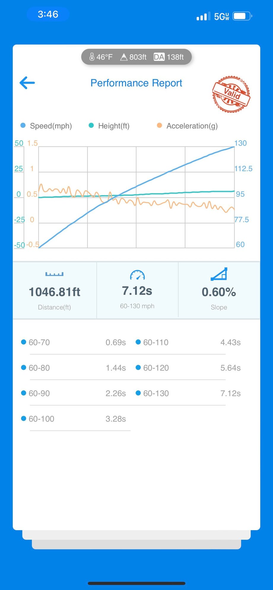

Adding modalworks intakes next week but below is my best on the setup in my signature (basically stage 3 on 93 pump)

Thanks, although mine should be faster on my current setup. PTG1000s, catless DPs, high flow filters on a 93 tune. 2nd gear start, 45mph, T/C off, 295 PS4S rears
Even with stock intakes, I would think I’d be high 6.x; will have to see what MW intakes do and then get some data logging done. Feels like something is missing in 4th gear.

Here's 2 of my 60-130 runs:
https://datazap.me/u/travyc63s/apr-2...11-13-14-23-26

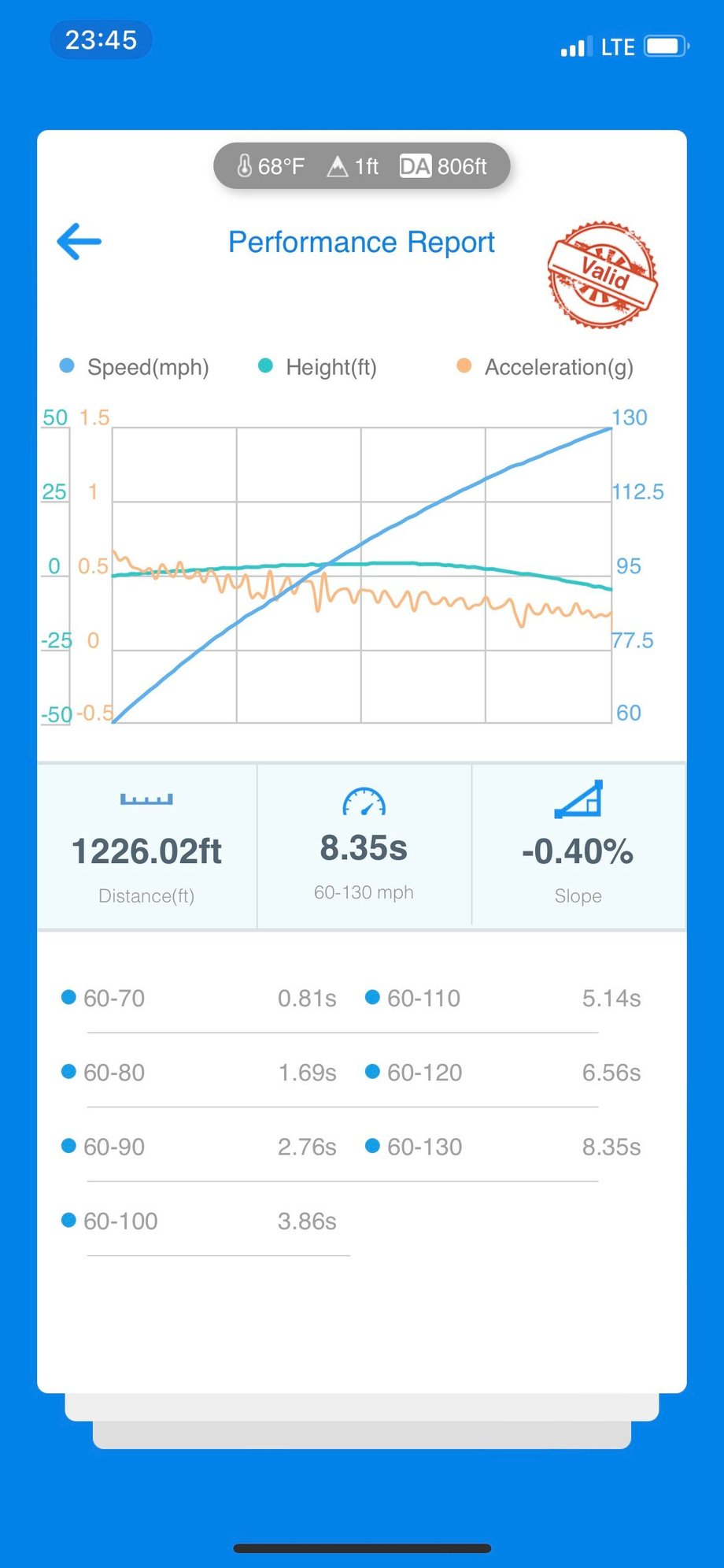

So I just installed modalworks intakes this week and tried a couple of 60-130 runs. Keep in mind, it is ~100* in North Carolina right now, so I would not be surprised if the car is pulling quite a bit of power (the butt dyno is telling me that too).
I was only able to run an 8.3x which is over a second slower than the previous run I posted. Now, that previous run it was 46* (so not like-for-like) but I couldn't imagine the car would be that much slower - especially with upgraded intakes.
I also installed the CSF 3 piece cooling radiator kit since the 7.1x run, so I think that would help too. I'm seeing 215-220 engine temps and 195-200 transmission temps. Maybe my coolant levels are low? Anyone running water wetter in their cooling system?

Apparently Verstand Tuning Suite via PTG can do some type of data logging, but it's not 100% clear.
When I am WOT and go 3 -> 4, the RPMs quickly go from 4.5k to 5k but then drop back to 4-4.5k and then starts pulling. SEEMS like there is some type of hesitation. Fairly confident it's NOT wheelspin, and don't think it's the clutch slipping.
To your point, need to do some data logging. Appreciate the offer! Will let you know how it goes.

same here, it’s puzzling TF outta me
I’m almost 1.5 seconds slower
so frustrating as theres like 20 things in the engine that it could be
