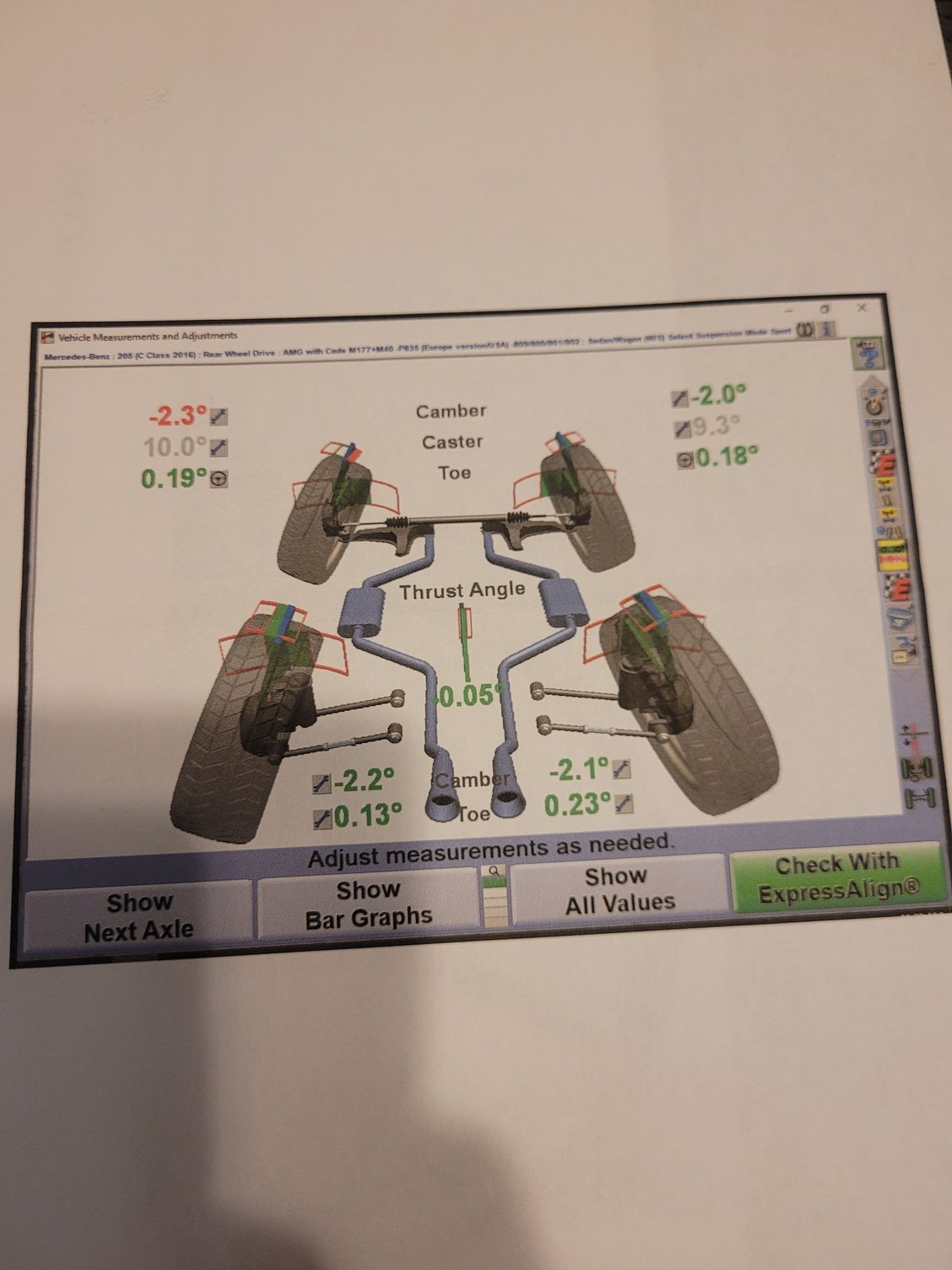

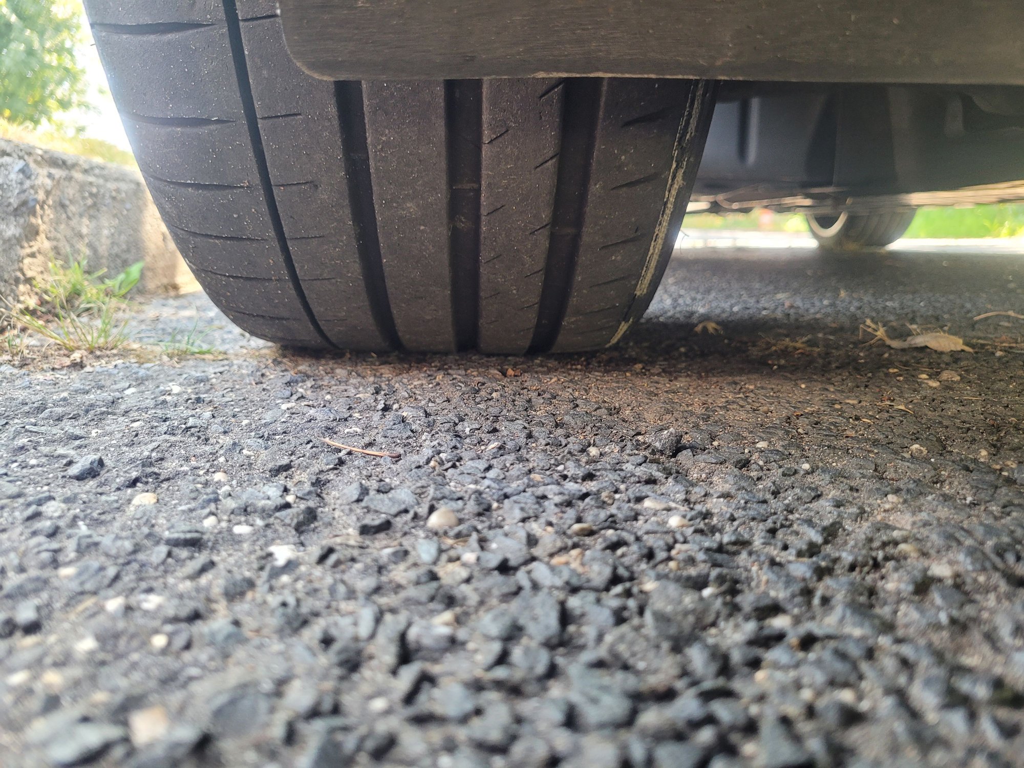

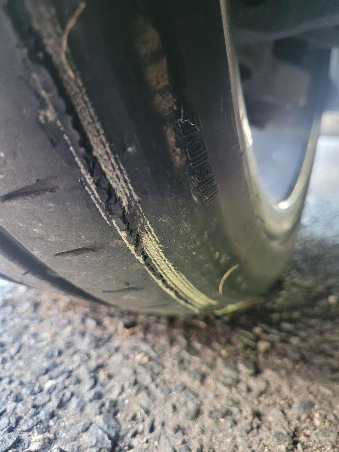

Just be careful that your setup is at a good spec and that you aren't dragging the inside of your tires after getting your alignment. I had an alignment at the beginning on this summer and have put 2000 miles on the car since, and while changing front brakes yesterday I found my passenger side tire looking like this.
After 2000 miles use. Was fine pre installation
Pre alignment measurement
Post alignment measurement
Needless to say that is not normal, especially when "properly" set up. I don't know if I should annoy the shop to replace this, I'll probably ask and see what they say. My next question is, will the new tire I had installed on the driver side (only replaced 1 due to a bubble) suffer the same fate in another 1000 miles or so? I sure hope not at $350 a pop for 245 width ps4s. Anyway, toe-out (or negative toe) is to my understanding what usually wears the inside edge of a tire. That in conjuction with our cars negative camber would accelerate it even more, but my toe is measured as toe-in, which should not cause inside edge wear...does anyone who knows a bit more think this wear could be caused solely by the negative camber? I have a hard time thinking this is only camber related as the wear is concentrated SO far on the inside edge. I can only assume I'm dragging somewhere...maybe their machine is out of spec, 2 days in the same weak they measured the alignment and I got 2 somewhat different measurement each time. Either the machine is off or my suspension has some play in it. Anyway my car is on desk duty until I get that changed.
Back to the point of this thread, as I replaced the fronts one at a time I am using 245s up front, next summer I will need new rears and will.probably go 275, so we will see how that setup works out. More than likely I won't notice a difference, but I'll try to remember to post back on this thread.

One more photo showing there's plenty of tire left everywhere but the extreme edge

I would be wary about specifying negative camber like that on a high performance car like ours without a template or proven precedent. Most of the handling we deal with in our cars at road speeds is about response and feel, not ultimate lap times or grip..this can be upset easily.
I am not saying manufacture specs are the best always, far from it, but with suspension and tyres, you need a good tuner to have done the research for you otherwise risk is making things worse.
in particular I don’t think wider fronts do anything except decrease feel and increase undesteer and negative camber can upset road handling character. These are not race cars, we have big heavy cars

Some tires are not designed for this much camber. It is my guess- There is too much toe in on that wheel. 2 Mercedes dealerships and 1 independent shop could not perform a proper alignment. I went to the 3rd Mercedes dealership in my area and they actually knew how to do an alignment on C63. Had mechanics and salesman with C63 & E63 working there, Mercedes enthusiasts at a Mercedes dealership- Go figure. It took them half a day loosening and torquing bolts to get the car alignment perfect- Which they did. There is very little play in the suspension- You can get adjustable camber arms, bushings and bolts. Adding wheel spacer also reduces the camber angle.
When the dealership doesn’t perform the alignment correctly and you burn through tires you just go back and buy more tires from them.
