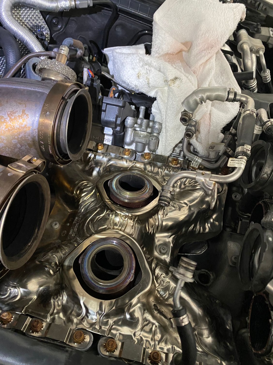

*****A decent tune can certainly help our cars for sure. Unless you are running race gas or have other supporting modifications like methanol, downpipes, etc.. , the capitalized "TUNE IS INSANE!!!" for folks already used to their cars already fast performance is probably not going to happen. Passengers used to more pedestrian cars are generally impressed by riding in a nice C63s or other such car, tuned or not. It's a fast car from the factory.
Renntech is a great company that makes really nice products, but they are selling tunes for the mass market and thus have to err on the side of safety to mitigate the chances of someone with a poorly maintained car or a car with problems in general doesn't just break outright. I've seen several owners of cars of various brands including ours try and make a car that is not running well better by buying a tune or whatever, versus first making sure their car is running well. They have X money to spend, and it isn't as glamorous I guess to maximize what they already have versus just bolting on an aircleaner or buying a tune, etc..
Plenty of people are ecstatic with their new tune of course, when they buy it and install it, but few people do before and after Dragy or dyno numbers to assess if the tune did what it was supposed to do. They assume it does what it purports to do because it cost $2k or whatever but they don't test to verify. Having actually tested several cars on a dyno I can state with some conviction that most people's butt dyno sucks, mine included, and I do most of my own work on the cars and have access to a dyno, etc..
I have been surprised myself after upgrading various parts on my cars with the latest and greatest and "feeling" like the car is super duper powerful now, to find that the car lost HP and torque, and is now slower because of a bad coilpack, or a purge valve is sticking, or a wastegate diaphragm is torn and leaking, or because the boost and AFR tables were off on the tune and causing massive timing retardation and wastegate boost bleedoff, etc.. At the 500hp level, losing 50hp or gaining 50hp is just not that noticeable in my experience. At the 750hp level, even less so - the car is still stupid fast at 750hp or 700hp.
Most people just want to buy their tune, install it, and be done with it. If your car has seemingly minor running issues before the tune, you'd be surprised at how much a "minor" issue will suck most of that 75-100+ (or whatever is advertised..) hp gain you are purportedly supposed to get with just a tune, just from pulling timing from a leaky injector, or air in the cooling system, a bad plug or coilpack, etc..
If it can be broken, it can be fixed or tuned I always say. Unfortunately, most people may not have the scan tools or data/other tools to verify their butt dyno's exuberance after dropping $2k+ on a tune for their cars, before another $1k for a TCU tune once the original tune didn't quite do what it was supposed to do so of course just buy more performance parts to make up for a cavitation issue in an intercooler that a decent mechanic or tuner seeing the actual car could spot with a few simple tests and some experience with these cars, or any cars..
Pic below of a C63s missing one or two things...Admittedly, pretty big things...
