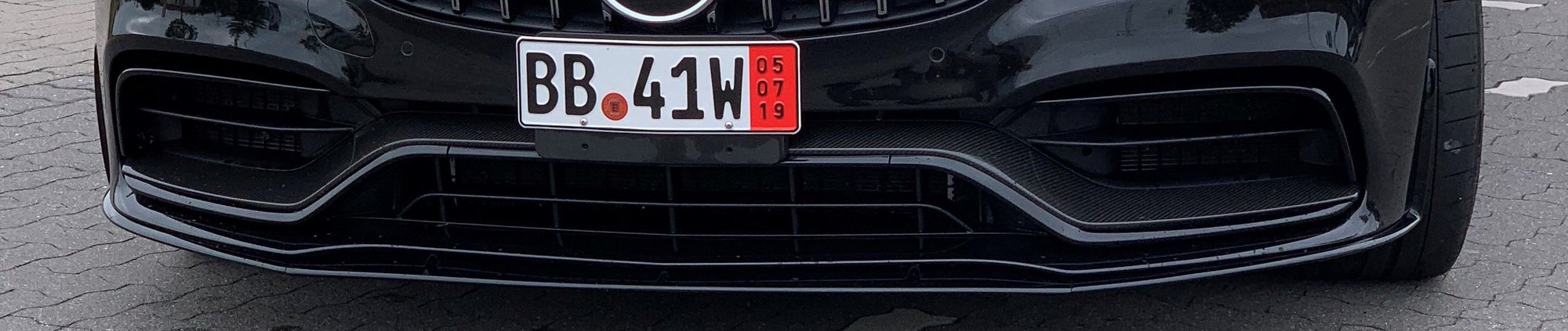

The issue is with all three radiators in the front. Left, center and right. They are all exposed. Just luck of the draw which one gets hit. Below you can kinda see the black mesh over them on my FL. You have to protect all three.
